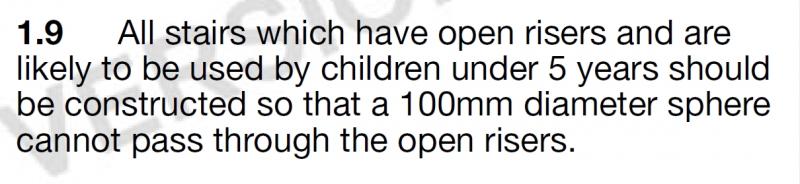

Hi can i remove my stair risers to create an open stair or do i have to buy a new staircase..
Many thanks
heeelllooo and welcome psycho49 :D :D :D
you need to buy a new staircase as half the strength off the treads is the support given by the risers
your treads will sound like a haunted house with all the creaking and groaning :rolleyes:

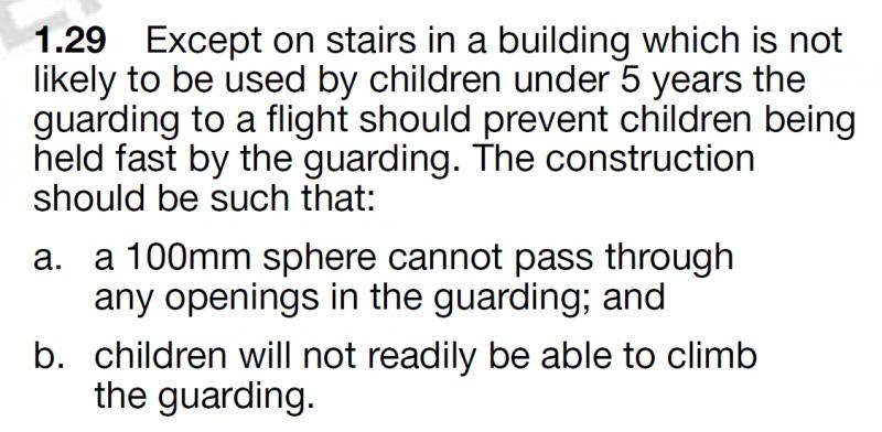

also to comply with building regs no gap bigger than 99mm is permitted on any part off the stairs and banisters

that is rubbish... you are talking about a fire exit... a common staircase in a dwelling has none of those regulations...

Oh geraint, I really don't know how you get some things so terribly wrong?

so please explain... i am waiting

and if not likely... they are guidelines... not rules
can you show me a regulation that states your arguement...
guess i will have to wait a long time...
State what, can you not read?
I've directed you to the items in the regulations and even given you the page numbers. Once you have read the highlighted (copies of the photies posted purely for you my petal) please come back and explain exactly which words in the regulations you do not understand and I shall attempt to help you. ;)
