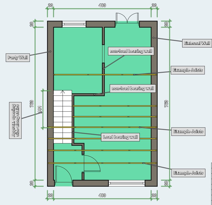

Hi guys,
I am looking at removing the staircase (moving location) from my house and fill in the hole in the first floor. The stairs are bounded by a party wall and an internal wall. Obviously I need a structural engineer to do things properly, but in scoping the task I would like to know what my options will potentially be.
There are essentially no internal load bearing walls in the property, the 1st floor joists run from party wall to external wall, except where the opening is created for the existing staircase, where the joists that are interrupted are resting on this one internal wall.
If I remove the stairs and the wall, will I need a beam running in the location of the current wall (parallel and only 1m from the party wall)? Is there an option to somehow extend the joists in to the party wall so that there is no interruption to the ceiling level? Or install a header along the party wall and extend the joists to this? Or is there another option that I have not considered?
Thanks in advance for any advice.

Because I am currently at the opening stages of discussing plans with an architect on a fortnightly basis, and I would like to know my options re having the stairs removed and what solutions there are to supporting the joists if that wall is removed. Currently all plans have been to keep the wall and work it as storage space, I was just hoping for some advice on what might be possible if it comes out so I can go back to the architect with some suggested floor plans.
Just my 2d. worth - consider replacing the floating joists with engineered joists made to the same height as the existing - right across from party wall to outside wall onto joist hangers. Avoiding using new wood that will shrink across the grain. I'm not sure if sistering joists to the floating ones would be acceptable. 2 possibilities there to take to the designers/ architect.

Get new joists put in?
I linked up a couple of floor joists with some steel strips with holes pre-drilled - floor still hasn't collapsed.
Could you just overlap the joists a bit. Loads of big screws or nails ...
That's great, thanks for your useful input. So it should be acceptable to just replace with full length joists on to hangers embedded??/bolted?? to the walls?

In ours the new joists and old were drilled and clamped with bolts with a certain overlap.
The way it worked is the architect got a proposed design from the structural engineer, then asked for changes within the budget eg flush ceilings, which the SE then redesigned to suit.
The only thing that really came back to us to decide was whether we were happy to have a ceiling down stand on one of the beams, as that was less critical to the design and would be more difficult due to other beams and the upstairs joists. But that was just an either or choice, we didn't have to do any design.
