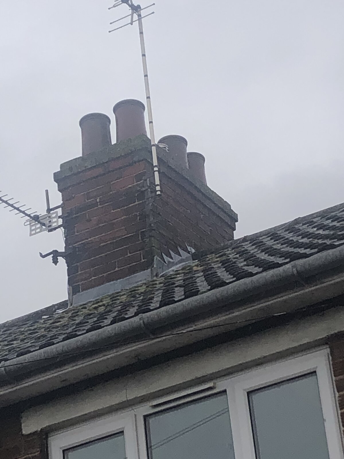

Jake,
If you post a pic of the front elevation including showing the roof at the eaves, things will become much clearer.
Posting the proposed joist section size and length will also help.
Similar to my post#6,
Some roofs have low projecting eave soffits, and some eaves have plastic Eaves Protectors in place so merely opening up the first three courses could simply lead you to butt up to obstacles.

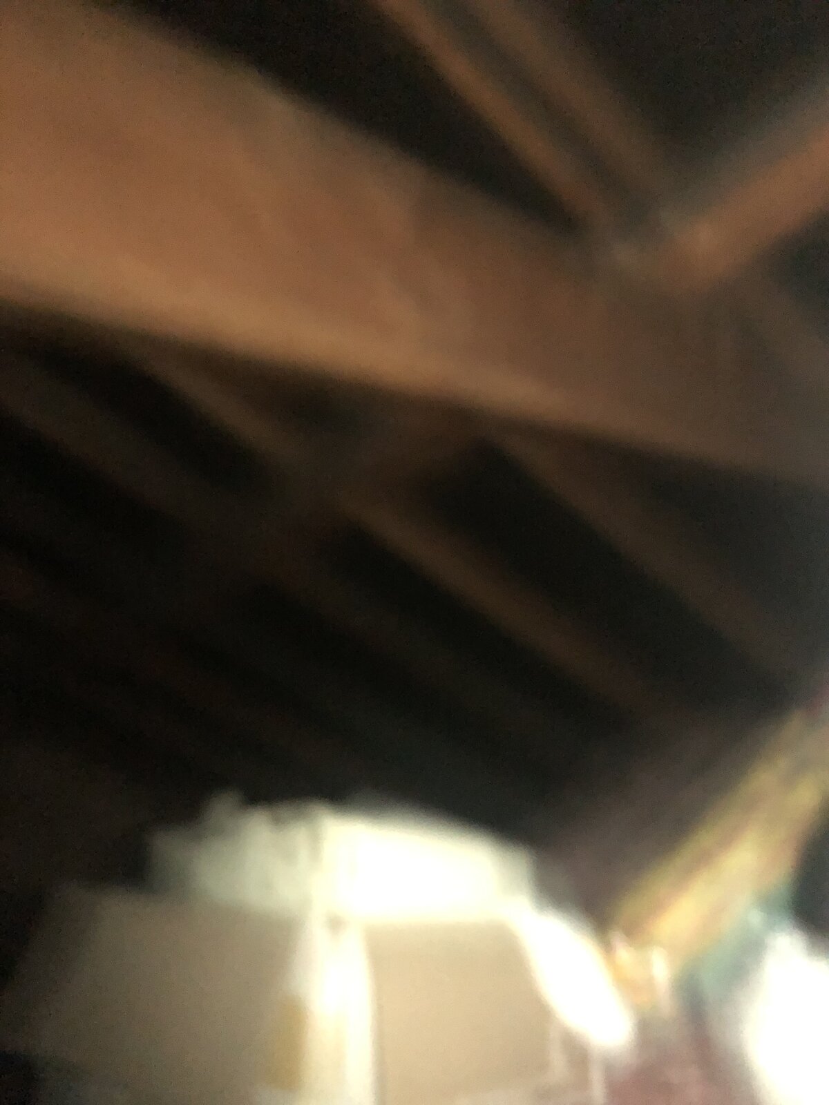

Hi ,
Maybe not the best pics but may give you a idea thanks Jake
Apart from the small soffit I cant tell all that much but why not just go at it - lift a tile about 4 x courses up, cut the felt, & see where you are?
Jake, Do not do what the above proposes - unless you like extra work and extra expense?
