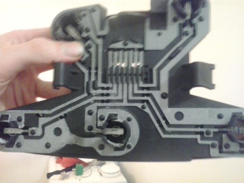

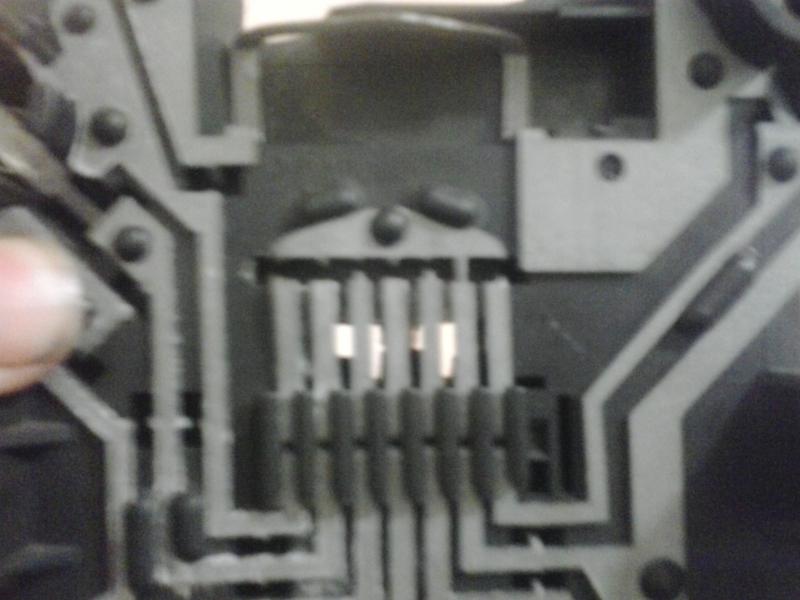

I then turned the ignition off completely and thought id clean all the other wires etc... and see if that helped i was looking at the rear bulb holder circuit board and it looks like some of the wires have been purposefully snapped and bent round i was looking at boards for the 1999+ models on ebay (as cant find any for my year) and they look the same like some parts of it are not connected and only has one wire going across completely... this is the same on both boards i had been fiddling about seeing what connects to what etc... just trying to get the lights & indicators to work properly but nothing was working at one point when id done a few things i turned the ignition to 2 tried the indicators and pushed the brake i then heard CLICK CLICK CLICK CLICK dash lights went off and i knew id blown some fuses.
