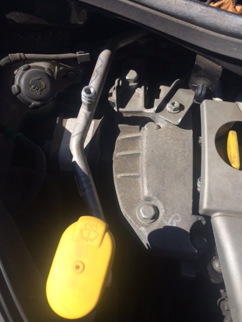

i hope someone can help me.
i have a 2006 renault scenic (7 seater) and the aircon is not getting any cold. iu guess it needs a refill.
i not sure of the low pressure point to attach the hose and do the refill. i found 1 connector by water coolant(silver in colour. is the low point as its not marked.
am yet to but the gas refil and hose but decided to find the low pressure point first.
can someone please point me in the right direction and anything i should look out for. never done this before so any advice welcome.
thank you
Are you using one of those DIY refill cans as sold by Halfords? They're not much good. Does your adaptor fit on the valve you've found? If it does then give it a go and see if it holds pressure
