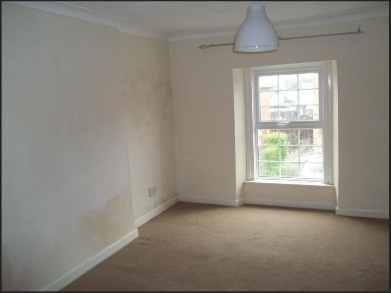

I'm also assuming all the damp inside would need to be sorted too. It doesn't look too bad in the pictures, no horrid black mould, just a bit of discolouration. We'll get a better look once we go for a viewing.
I've added a pic of the google street scene of the house in question. Looks like the work was being done when they went down that street! I've added a pic of the one of the interiors that looks to have damp. Also I've added a pic of one of the neighbouring houses. I'm probably coming across as a bit dim here, but is that sandstone? Is the house in question possibly made of the same stone? There seems to be a few houses around the neighbourhood with this same stone. What are the chances that after taking off the render it could look nice like that? Is it worth saving stone that has once been rendered? Or would it be cheaper to re-render?

I'm with steve on the fact the render doesn't look too bad. As for the roof there doesn't look like there is a fillet or coping up the verge and the slating is finished level with the wall which should be kicked over the edge to cover the top of the wall. And also you don't know what backing plaster they have put on the internal walls as in the photo of the "damp" inside, the damp on the chimney could be rising "damp" but the "damp" in the elcove is too high for rising damp,(it only rises to 1200mm usually) so it is either penertrating damp or condensation or it could be coming down from where the slates are flush with the wall. These are some of the options to look at but it might be worth getting a reputable builder or (dare I say it) a "good" surveyor to look at it.... ;)
Cheers Roy. It hadn't occued to me that it may be the roofing at fault. That's another thing I'll ask them about. The suggestion that the damp may be caused by the render is actually made by the estate agent in the description.
