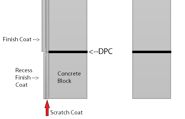

I have a question that might or might not be relevant
An existing garage/shed had a small extension added to the back
The original shed is rendered with a break at the DPC line where a 'step inwards' or 'recess' is formed. I would not call it a bell cast as it is more of a squared off finish rather than a curve.
The plan is to match the new render into the old render along each side and then render across the back of the new part of the building
1648062353790-png.68837
sketch above.
I am assuming that I would do the following
1.20mm corner beads on the back corners and around openings
2.10mm thick Scratch coat the full distance down to ground level.
3.10mm Stop bead at DPC level placed in front of scratch coat
4.10mm Finish coat down to stop bead
5.Should the finish coat below the DPC line then be only 5mm thereby creating the step?
Does it need a scud before any of this is done? Not sure if I have the room for another coat
In any event, how deep should a recess be under the DPC line
you could either rake out the dpc line of your scratch coat while its still wet or place two render stop beads back to back at the dpc.
is this a cavity wall?

Is the following an appropriate solution. You may see the fine white lines that indicate the stop beads back to back
Also the back wall is the wall that faces the vast majority of heavy rainfall. Would it be beneficial to have two scratch coats before the finish coat, or would loading with waterproofer be the best solution?

Another method is to Sit a a bell cast bead along the dpc so the water drips away, when you render underneath you can cut a line just under the bell cast bead to stop the water rising or you could sit a stop bead just under the bellcast , i have before just cut a line with an Ashlar tool to stop the render from bridging
That's the way we always did it Steve, and still do. A bellcast bead fitted along the dpc, then the plinth was either cement rendered, or left as a facing brick plinth.
Fitting the bellcast bead along the dpc line, leaves a good sloping inch or more " below" the dpc, plus it's a really neat, waterproof finish.

1.Would you be recommending scratch coat down to ground level behind a single coat the bellcast bead?
or
Would you recommend a two coat bellcast bead fixed directly to the substrate?
2.The finish I am aiming to match alongside is a a straight vertical render. Will the bellcast bead facilitate a straight finish? Does that depend on the depth to which I fix it?
Is it necessary to cut a line in the scratch coat also, or just on the finish coat?
Both methods are ok as Steve says, but the bellcast, due to its shape, will not give you a "straight" downward finish at the bottom.
