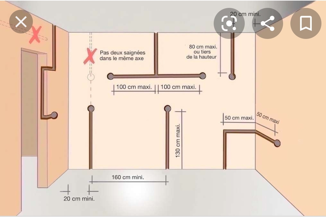

I wanted a bit of advice. We are buying a house built in 1978. The electrical report came back with some anomalies, which are fairly standard here. They are:
- there is no earth except in kitchens and bathrooms (not obligatory except on new build). You do however have to have sockets with only two holes. Most stuff you buy here has two pin plugs.
- the consumer unit is original on all the circuits with no earth and has no low voltage fuses. The other on the circuits with earth wires is modern and conforms to new regulations.
- certain equipotential bonds aren't the correct value (whatever that means).
For info, circuits here are often run in false ceilings then vertically to each plug/light switch (example attached). The house has false ceilings everywhere and the wires are in the walls in sheaths. The wires are in good condition.
We asked a couple of electricians to come and look at the work needed. And this is where I want your advice.
- two said the whole place needs rewiring. This involves taking down and renewing the false ceilings, cutting out the walls to access the wires. This leave an enormous amount of plastering and plaster boarding that we can't afford and seems excessive to me.
- one said that there is no need to rewire everything. We should update the consumer unit, pull an earth or new cable through the existing sheaths and just add additional plugs where we want them. He also said we could keep the ceilings and just access through holes created in them. So we have less damage. The walls are in excellent condition and there are ornate cornice etc that we would like to keep.
Does anyone have an idea if the second scenario is plausible? Or are we likely to find that it proves impossible and we end up doing the whole thing.
Thank you for any input. I have read so many conflicting arguments that I am very lost.
Gill

The problem with pulling an earth through is thats fine as long as its properly wired in gaine (plastic trunking) with no hidden breakout/junction boxes - but it probably isn't - and the mess beneath floors with 1970's French wiring will be ......... Because your old board is almost certainly only switched on live - it can take forever to work out neutrals as its almost certainly wired with single cables. The other drawback is the Diagnostique looks at modern normes - come selling time your electrics will still get a long list of "faults".

If you are buying an old French house you will probably need to get used to mess, cutting holes in plasterboard, etc....
Clearly the best solution (ignoring cost) is to have a complete rewire, with wiring buried in the plaster, and all before you move in;)
However, that's not realistic for many people and in my opinion the electrician who suggested replacing the CU and running earths or new cables as needed was right on target.
Modern French CU's are excellent, and if you have one of those put in ASAP (and tested) and maybe some updates to earthing, you will have a safe system which you can update or add to as needed.
French wiring is very different to UK -- buy a book about it. It'll help whether or not you decide to do any of the work yourself.
Obviously, don't take on anything you aren't confident about.
And top tip - specify a CU with lots of spare ways - you'll need them.
