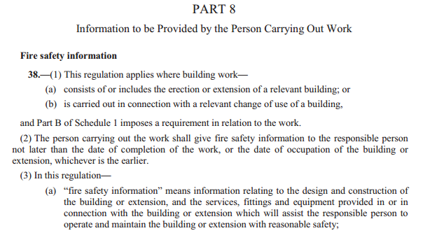

Hi,
I've just renovated my kitchen, last time it was renovated was in 2006ish by the previous owner, and the house is from 1972ish
Does it require a mains-powered fire alarm?
I have already plastered and painted the ceiling, and installed new cabinets, and rewired everything, and only now realised this could be a requirement.
The electrician that came to certify it is telling me it is. Is he right? Will I have to chase a wall and ceiling to accommodate it?
The renovation consisted of changing a door and window, relocating the sink and plumbing, relocating wires/sockets, knocking down a stud wall (now it's an open plan kitchen) and fitting new cabinets.
Before the renovation, there were just battery-operated fire alarms in the house.
AFAIK now, the regulation talks something about substantially altered dwellings requiring a mains-powered alarm, but does not define what falls into this category of alterations.
The house is in Leicester and I am not landlord
Thank you
The Building Regulations:
