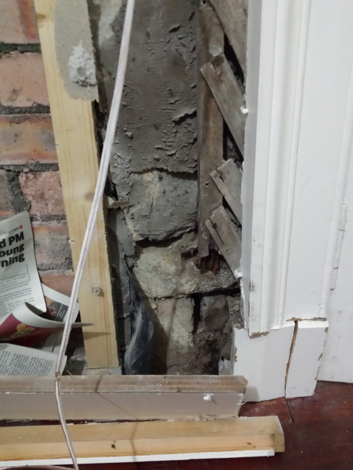

Hi,
Currently in the process of trying to reopen an old fireplace. House built sometime in the 1800's, and the gable wall in question is probably a sandstone/whinstone mix.
I've pulled the plaster back to full expose the fireplace and was about to start removing bricks tomorrow but thought it might be good to get some advice on whether its safe to proceed or if there is anything else I need to consider.

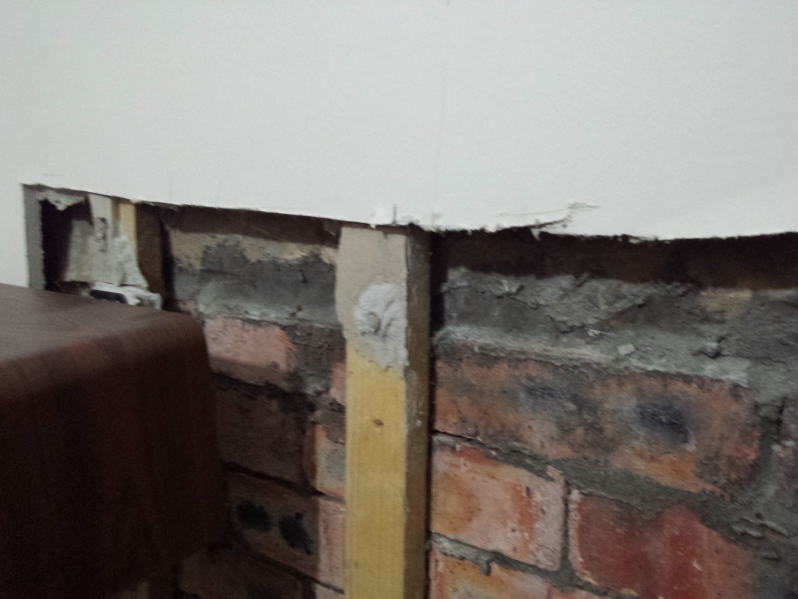

This looks like it might be the lintel. Its certainly a single piece of stone and stretches the full width of the fireplace.

A slight concern about the state of the wall here at the base on the right below. Think this has been caused by dampness. The chimney had been closed up without a vent, and I think there was some rainwater ingress too (chimney is going to be rebuilt soon).

Well, unless you've already started, I'd expose a bit more of the wall first, and see if there's a lintel above the bricks. You'll also be able to see what the upper part of the chimney breast is like, in the event of more extensive work being required.
Thanks Doggit, the lintel is the grey bit you can see in the first two pictures at the top just above the bricks and below the plaster line. Presumably sandstone but there was a lot of cement smeared on it from the top of the bricked up opening.
I did go ahead on Saturday afternoon, took the top bricks out first gradually until I could see that the lintel was whole from below, then worked down the left side as that wall seemed in better condition. Once I could get a good look in behind the bricks and could see it was looking ok, I had a smashing good time with the sledge hammer.

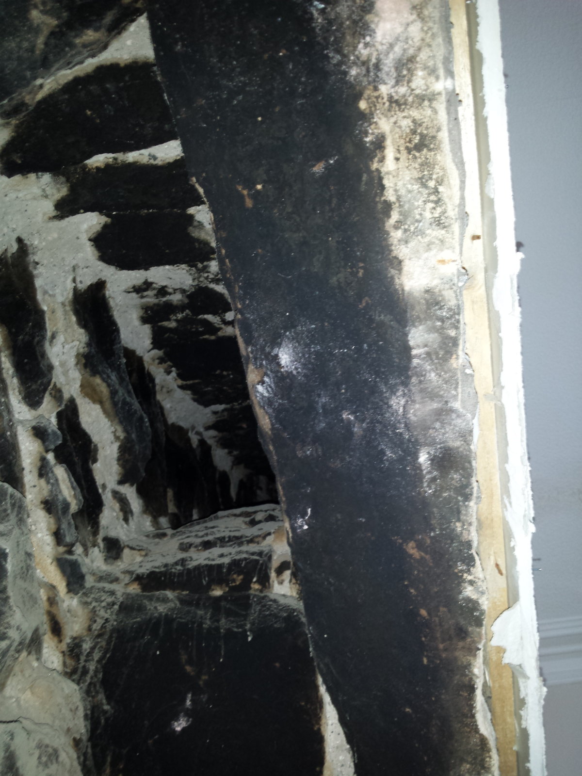

The lintel from below is quite a hefty piece of stone:

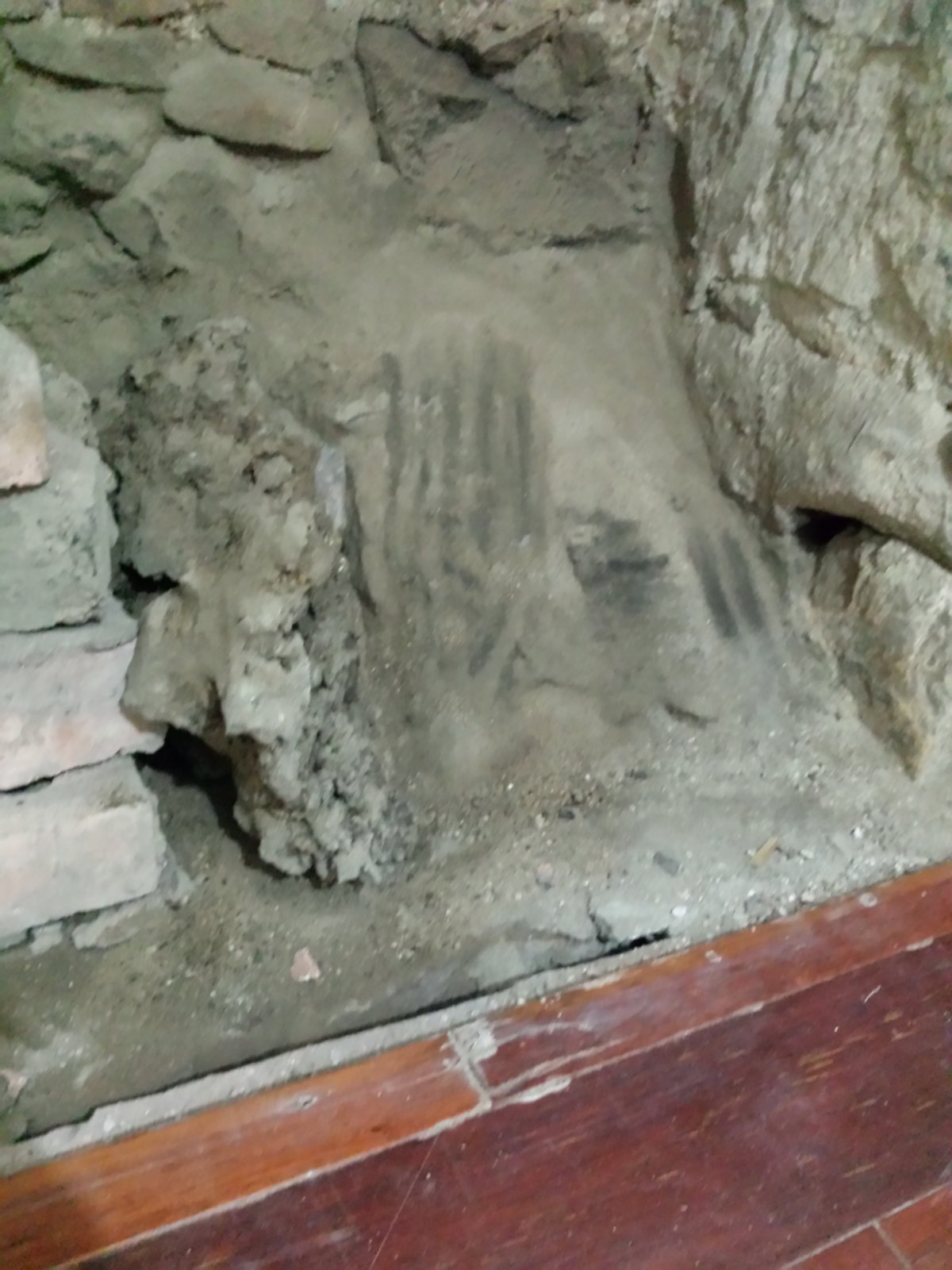

And the fireplace now fully open looks quite good I think. The question is what to do next. I think I will carefully chisel the cement off the sandstone and leave this exposed, with a wooden frame to edge off the plasterboard. Will have to get a hearth sorted obviously, as there is nothing there under the floorboards, will need to look into the requirements.

There appears to be a void under the stone on the right hand side, perhaps I will be able to just push some stone mixed with lime mortar into this. Think there has been a bit of erosion here with the chimney leaking for god knows how long before we bought the place, wood around here is rotten too..

One thing I haven't seen before is the sloping part pictured below. It has broken away to the left, but at the right is like there is a built in slope from the back wall to the front of the fireplace, can't think what the purpose of this would have been.

Well done. Not sure on the slope either, but cut it out, use the ballast for the hearth, put in some cement with a waterproofer in it (getting a dpm won't be easy) and then lay whatever hearth you want. Cut out any rotten wood, and treat the wood and surrounding brick area just to play safe.
