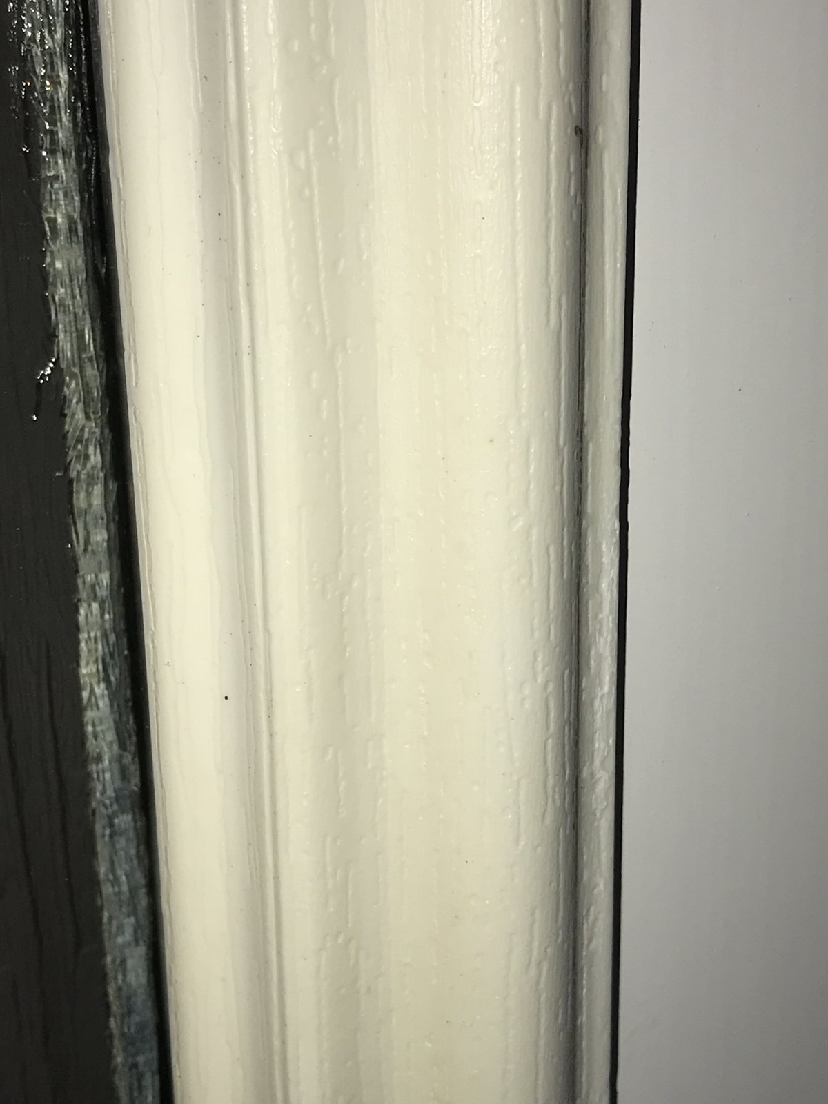

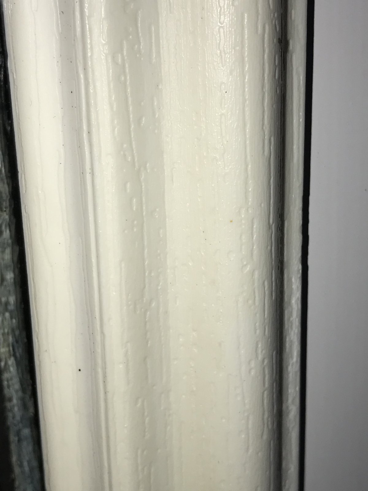

Experience really is everything! You’re right
On (even) closer inspection, at appears to be textured pvc, possible designed to look like wood almost?
E249F9AF-200B-4D7B-88B8-610ABFBEAE2C.jpeg 186CADFE-F982-4478-90C7-A17CE7A65D56.jpeg
The House came, as all new builds do, with a 2yr warranty. But that has expired now .
So, it’s specialist paint for that part then. Hmmmm
Thanks for double checking.
Yes, it definitely looks like uPVC.
If there is a maker's name on the door, it might be worthwhile talking to them. They are unlikely to want you to name and shame them on the web/Twitter/Facebook etc (not that I am maligning them and suggesting that they would not have bent over backwards to resolve things regardless).

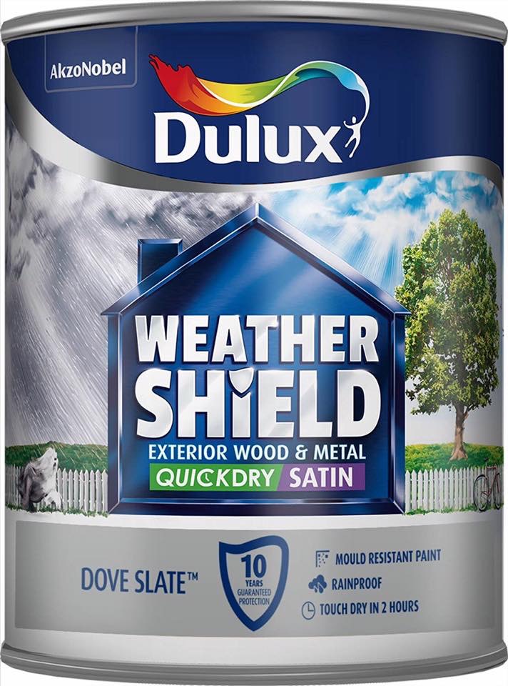

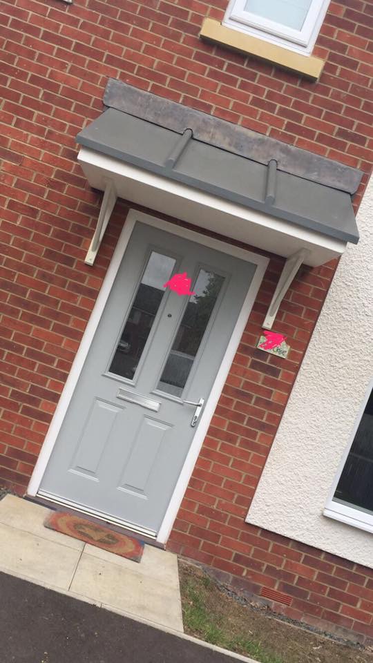

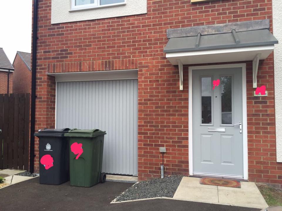

Just been speaking with a neighbour, and he has painted his light grey using dulux weathershield. He says it seems to have taken to the plastic ok. Guess there’s no way to tell but wait and see.
Looks nice though. Hmmmm

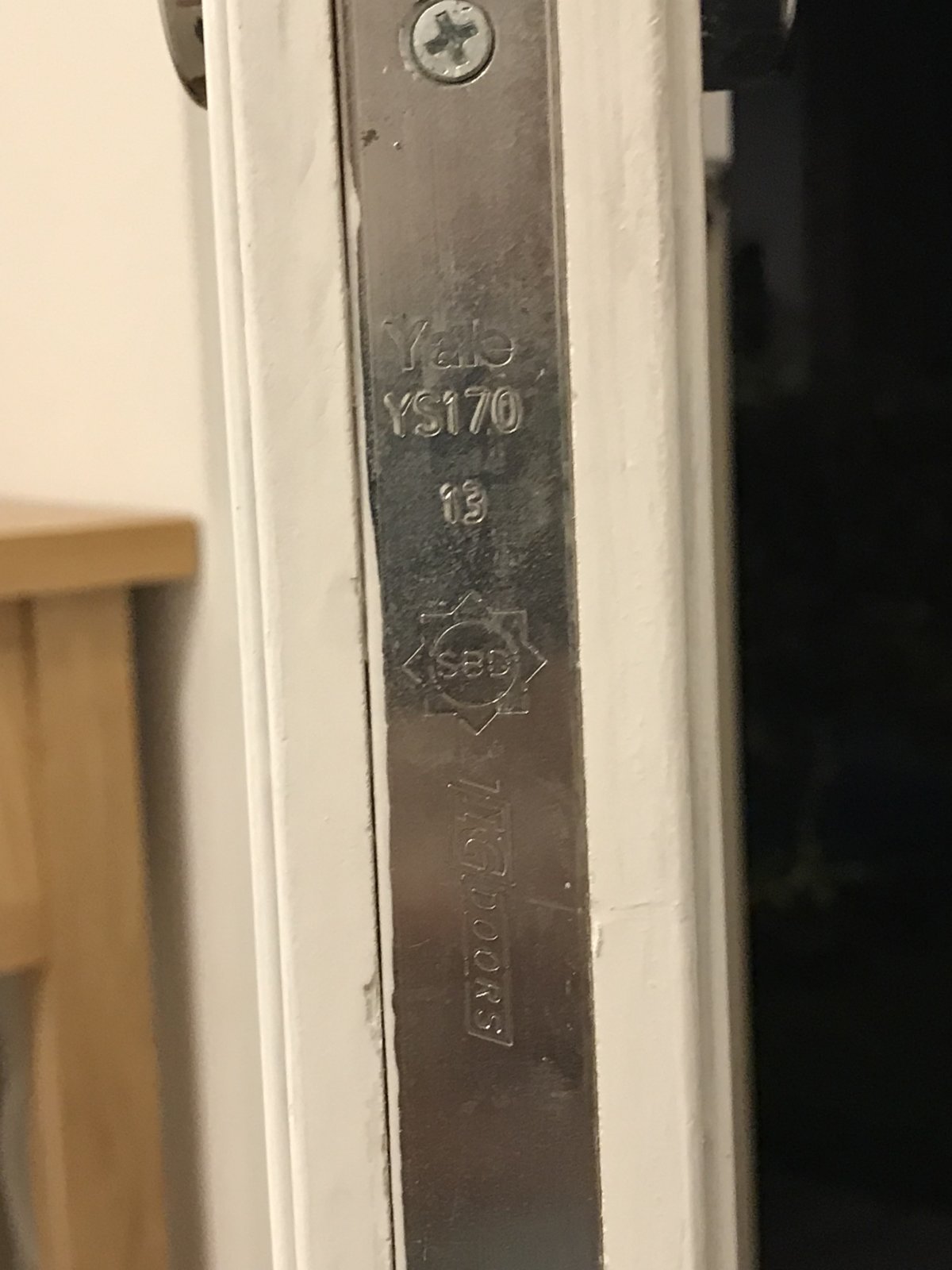

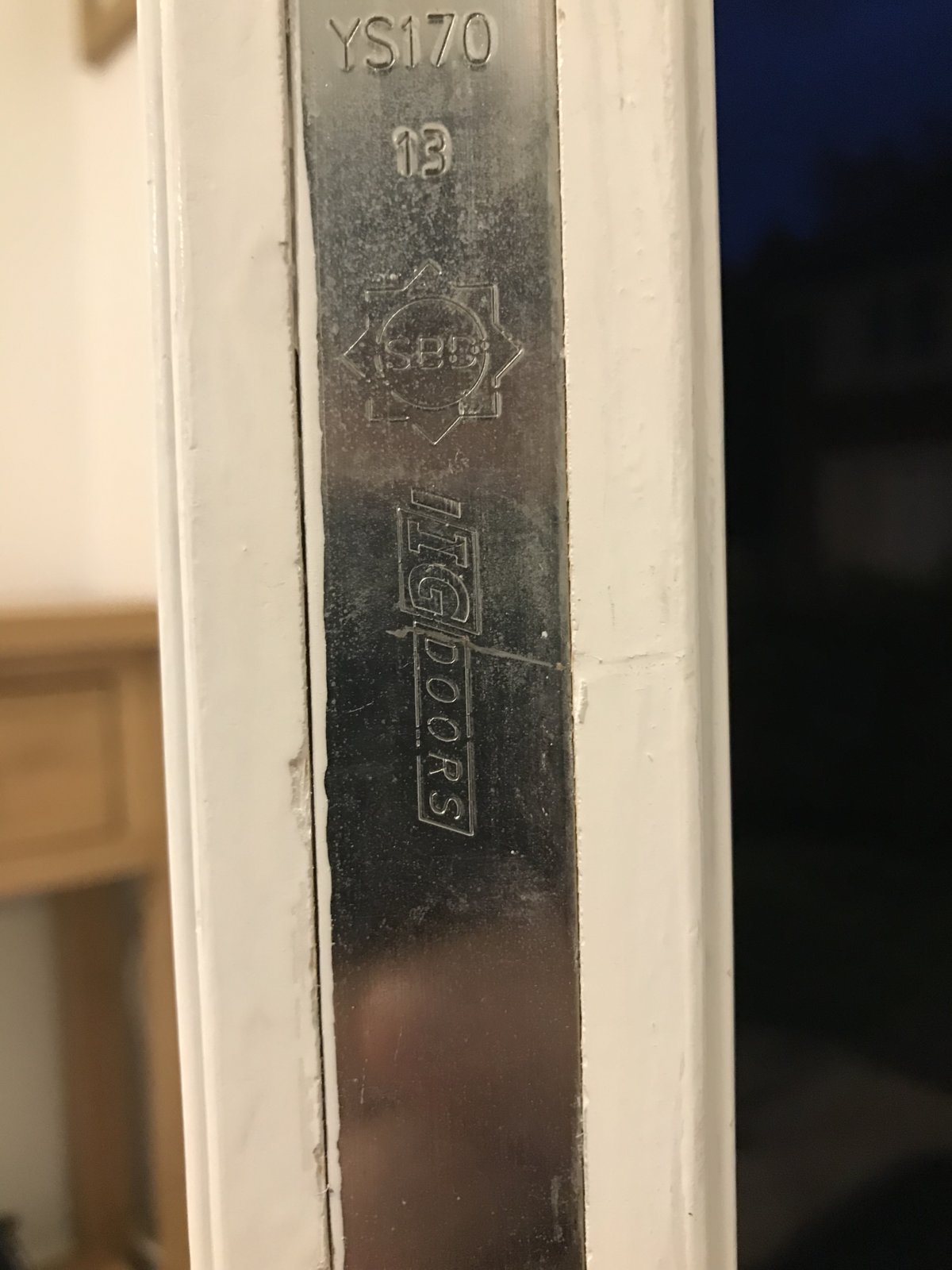

Oh, and this is the only name I can see anywhere on the door, but not sure if it’s just the multi lock system?

Composite door glazing is held in place by a "glazing cassette", like these...
https://www.ironmongerydirect.co.uk/browse/window-and-joinery-hardware/glazing-cassettes
...and they can be replaced. They're in two pieces (an exterior and interior 'frame') which screw together to sandwich the glazing panel thus holding it in place. You should be able to see small screw hole inserts around the frame inside the house. If you remove the inserts and the screws the inner frame will be loose and can simply be lifted off. I haven't gone any further on my IG Doors door, but the outer frame is somehow adhered to the door (for waterproofing?), and certainly on mine the outer frame complete with the glazing panel stayed in place with the inner removed. I assume if I'd pryed the outer frame it would have come unstuck somehow.
Your door is probably an IG Doors door too - I don't see a door manufacturer fitting a competitor's door lock mechanism into their doors. Perhaps try contacting IG Doors and enquiring about either their warranty/guarantee terms, or perhaps to buy replacement cassettes. (When I phoned them about replacement decorative glass for my door they wanted the original builder's name and the estate address.)
Alternatively... I painted my (yellowing) plastic cassette with a few coats of emulsion, starting with a light 'streaking' and working up to a full covering coat, then a couple of coats of water based gloss. It's still perfect about 3 years on. As a side note I also did the door the same way but some of it's paint is flaking a bit and needs a better solution.
