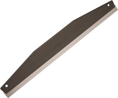

Also, any ideas on how to keep the paint off the floors? Other than masking tape of course. My grandad said he used to use a thing strip copper...

Other than masking tape, which can still allow paint to bleed, you could use a paint guard like the one pictured below. This can often be slid under the skirting, allowing you to paint a nice straight edge. As you move the guard along, wipe excess paint off so that you don't smear it on the floor.
Any spills/runs onto the floor should be wiped away immediately - with a plain old wet rag for water based paints or rag and white spirit for oil based. If you use B-I-N and spill any, you will need to use methylated spirits to remove it. Successful removal of the spill will depend on the floor finish, i.e. gloss varnish will be easier to wipe than satin or matt, but either can be cleaned successfully, if done immediately.
Thanks, ive don't think I can get anything uver the skirting. These is zero gapsince the floor had self leveling compound applied to it a few years back.
