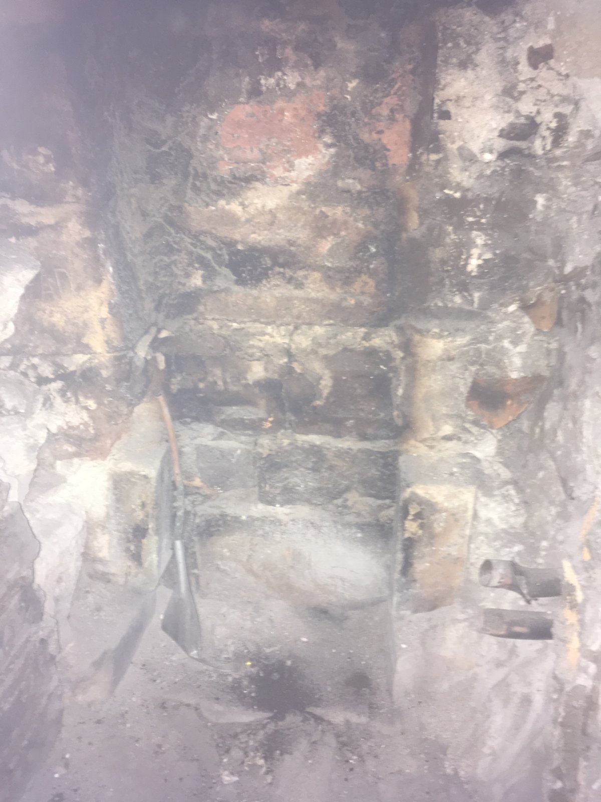

Hi, just looking for advice on repairing the fire brick. I am fitting a new gas fire that sits into the chimney (old one sat proud on the hearth) new fire sits as an insert, the front flush with wall.

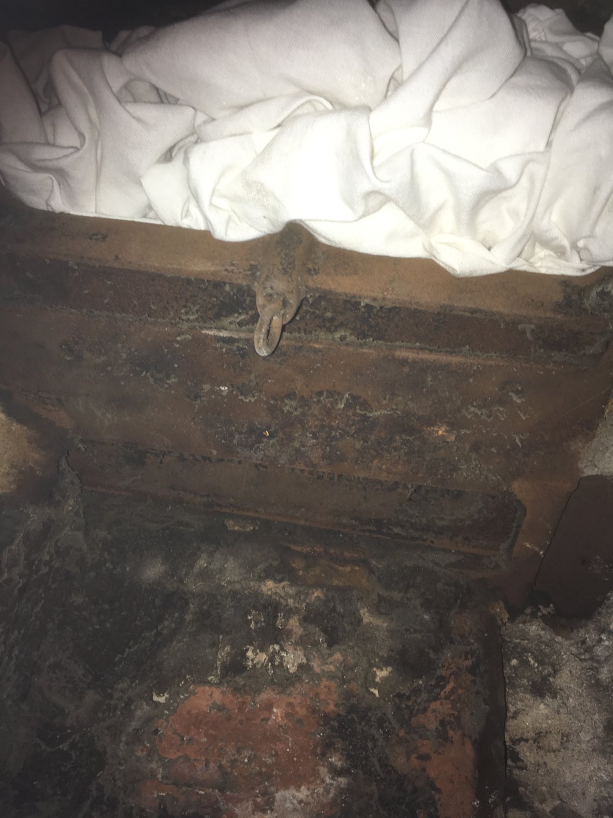

When removing the old fire we discovered old fireplace bricks crumbling. We removed a very old small tank too that the old water system ran through. The rag is stopping the draft coming in passed the metal plate.
Any advice appreciated. I did consider a small lintel just above the plate at the front leaving a gap for the vent. Then replace, fill and tidy the cheeks.
Hi, just to add, the previous owners had a wire mesh covered in cement forming a front cover or, facing, across the top 6” that was cracked and buckled (removed).
someone has removed part of the brick arch that was linteling above the opening.
the brickwork above can move so its best to have a lintel fitted at the correct height for your new gas fire instal dimensions.
the old metal parts inside the opening must be removed and the flue fully opened an then swept.
your new gas fire will probly need a SS flue liner but you should get a GasSafe HETAS on the job.
dont try an DIY the work, use the HETAS.
if the plaster on the face of the chimney breast is cracked or failin then hack it off back to brick and re-do.
do all the work in one go.
