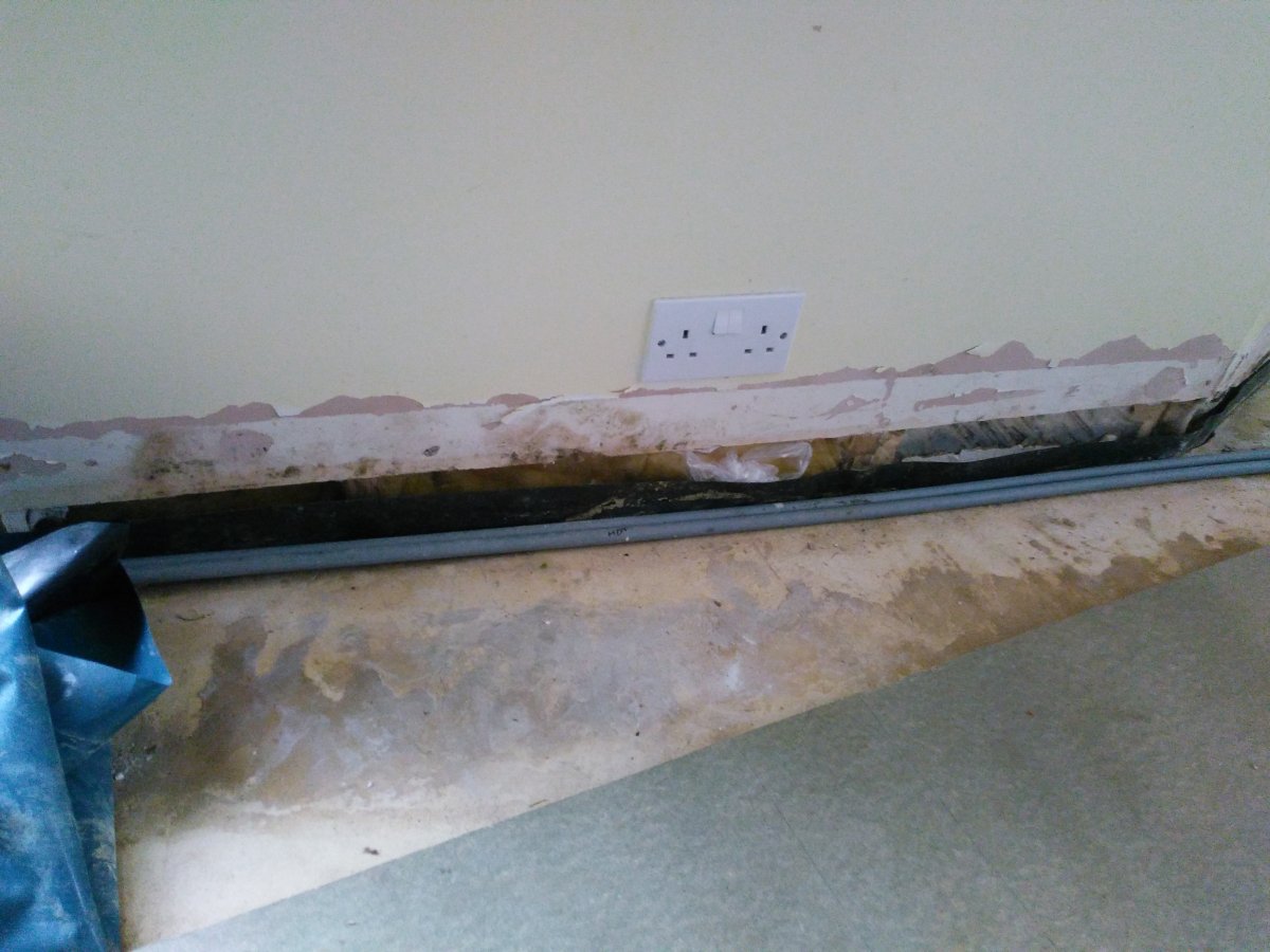

Thanks for the reply. Here are some pictures.
Gap i have cut in the plasterboard which was set into concrete slab. Is a continuous gap essential around the extension? It will be covered by the skirting. I feel some drafts coming through, any thoughts on sealing the gap prior to flooring?

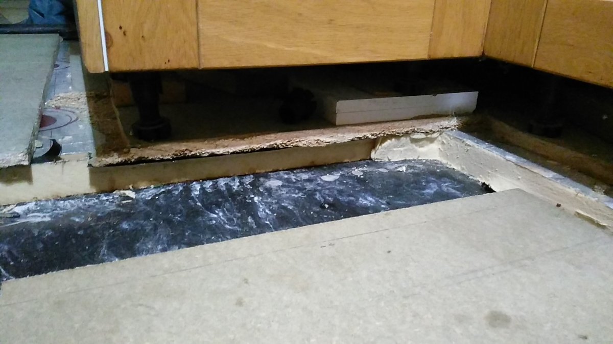

Insulation and chipboard under cabinets. Should this be removed to allow a continuous span of flooring across the extension or can I butt new floorng against it and fill any gaps. Removal would also allow me to cut the plasterboard gap, although it will still be difficult as it's under cabinets.

Neither plasterboard nor plaster should have contact with the slab. A 30mm to 50mm gap is adequate.

The sodden (& perhaps crumbling) chipboard under the cabinets can be removed and the engineered flooring can run just behind the plinths.
Doubtful that you could adequately cut and clean out the p/b behind the cabs, so just leave it.
Sand & cement can be used to fill any gaps.

Realistically the proper way would be to remove the cabinets so that you have an fully accessible floor. Leaving damp chipboard and insulation under the cabinets will likely result in moisture being held and future problems building up.
Any membranes should be left in position if they are undamaged.

I'm resolved to get the insulation and board out so no water is trapped as you suggest though. It will be a pain to get the new floor in with the cabinets in place though.

I'm being thick here but how are you planning to get the insulation and chipboard out and leave the base units in place?
Perseverance and a good deal of cursing.
A combination of removing the floor of the unit and or raising the units on either side to take the weight off the legs. This allows me to cut the chipboard joint and pull it out. Then I replace the legs on wood blocks.
