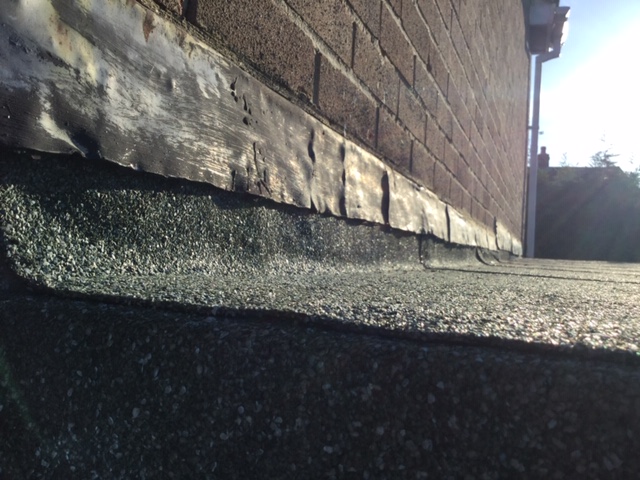

  • Most crucially the roof is leaking where the roof abuts the house

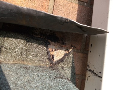

  • The roofer admitted that he cut the felt and repaired with flashing tape (see image IMG_2824.JPG)

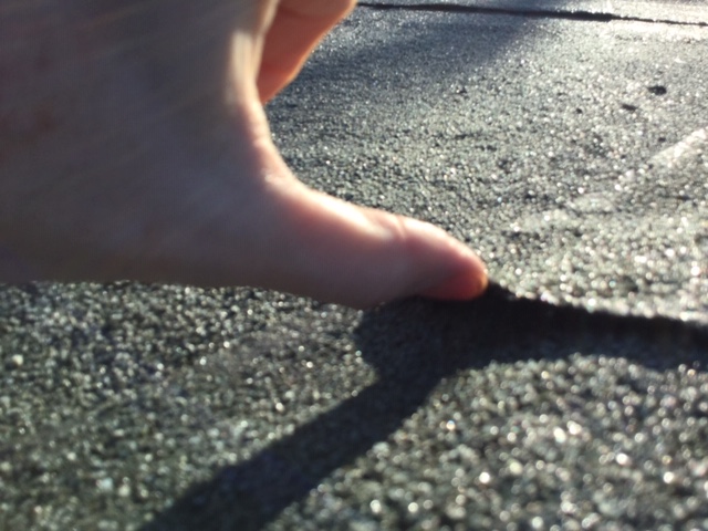

  • The felt is blowing in places
  • The felt at the front edge by the gutter is also lifting

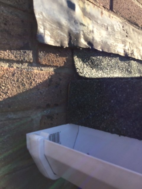

  • The weltered drip is wrong with nails visible

the drip edge into the gutter is wrong, and will possibly give water damage problems in a year or two?
the issue of the felt upstand under the protection of the lead flashing, even without angle fillets,
seems like a non-issue - unless the felt seams are wide open, and then all bets are off.
you could use a bitumen like Blackjack, only buy the cheaper stuff, to stick your upstand to the brickwork.

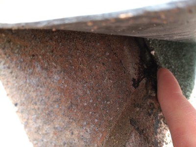

Have just looked under the leading to access what's been done as you can see the felt is lifting in places.

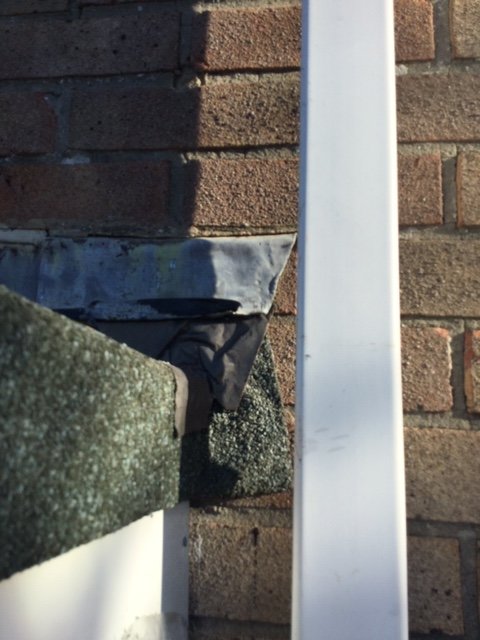

More concerned about obvious issue in the other picture:
Any advice?
