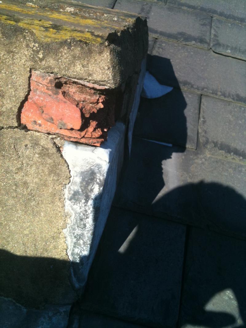

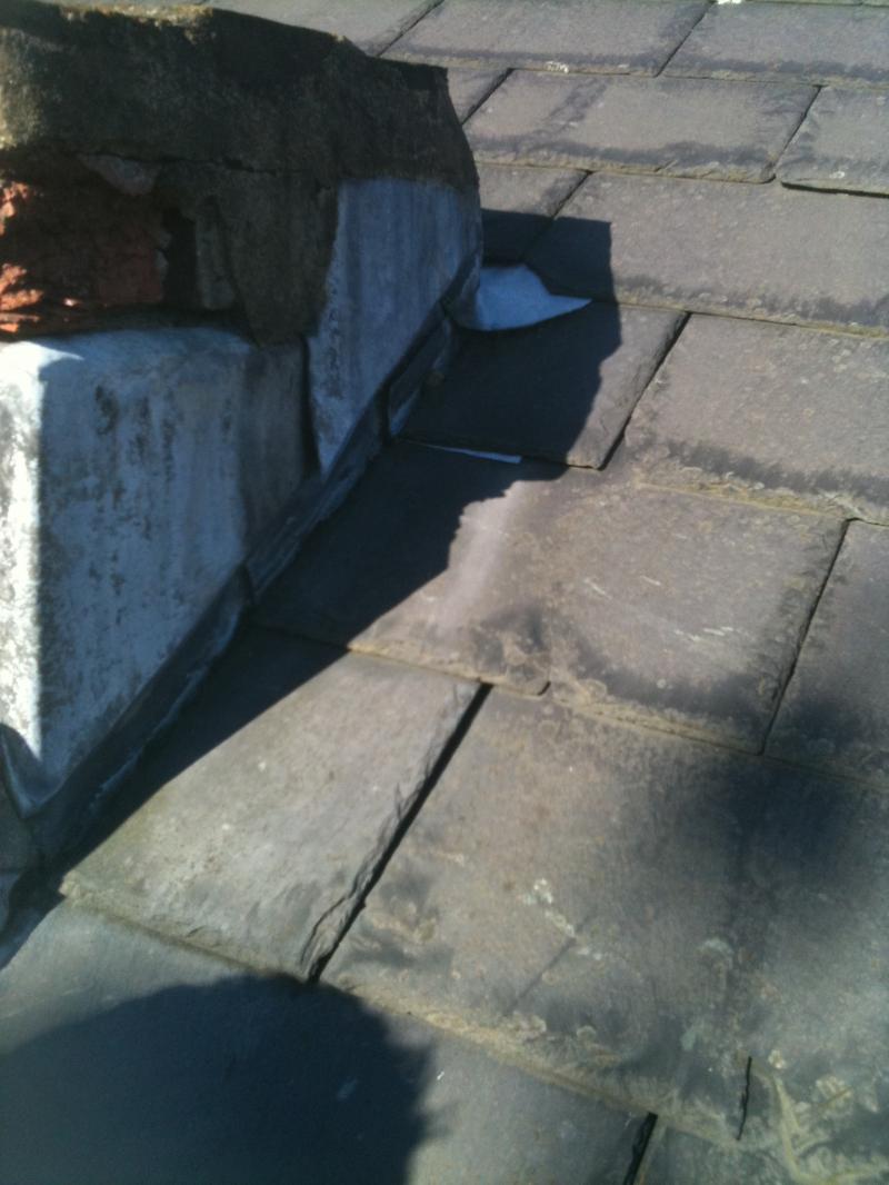

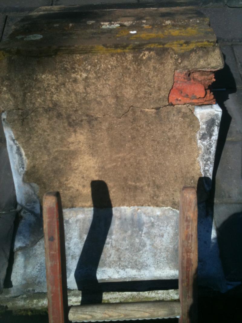

Hi,
I have an old chimney on the edge of the roof at the rear which has not been used for many years. (pics below, hopefully).
The breast in the kitchen was removed before we moved in 13 years ago and as we are now planning on re-doing the bathroom I am hoping to remove the rest of it in there and the capped stack which is crumbling and getting to be a danger!
Removing it myself is not a problem but my question is about the repair of the roof afterwards.
Would I have to strip back the width of the stack right up to the roof line and re-lay (or is it even a full roof re-lay? Either way I would have to get a roofer in for that), or is there another way - I don't much care how it would look as long as it is weatherproof until I can afford to have a new roof put on!
Thanks for any help :)
You only need to strip the roof a couple of courses or slates all the way round.
This is to allow you to replace any rafters missing, overlap the membrane and stagger the joints a bit on the laths.
Then you can replace/fill in with slates.
NB, your membrane/eaves support trays should overlap into the gutter. Ensure your higher membrane overlaps onto your lower membrane.
It'll also improve your footing while you're working.
strip 3 rows above chimney and 3 slates either side take chimney down below roof fit new spar and cut old laths back to half way over nearest spars either side fit new felt over chimney void lappin each side and underneath felt above fit new laths in line with old ones and fit slates in line with old ones once the roof is opened up it will become simple just copy whats already there hope this helps :)
The stack does not look that wide, and so once you reduce it to just below the top of the rafters, then you can just felt and lath it without any new trimmers or rafter sections
But your new felt will need to lap to the next rafter past the side of the stack so you will need to take off a section of slates to each side
I would not bother with an eaves tray for just this one bit if there is none on the rest of the roof. Just do it the same as existing until you get the rest of the roof done
