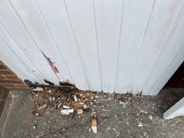

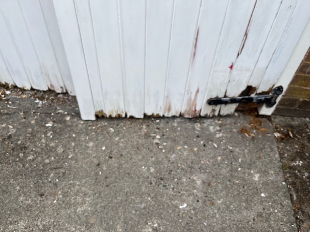

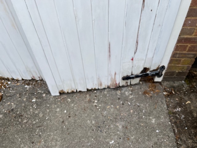

Hi
I started a simple garage door decoration but have issues.
The door frame is sound, match boards are rotting, pls see photos
I am considering the following options:
1. Replace 4 match boards T&Gs on each door, ones which are used to fix hinges on, decorate the rest and fix weather bar.
2. Remove all match boards and replace with one wood sheet timber, most economically plywood, prime and paint. This should last 5-10 years, I hope.
3. Abandon project, buy new garage door.
4. What do you suggest?

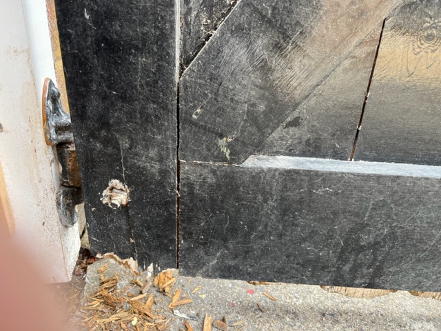

Door side of the hinge atm is fixed to door frame. There will be no door frame to fix the hinge to, hinge will be fixed to panels only. Photo below will make sense I hope ?

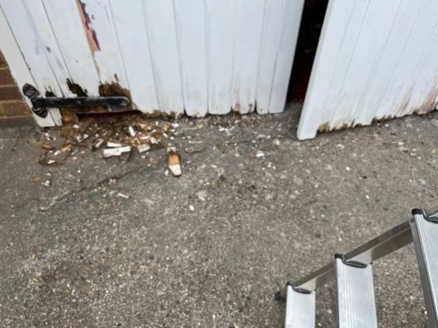

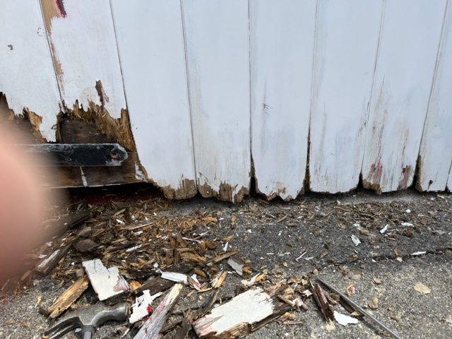

The plot is getting thicker, the rot is running higher than expected on most panels, bigger gaps appearing which will prevent a weather bar to hide. Pls see pics.
Is it a good plan to cut all door panels from bottom by about 25cm and replace with one piece of timber? I will also need to strengthen frame to fix this new timer to.
I think I now understand, sorry.
I hadn't taken in to account the fact that the hinge screws run into the bottom rail.

Providing the framework is sound then great. If it is rotten, theow it away and stRt again with a completely new frame and cladding. I have done a couple where I took the door off, set it up on trestles, then peeled off a couple or three of the T&G boards, then gone through a cycle of fix one - remove the next, fix another, etc, etc, finishing off with the last few new boards. You really need to be sure that your frame has no rot and hasn't dropped to do that successfully
As to part cladding - don't go there! If nothing else the resulting door will be less strong and easier to break into, as well as generally not being as strong or water tight
Proper marine ply costs a bomb. WBP is probably what you'd end up with, and it isn't as good, but it would certainly be heavier than the T&G, not to mention potentially thicker. That could cause problems
