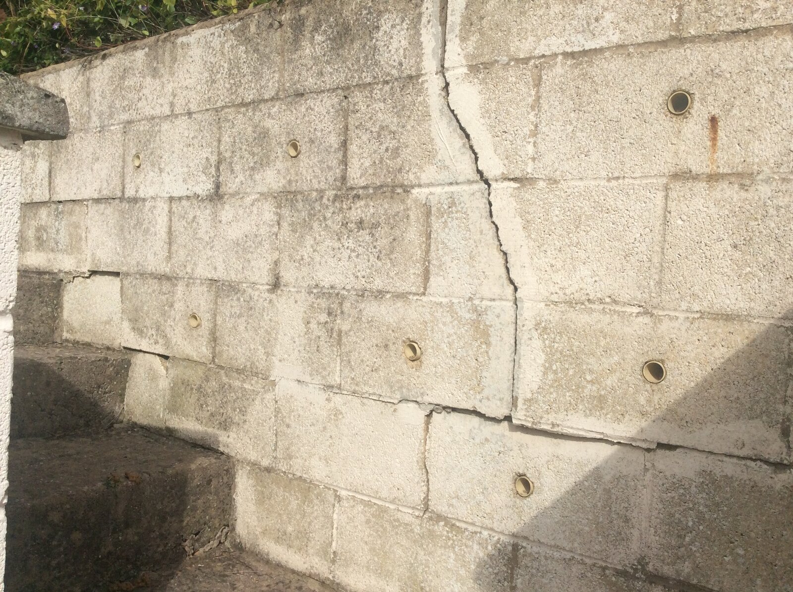

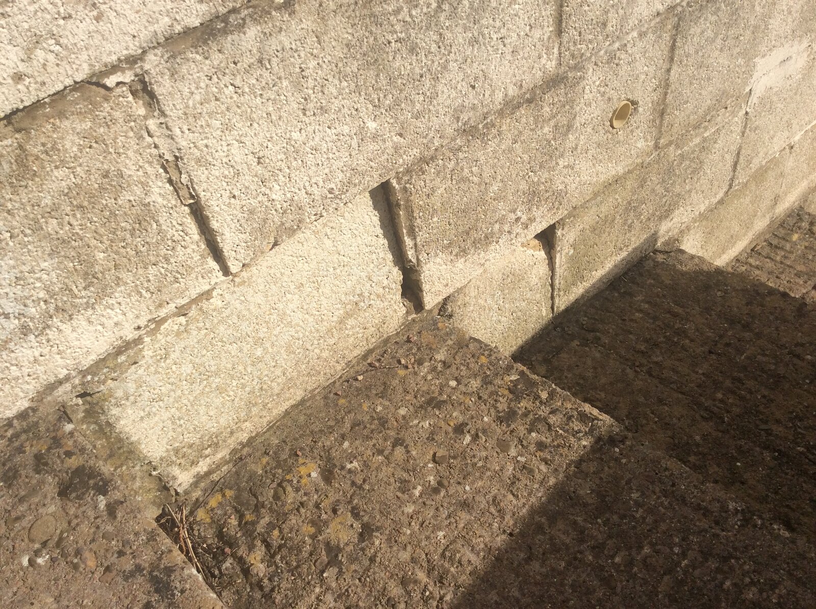

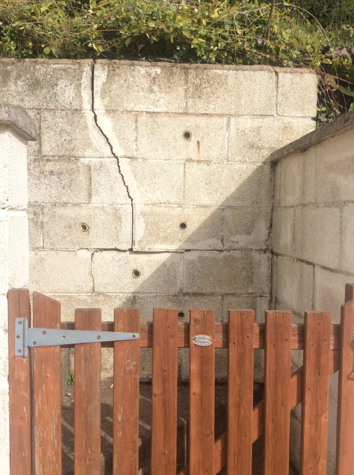

Having not long moved our to do list is pretty long and we’re trying to prioritise.

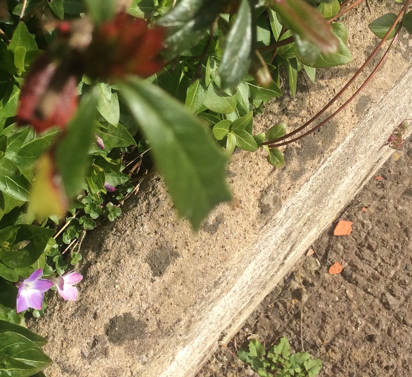

A section of the retaining wall behind our house has quite a big crack. The garden does bank up quite a bit behind it so there is a lot of pressure.
As you can see from the photos there is drainage but unlike the rest of the wall (this section edges the steps that go up) it seems a thiner layer?
We are wondering what we should do?
  • Do we need to get expert (structural) to have a look and advise?
  • Or are should we just get this section removed and replaced?
  • If removed and replaced is it something we can get done ourselves (or at least in part?). (This is the only access point to the top section of our garden).
The affected wall is approx 11ft across height varies from around a max of 5ft.
You do need the section replaced.
But I would suggest you do a plan of the area, indicating the section that has moved, and the heights of the ground behind each part.
This is in order to give an advisor a better appraisal of the whole situation.
I suspect a structural engineer's advice is not required, as long as the builder/plan of action is deemed sufficient to prevent further problems.
You could do the work yourself, but, in that case, I would suggest an expert opinion and plan, possibly with ongoing advice during the work.
Only as some removal/ demolition progresses, and better information about existing structure, can better and more informed appraisal occur.
As a rough guide, a single skin retaining wall is only good upto about 450mm
A double wall is ok upto 1200mm
anything higher ideally needs a structural engineer
It depends what you want to spend versus how long you want it to last.....
I would say as a minimum you need a double thickness wall -in blockwork that could be done with concrete blocks laid flat
It does have a return wall on the right which is acting as a buttress so a new wall could be tied into that
it may also need a pier too
It may also need steel reinforcing -bed joint for example
Who owns the bank?
Either way it's an insurance claim and they should include designing a new suitable wall as part of the replacement work
It’s our garden behind it. I hadn’t thought about going through the insurance. Is it likely that it’s covered....I’ll have a look through. Anyone had experience of claiming for something similar?
Normally, you can associate the cause with one of the risks your policy covers you for ;) And convince the loss adjuster if need be, as he may try and wiggle out of any payment.

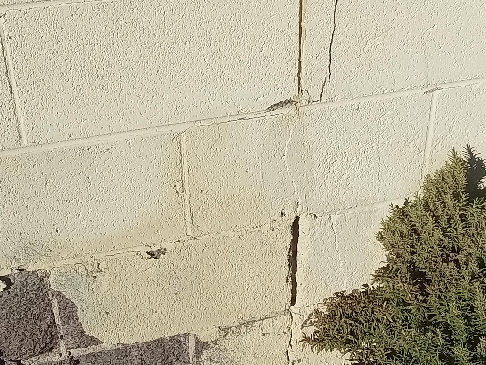

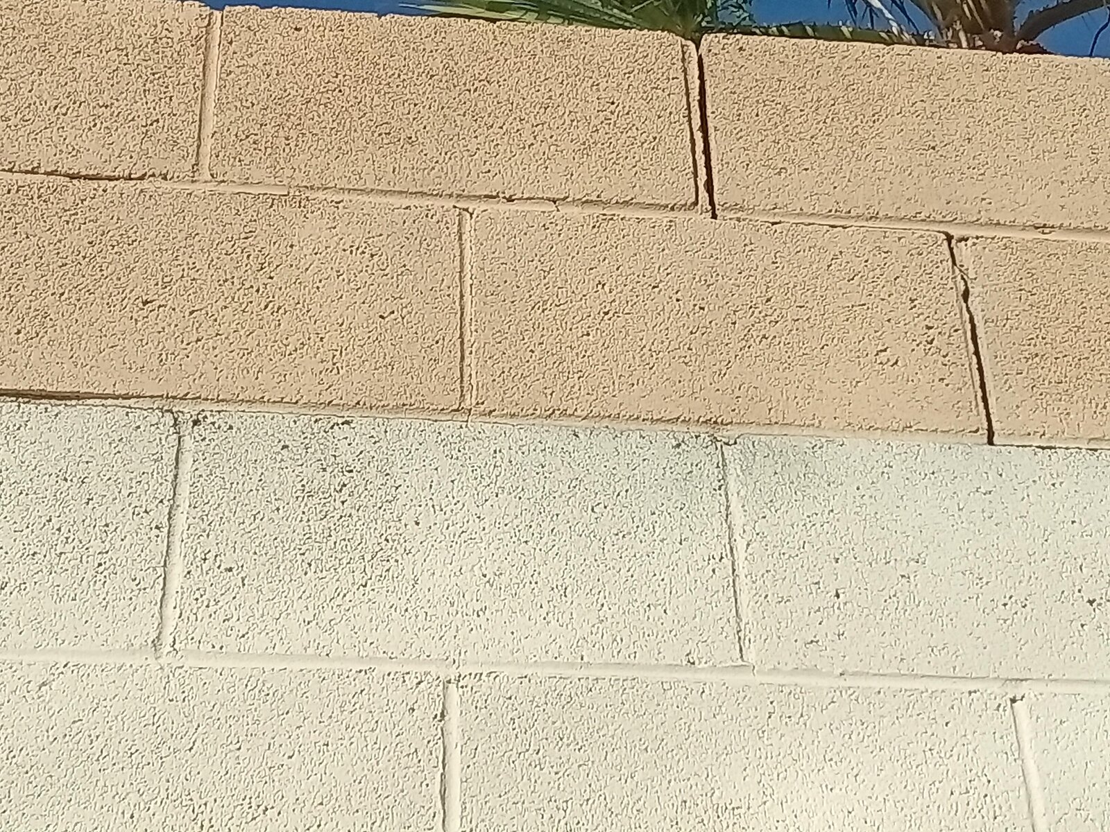

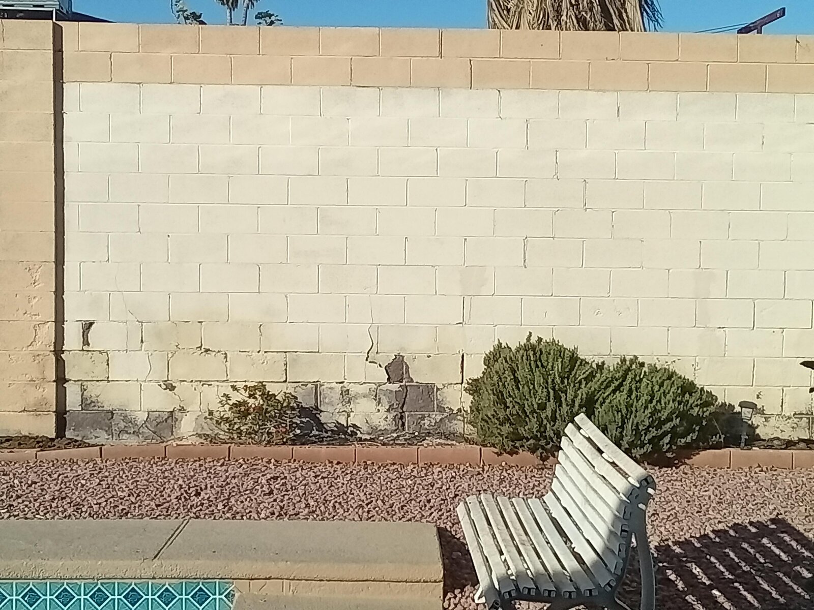

Good Evening

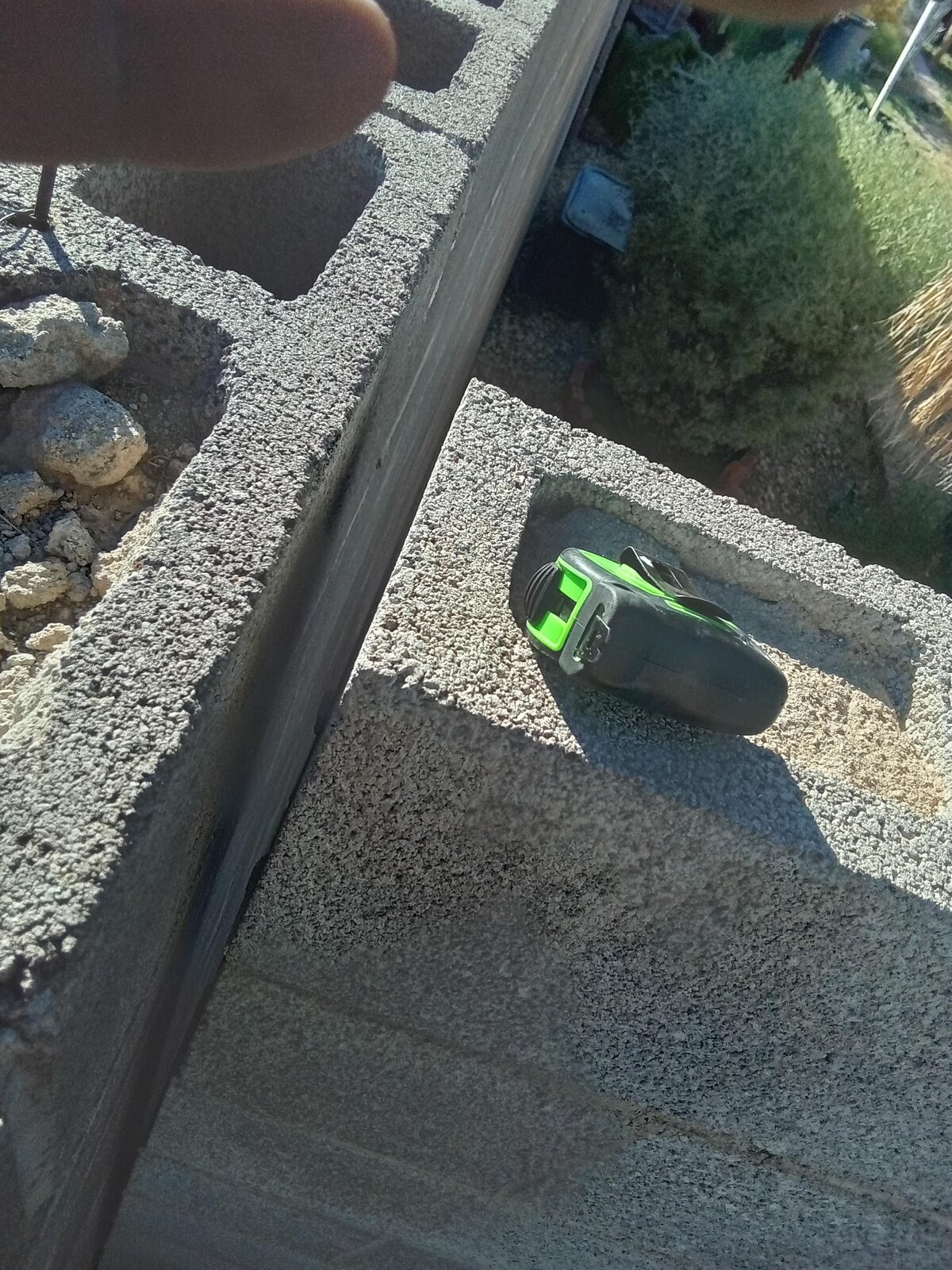

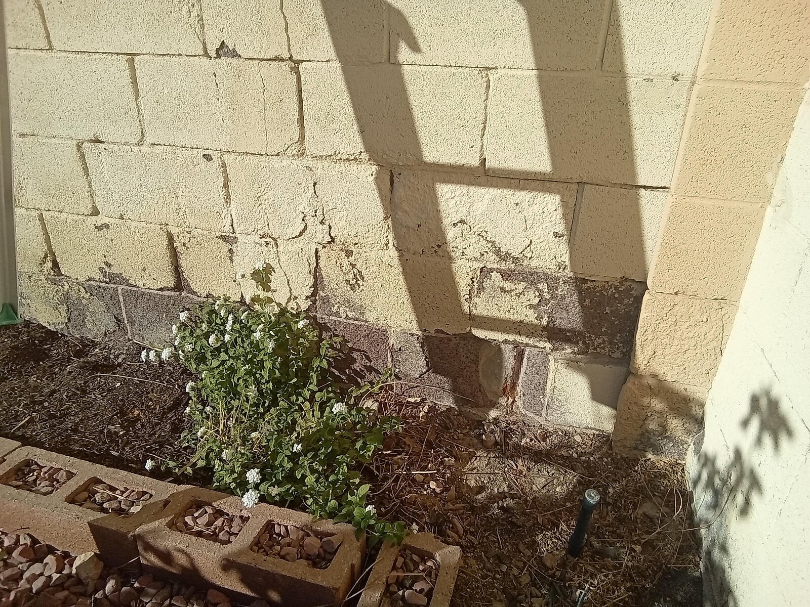

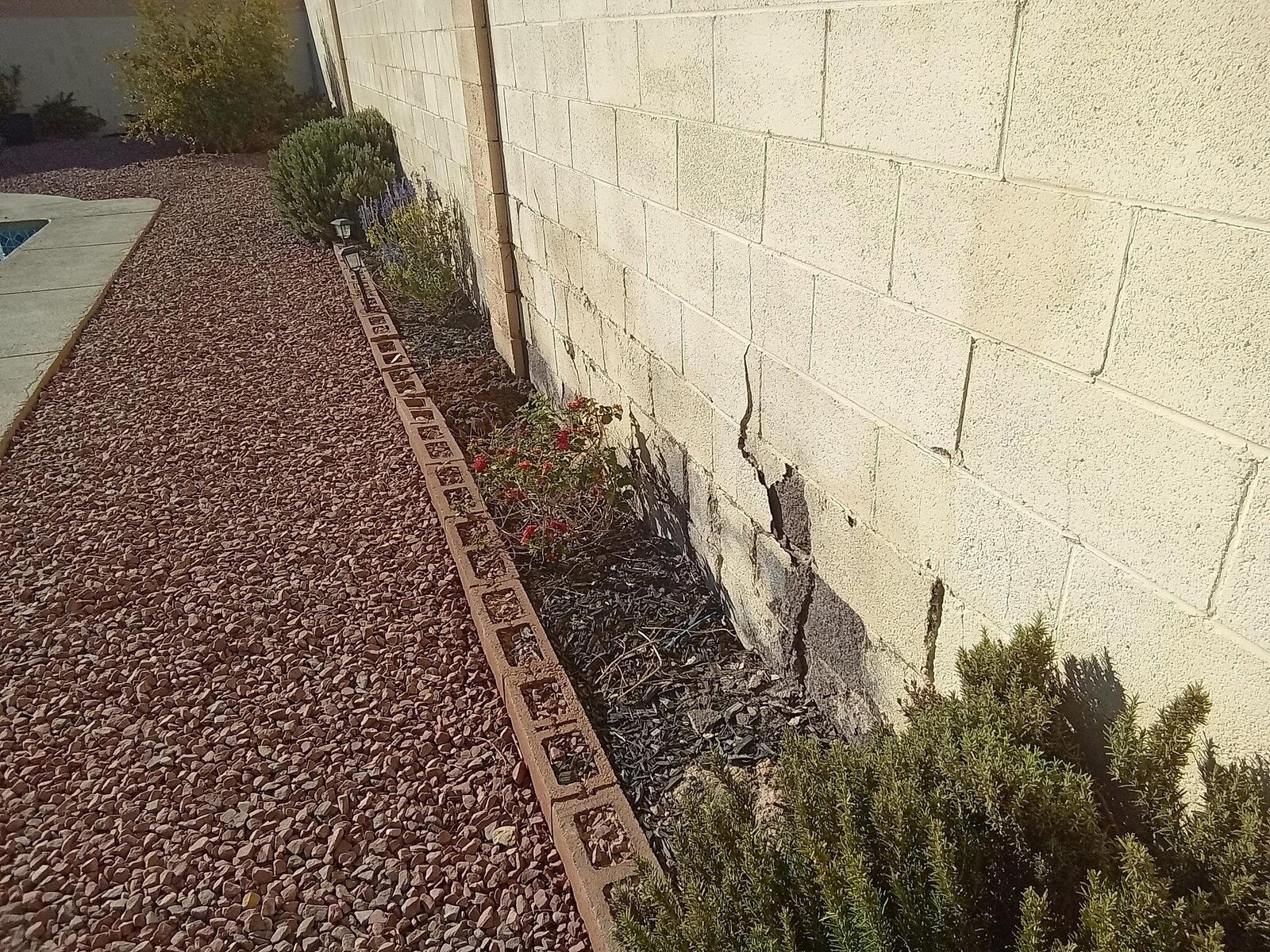

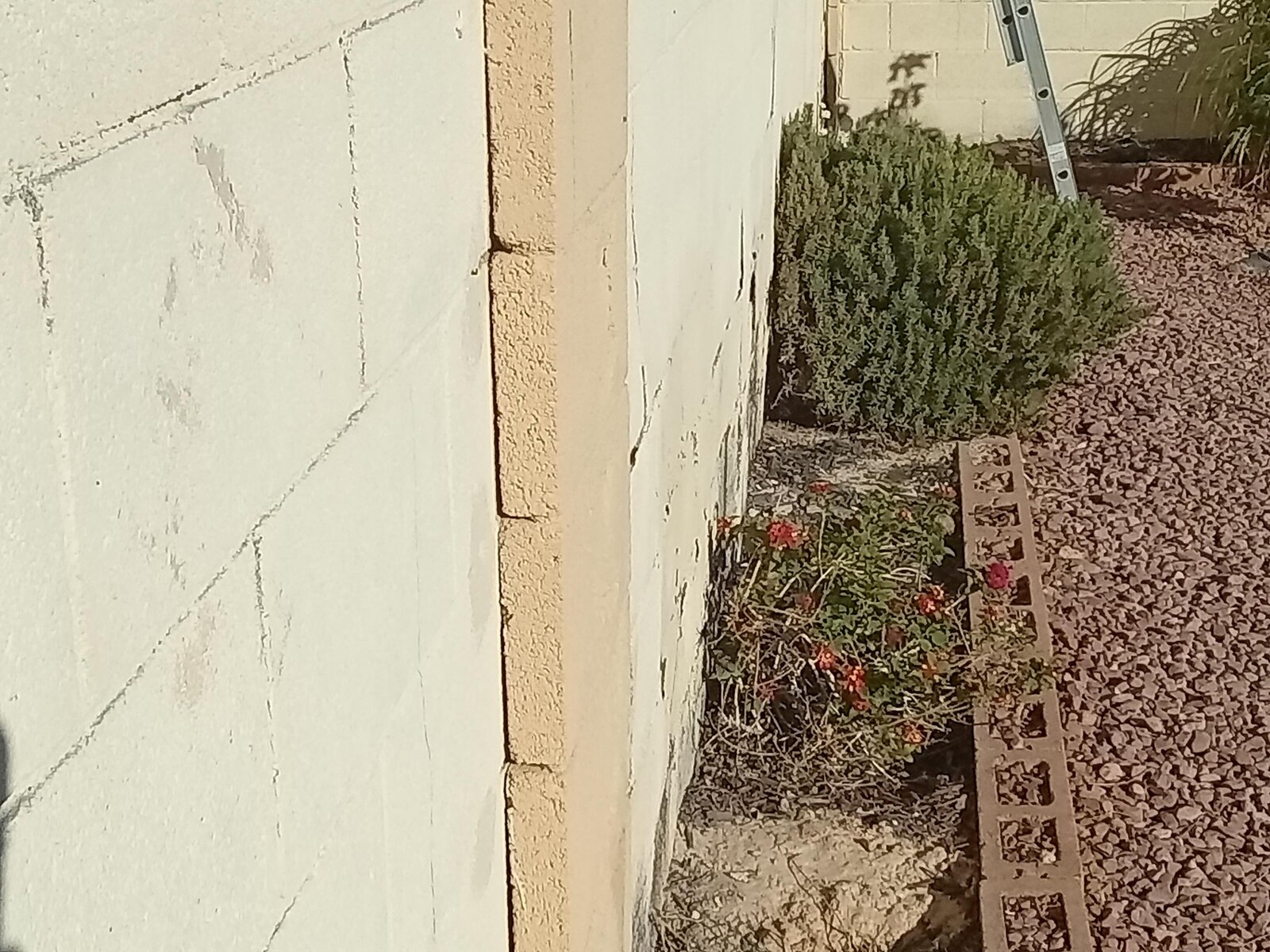

I have a retaining wall with water damage, and I'm concerned about catastrophic collapse. I watched the retaining wall next door collapse a few years back. I measured a 1 1/4 gap at the top of the wall were the forms a t. There is a staircase crack forming from the center of the section that is crumbling the most. there to major cracks from the ground up about 6 feet apart running about three feet up where the water damage originates. I'm currently in the process of getting all the bad concrete out so I can fill back in but there are 8x3x3 size chucks coming out at a time near the bottom. Can you give me your expert opinion about the likeliness of it collapsing. The pictures I uploaded are before the worked I have done so far so I will send another picture in the morning when it is light.

A 3.2m high wall build from a single skin of blocks? WTF. :oops:
RUN!
