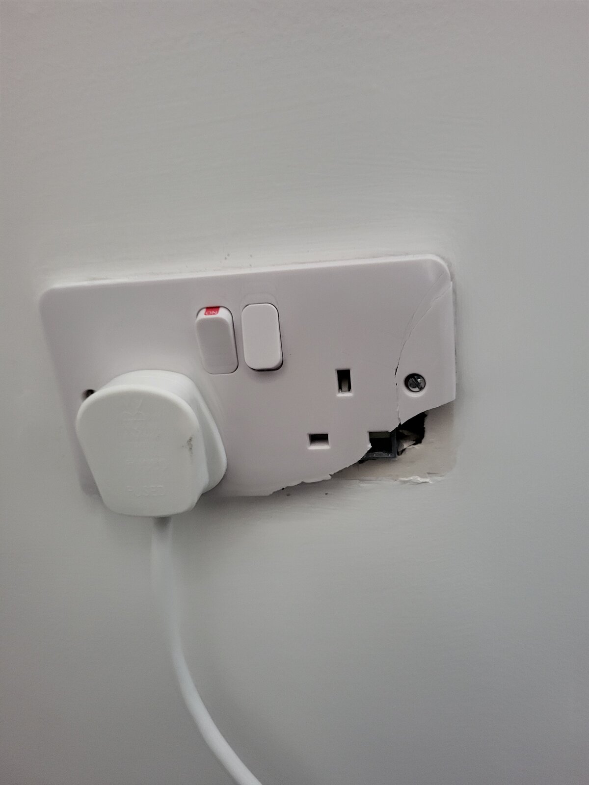

Hi all
My daughter is autistic and she hit her doll against the socket and the plastic broke. Can I myself just replace the plastic with a new cover or is the plastic attached to the wires and need an electrician to do it?
Would the electric need to be turned off on just the breaker for those sockets for repair?
Here's a photo. Thanks all

They are connected and that gap is dangerous for anyone especially your daughter. You can isolate the individual breaker having purchased a replacement socket, carefully pull the old one out and take pics of the connections, including the earth so you can make a like for like replacement with the new socket. If you are not confident it is an easy job for a sparky to do
In the UK, (unlike the USA) we don't normally have seperate "cover plates" on our sockets. The socket is built-into the plate and sold as a unit.
So yes, the whole socket needs to be replaced as a matter of urgency, and anyone not mentally capable of understanding the dangers of electricty needs to be kept away from it in the meantime.
That is not a grid socket, you can get sockets with a separate face plate but that in not one of them. You can get safety covers for sockets
that allow you to even lock the socket, so plugs can not be inserted or removed, they would it seem give some added protection even if not locked. There are many versions
just don't get any of these daft things 1723821464861.pngthey are fatefully flawed, but the other covers do seem OK.

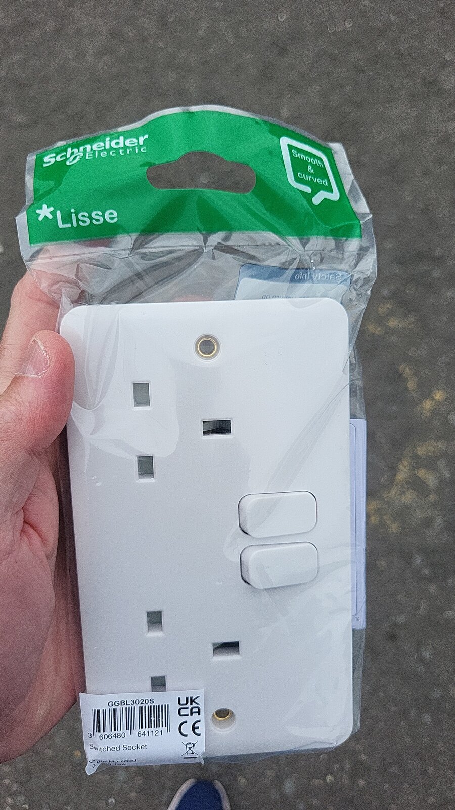

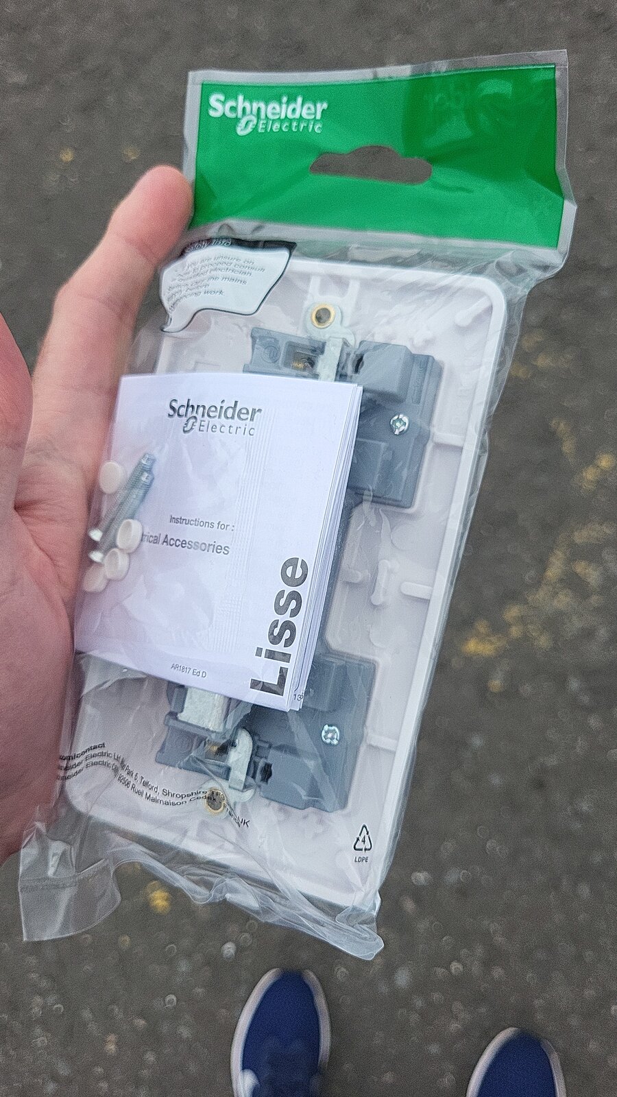

Ok thanks I am debating to do it myself or get someone to do it.
I've bought a replacement here.
Do you have a good screwdriver that flits the screws that are on the back of the new socket?
Asking as want to make sure you have the basics in terms of tools.

And be careful you connect that you connect L & N the correct way around, some types/makes of sockets have the terminals in different places to other types or makes, even being the exact opposite of each other (right/left & left/right etc.
Making sure the L terminal is used for the same conductor wire as the L terminal of the one you are removing - providing that it was wired correctly in the first place - read the lettering on both sockets.
As you have purchased a Schneider Electric Lisse socket-outlet,
this (too short) video (if you stop it at 0:30) will show you how to connect the Line (Brown or Red), Neutral (Blue or Black) and Earth (Green/Yellow sleeved) conductors.
(Note: You may have only one of each.)
Some manufacturers have the switched and unswitched versions of their sockets the other opposite way around from each other for example.
The ones I prefer have them Line to the right terminal and N to the left terminal (as viewed from the front of the socket) just like the ones that Frodo video shows, but others are the other hand.
