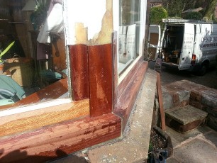

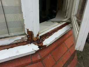

Anyway I have found a local company that offer a Resin Repair service (see pictures) which looks like it might suit our situation. I have asked for a quote

Those don't look like original windows. But still cheaper to replace the wood than get new windows.
Sorry, those aren't our windows - they are pictures from the contractor's website showing before and after shots of his Resin Repair service
