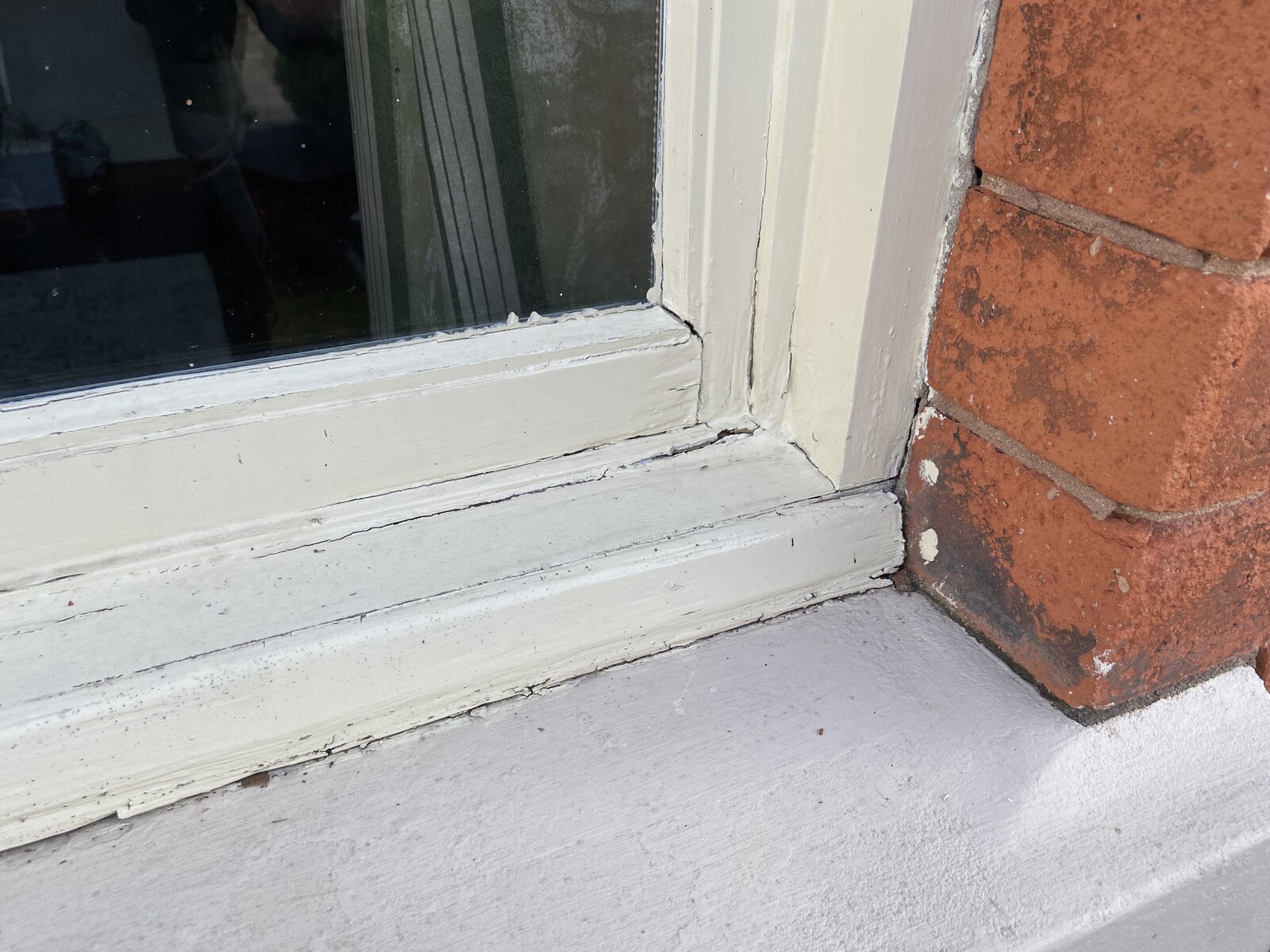

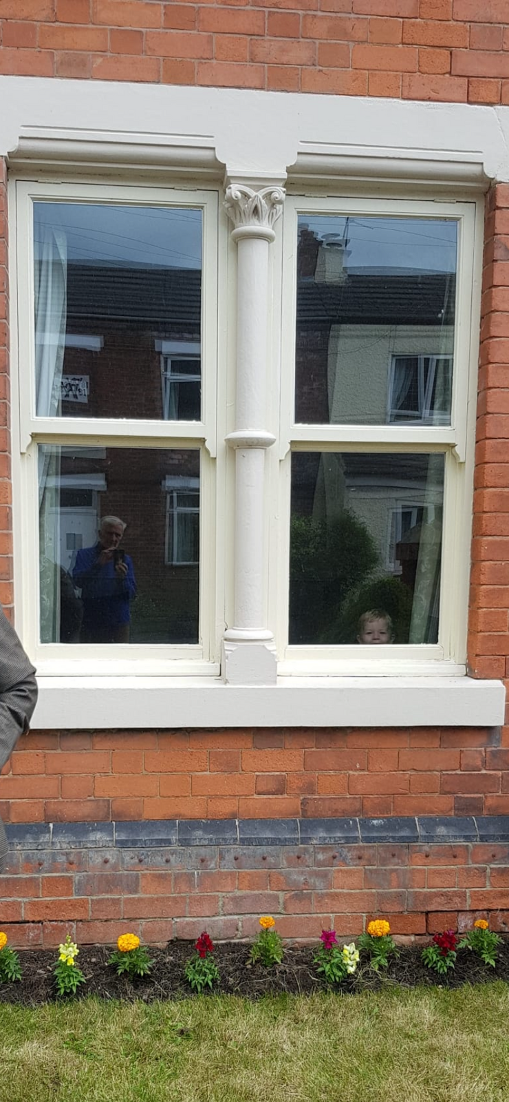

I’ve recently moved into a new house. Built 1906 it’s in need of sympathetic repair work.
I’ve cleaned out all the gutters which were blocked up and causing damp, repointed some ground floor brickwork with lime mortar, had a rear chimney stack taken down (breasts had been removed with no support!) and have a few more jobs.

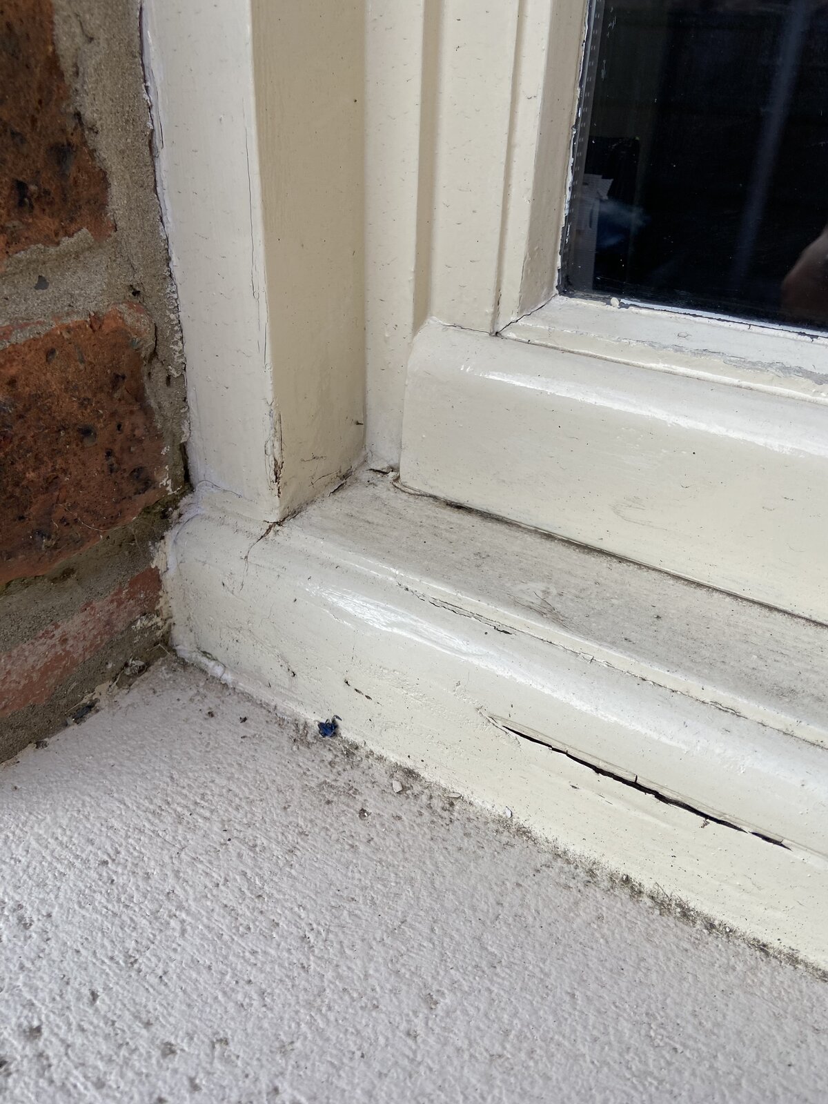

I’m concerned with the wooden windows. Many of them are rotten at the bottom — mainly the cills and the bottom ~1 inch of the frame. You can see it in my picture (my Dad is in the reflection, I’m much younger and poorer!) If I press these areas they are like sponges.
They probably need replacement, but I can’t afford it, so I want to repair them to at least get us through a few winters. I had initially looked at chopping out the rot and splicing in hardwood, filling and painting however I’ve since learnt about epoxy resin repairs.
Does anybody know if this could work or have any advice?

Something like timbabuild a two part epoxy is widely used in wooden window repair. You can let in new timber and cover the join with resin for larger areas of repair, as it sands down, or use it on its own for smaller jobs.
Timbabuild make two different epoxies. One cures in 1 hour, the other in 4 hours.
The 1 hour is primarily used for smaller gaps and splicing in timber. I have however used the 4 hour for splicing in as well.
Timbabuild used to be my brand of choice. I used to be able to get it via a mate that had a trade account at Reddiseals for £25 inc VAT per and a min of £100 for free delivery. He has since retired- now it will cost £48 incl per tube (subject to a min order of £95 for free delivery).
I have since discovered a company set up by people that used to work for the company that makes Timbabuild. They charge £25 incl with free delivery. The products are pretty much identical and thus far seem to perform in the same way.
A downside to using either brand is the need to buy the dedicated gun. They Oxera charge £32. However, Oxera do sell pots that you can mix manually- I have never used them though but it might be prudent to ask them for advice.

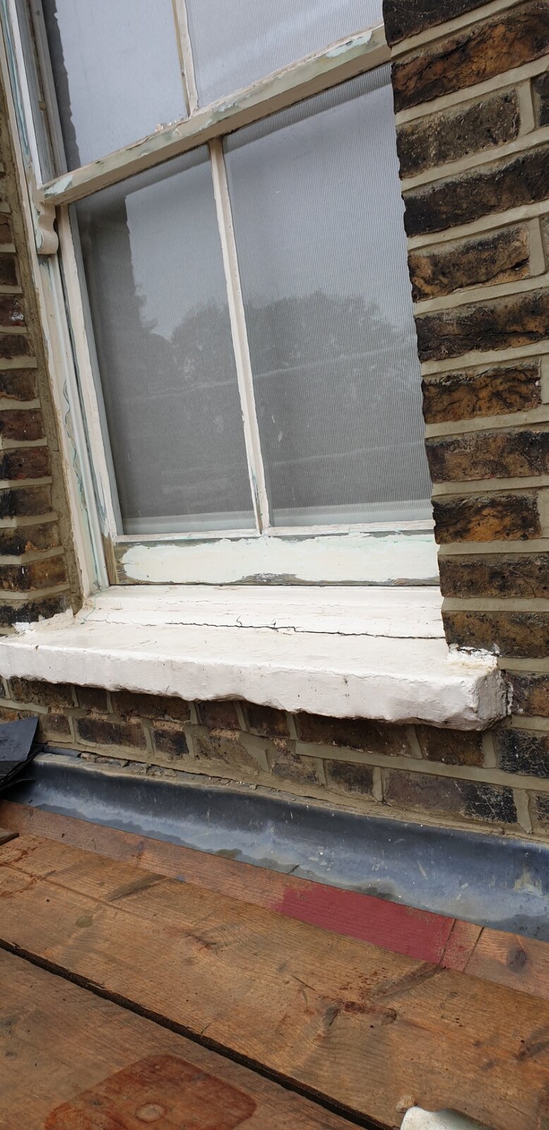

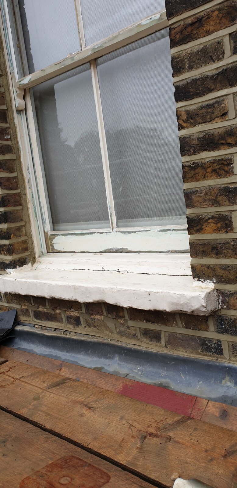

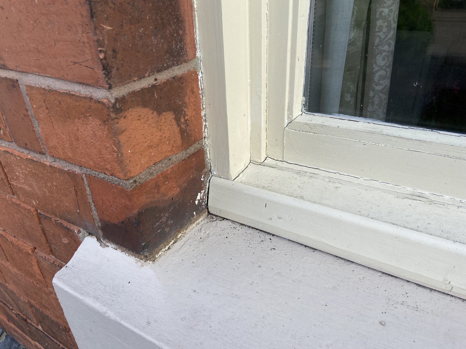

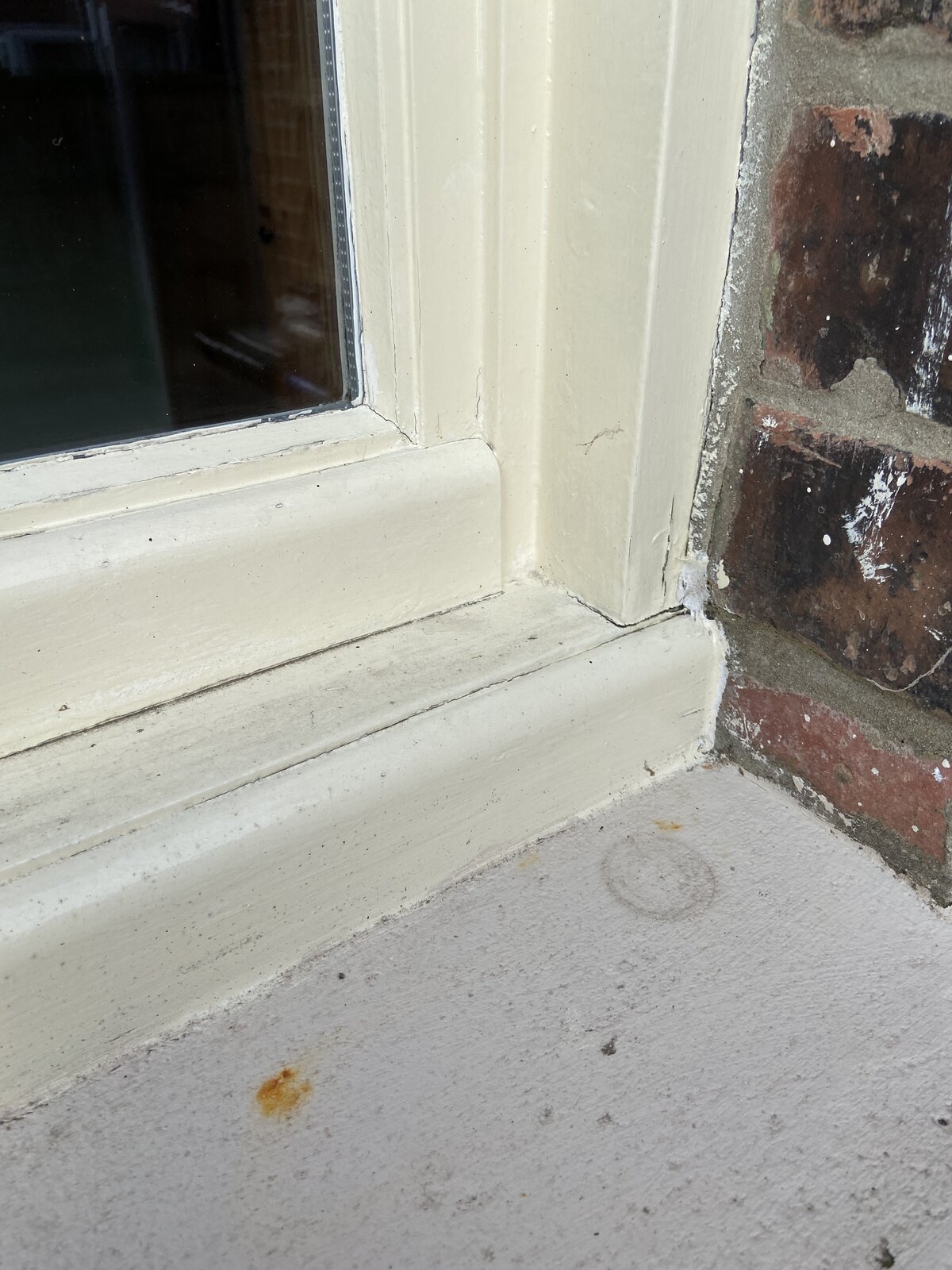

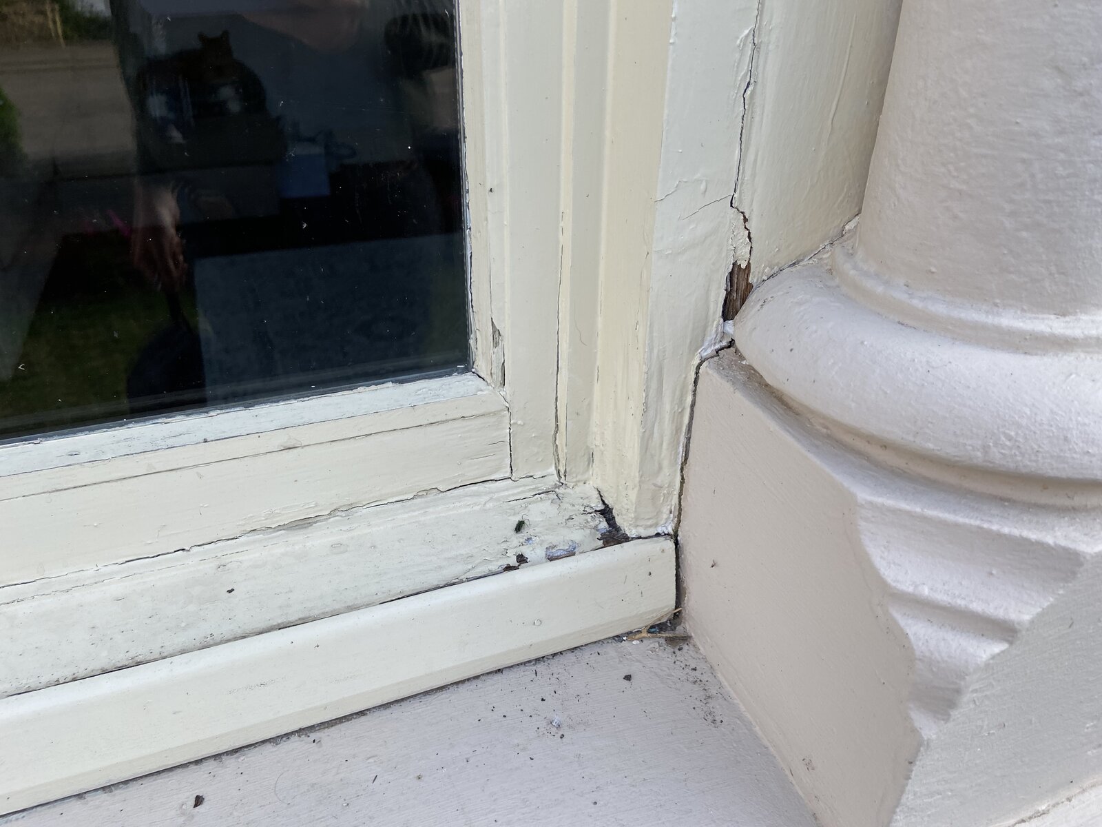

The first two images show the average level of rot on most windows — it seems to be limited to the moulded timber section on the front, and parts of the sill and bottoms of the frames. I’m confident with chopping that out and replacing with timber of a similar size and profile.

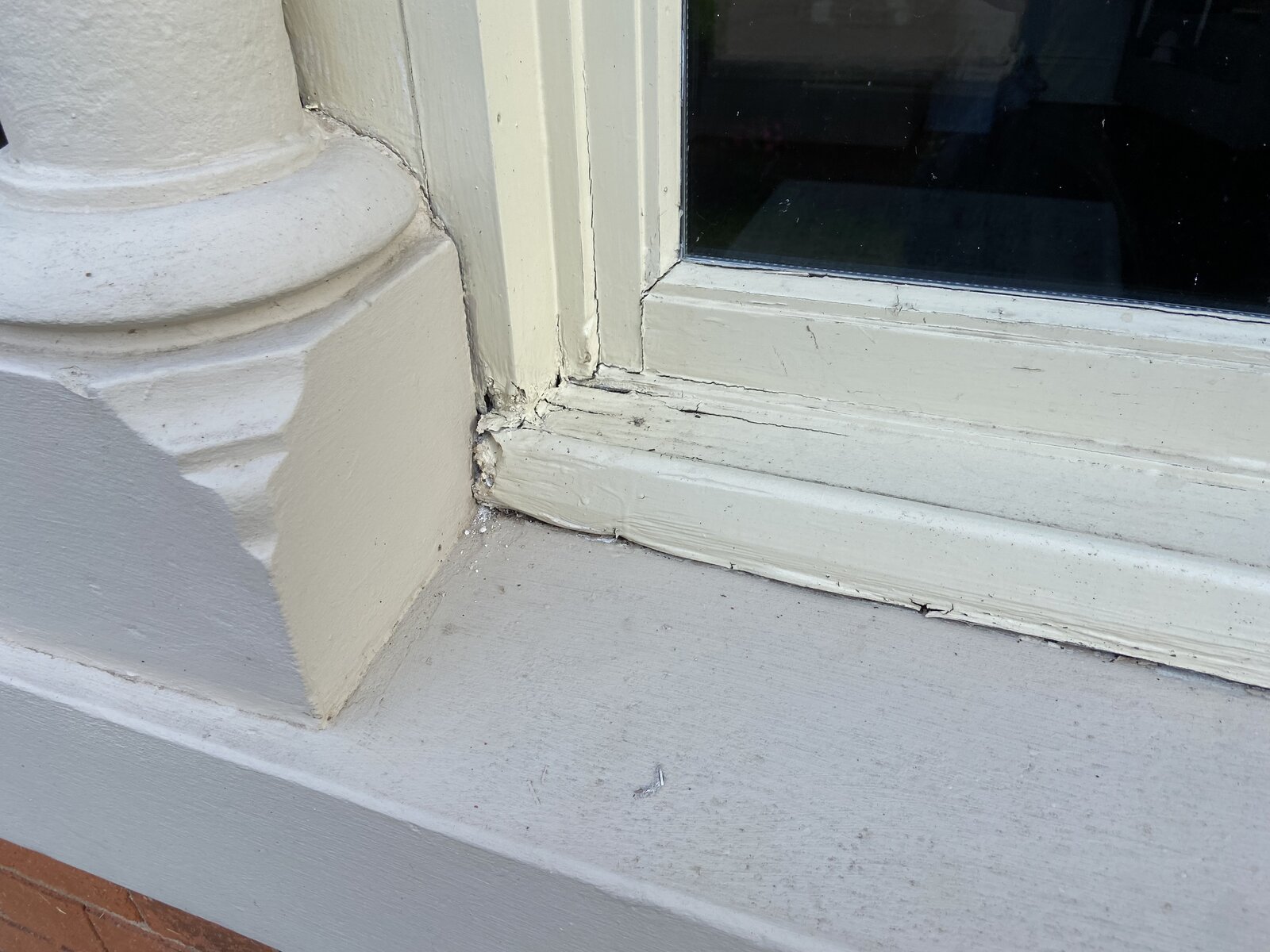

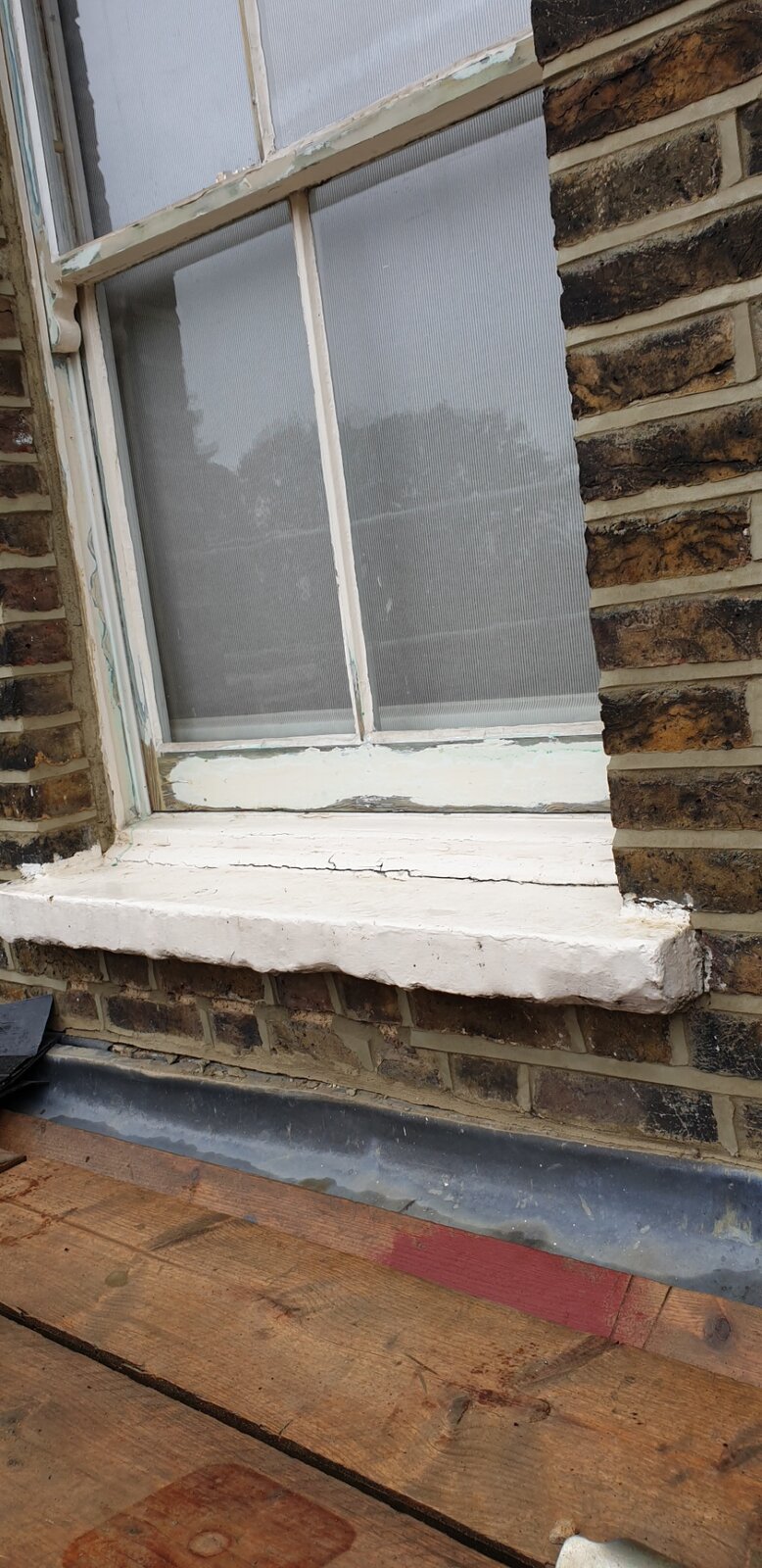

The last four images show the worst window, which is letting water in the house. I’m trying to source a joiner for that, as it’s not within my skill set.

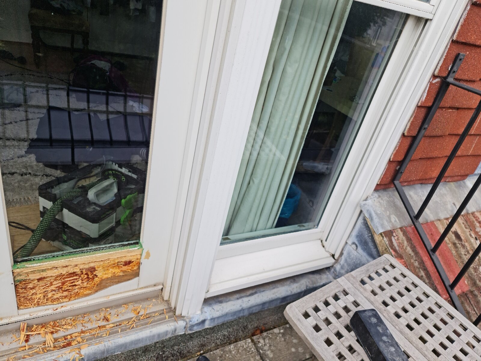

Ronseal wood filler is a polyester resin filler (AKA 2K filler/ 2 pack filler)- same stuff as car body filler. It is a good product but it lacks flexibility. It is not suitable for splicing in timber. That said, even after splicing in timber, I occasionally, first prime the area and use 2 pack as the final face filler (for aesthetic reasons).
Epoxy resin fillers are incredibly sticky. They are more difficult to sand than 2 pack fillers, so I try not to massively over fill with them, hence the 2 pack for the final finish if required.
The 1 hour resin, the more flexible of the two is easier to sand (than the 4 hour). The 4 hour however can be used in cases where the area is load bearing- that said, it is not often that you cannot splice in timber.

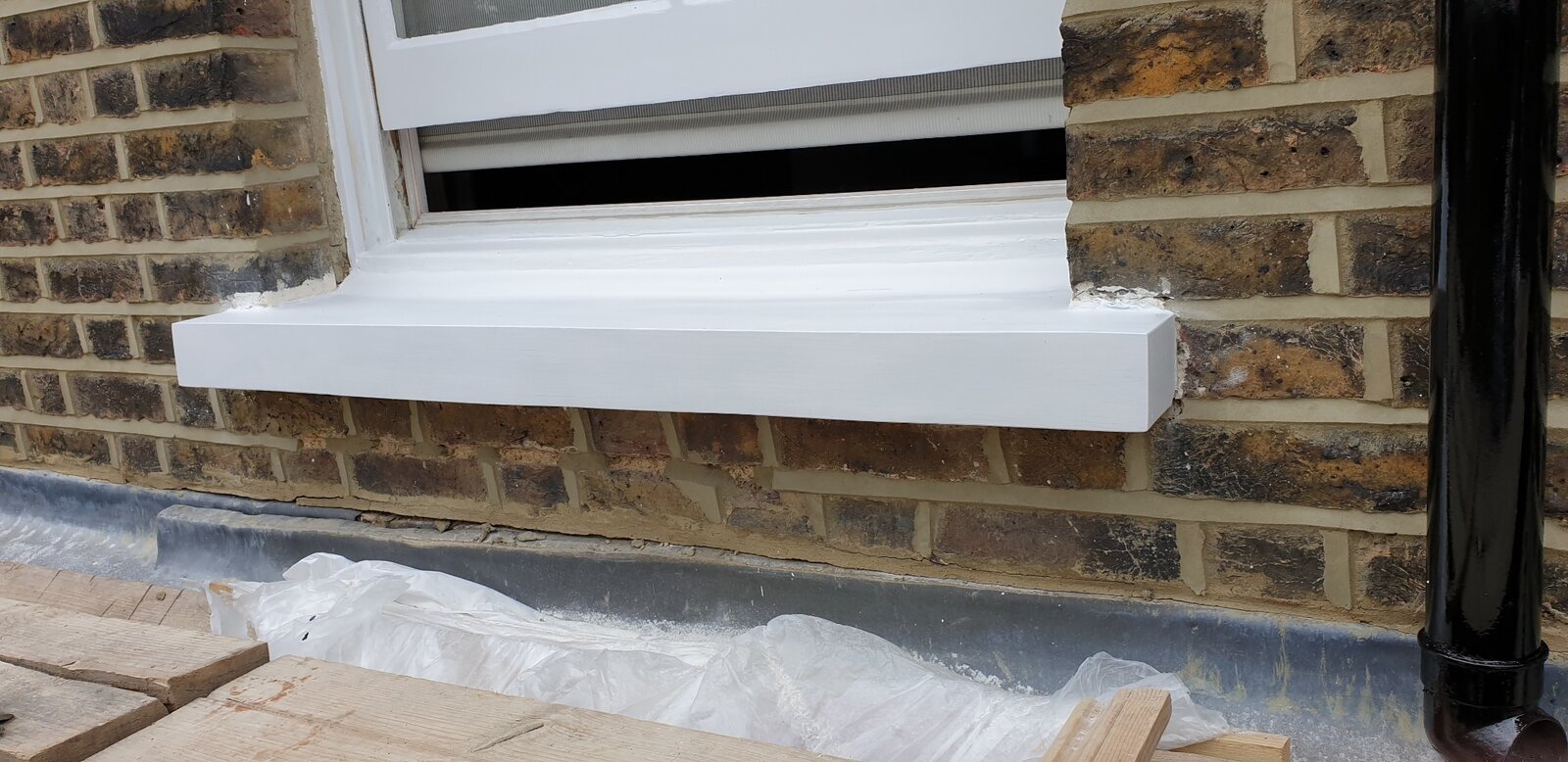

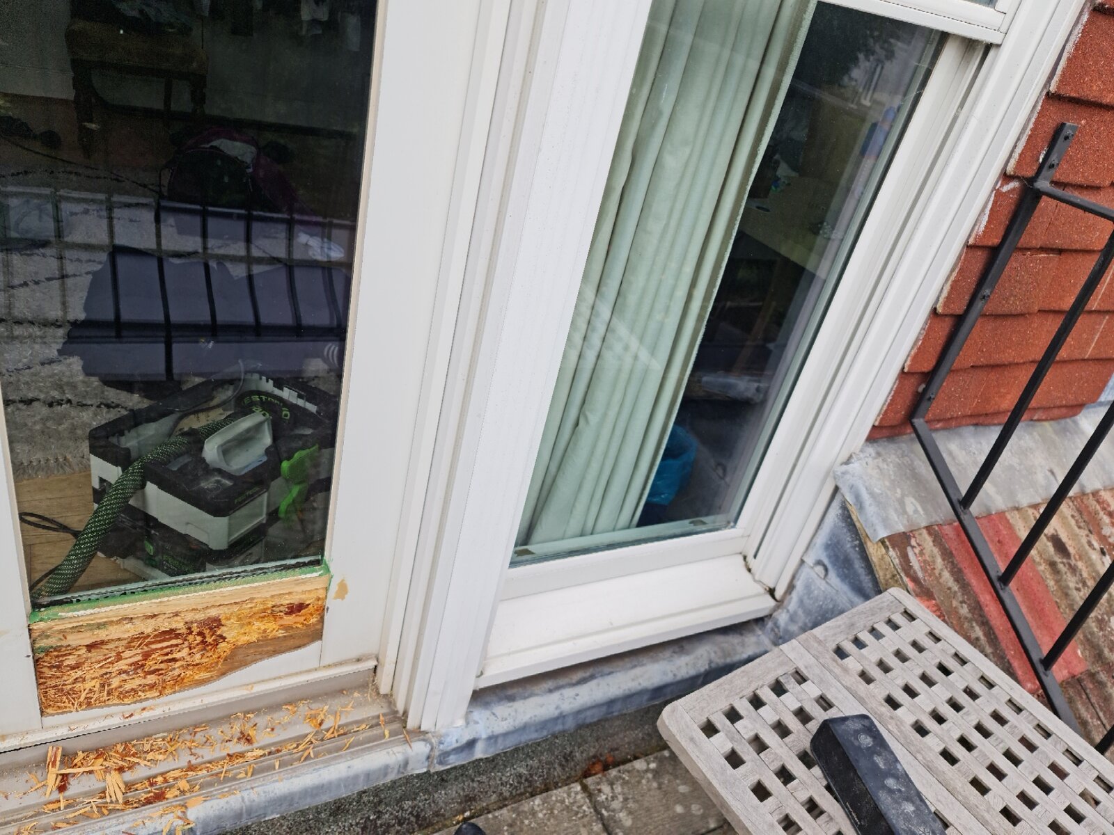

The above is a photo of a door I had to deal with last week. I was surprised to discover that it is plywood. I removed the rotten sections until the area was pretty much uniform in depth. Applied Tetrosil wood hardener (thanks to @jobandknock for the tip), and then spliced in 12mm ply. Previously, I used to use the expensive Timbabuild epoxy wood hardener but found that any that touched previously painted surfaces would stay tacky for days.
BTW, ideally, you will remove all loose timber. No wood hardener will make timber that can be scraped away with your fingernail hard enough to "glue" to. I use an oscillating saw and chisels, some other people use die grinders. I do not own the latter.

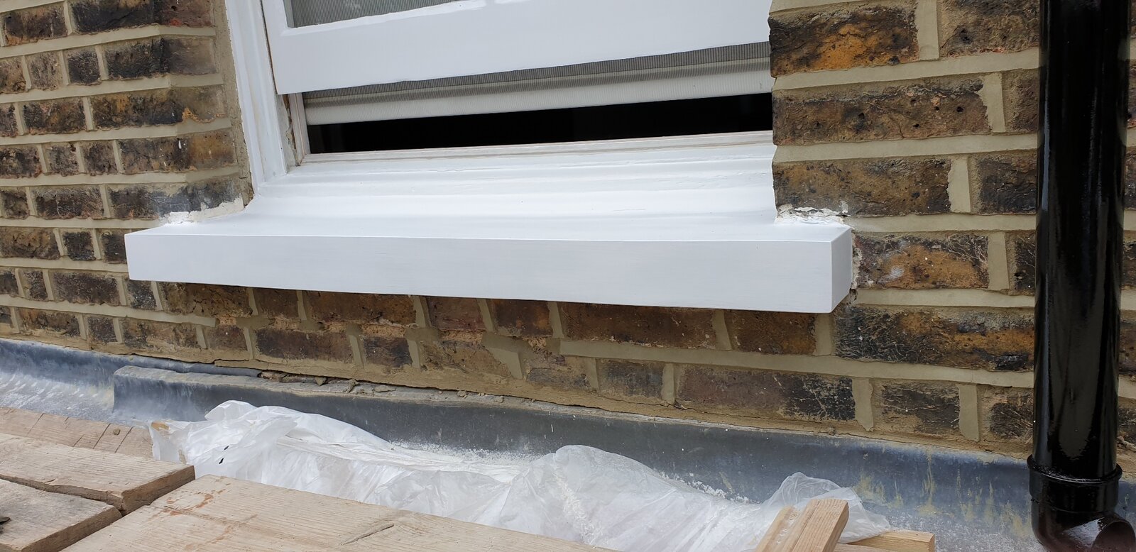

To minimise sanding in awkward areas, you can use off cuts of perspex or off cuts of timber wrapped in polythene. They can be pulled away after the product has cured- it works with two pack fillers as well.
By way of an example, I used 2 pack filler to straighten the underside of the following sill. I wrapped poly dustsheet around a length of timber and then clamped the timber to the sill. Once the filler had cured, I removed the clamps, and pulled away the poly.

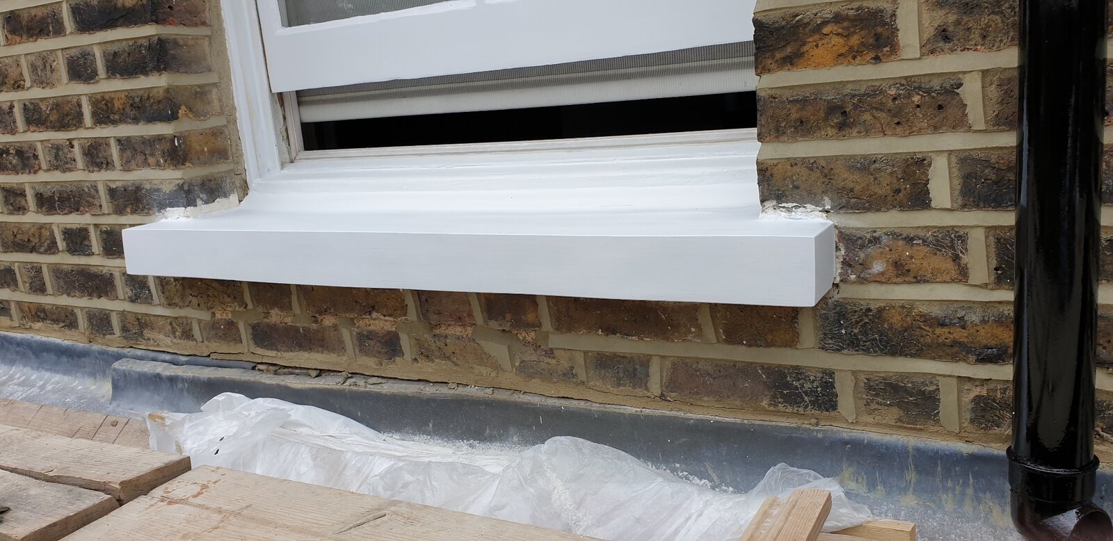

Enjoyed reading that, really, thanks a lot for an informative post (especially tips profiling and mixing the filler). I have used body filler a few times so I think that’s why I was drawn to Ronseal. I need to go and weigh up costs, sources of supplies.
In terms of splicing the timber in, my approach (and I hope I’m correct) was to cut back to solid timber and notch in the new stuff with glue and screws. Alternatively I could just butt join the old and new timber with glue, then again screw together.
Your lower sashes do not open. Yup, cut back to new timber, but you do not need to use screws the epoxy resin will lock the new timber in place.
