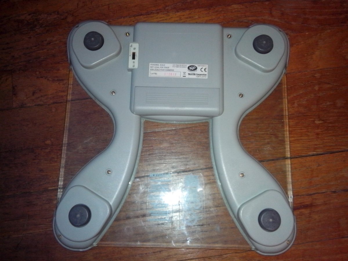

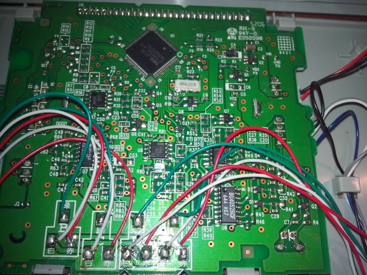

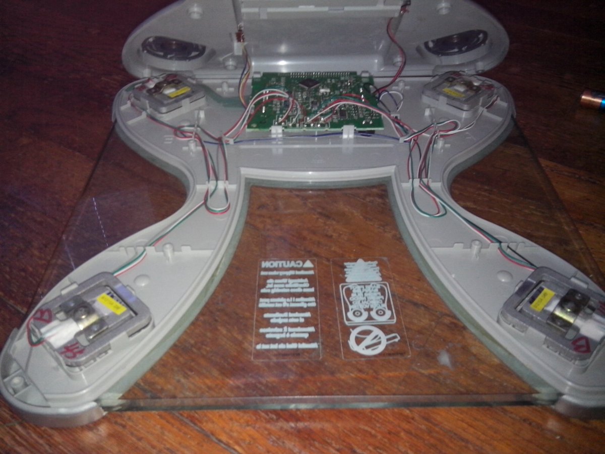

I have a bit of experience soldering but not of testing circuitry, so can anyone tell me where the first places to start is?
The problem is that the scales are no longer switching on. The batteries have been changed to brand new ones and the LCD display is totally dead. It will not turn on.
Top view of the scales :
Bottom view of the scales :

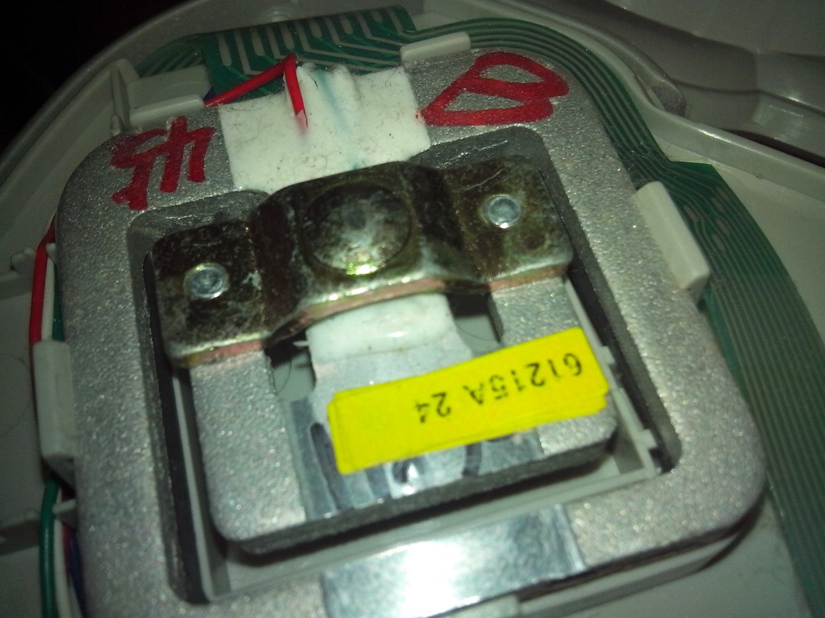

Unscrewed the fascia:

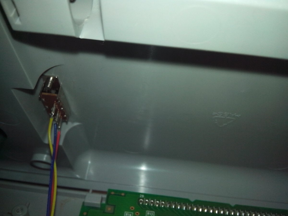

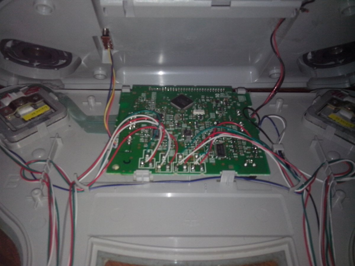

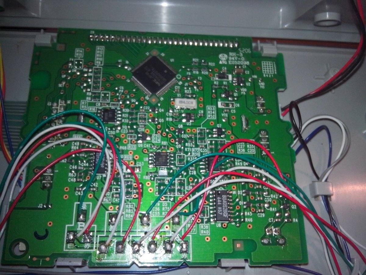

Close up of the circuit board :
I'd like to have a go at repairing this before I toss it.

A better close up of the PCB (both sides) might help a bit more.

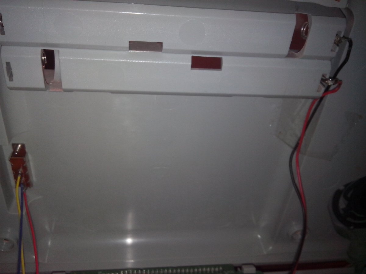

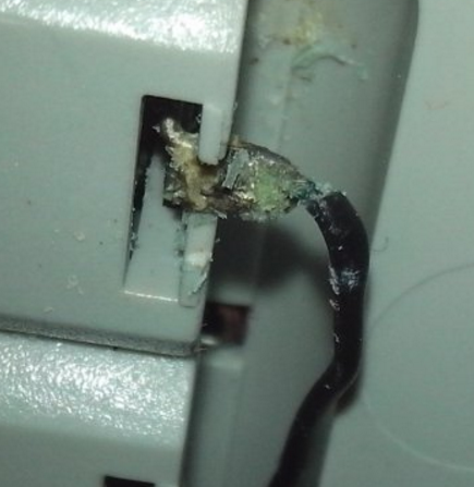

Have you checked to see if there's voltage at the first point from where the battery connects to the PCB? Could be a duff battery holder
Yes would be best testing out contact first. But although expensive, power loss is a common issue with these. I binned mine. Sorry cannot help any further.

anything obvious ? I'm getting a multimeter on wednesday. Never owned one.
