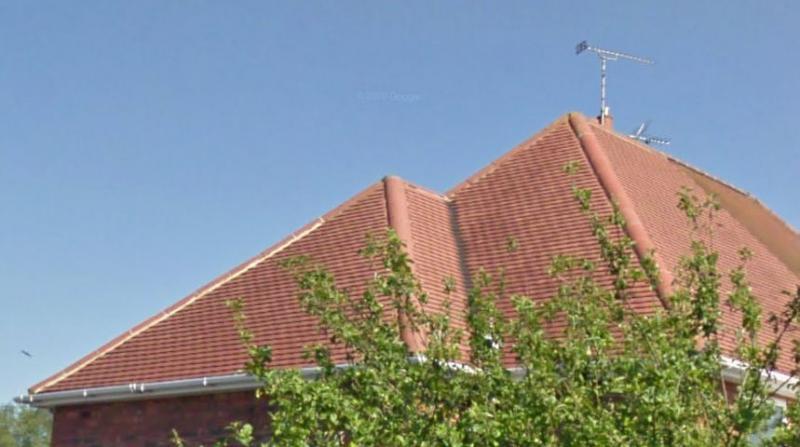

Just bought my first house, first rain last week, and its coming in through the valley.
Its a hipped roof with a dog-leg, so three hips and a valley. Tiles have been renewed in the last decade, but the felt is shot and as far as I can tell from the poking it have done from the underside there is nothing between the felt and the tiles, hence the leaks.
I've been quoted £550-600 to repair it, which includes removing tiles to fit a GRP valley (two lenghts at £16 each), repointing/reflashing around the chimney as required (also leaking), changing two other broken, and reseating a couple of hip tiles, plus £250 for a days scafolding for access to the valley. Based on one days labour for the valley, three hours for other jobs.
He also said that it would likely involve trimming the valley tiles to suit the grp. And that he cant do it for four weeks due to being flatout elsewhere, followed by a fortnights holiday.
So all in all i dont think thats a bad price and i might just let him do it, take the day of work to supervise him, but spend most of it working elsewhere on the house (its not like i couldnt sink a days work somwhere!). Buckets under the roof untill then!
However if i was going to DIY it, how big a job is it for a novice? Im pretty handy and am doing all the rest of my own DIY and am an graduate engineer by trade, but not experence in roofing.
Also, I assuming this isnt a stupid thing to be doing, given it leaks, im skint, and its not mid October. In the long term to doa full job the whole lot wants off and new felt but i think that can wait a year or so till the summer after next!
View media item 38561 View media item 38562
- 10 year old re roof must have a bad detail somewhere - probably the lead saddle - or lack of it . You need Noseall , from Staffs. and a regular on this forum ;) Shouldn`t need a GRP or even a lead valley either come to that . A tiled valley should be fine unless one tile gets broken like happened to me :cry: Plenty of roofs with no felt at all
Could have took a closer picture, but looks like an open valley to me, I think youve been quoted a good price.
I wouldnt try doing it yourself, theres a few tiles to come of there to fit new valleys.

The difference between the valleys is, Nigel F suggested it was a closed valley, ie valley tiles.
But from the long shot photo, it looks like an open valley, ie a lead valley with the tiles cut in leaving a 150mm gap.

Closed valley, ie valley tiles across.
Open valley, ie a lead valley with the tiles cut in leaving a gap.
Ah ok, in that case its very much a closed valley.
- With a line of moulded tiles running down the valley, which are just a slightly darker red.

The valley is finished with purpose made valley tiles.
I reckon they used the old ones saved from the original roof, which is why they are a different colour - It's most likely that one or two of these are broken causing the leak, they are easy to fix (replace) and less hassle than changing entirely for an open valley.
Based on the pic i'd go along with Bethes...Brocken valley,minutes to fix.. But! it could also be saddle issue at the top of the valley. it may or maynot be there!!

A lead saddle is used at the complex interface at the top of the valley where all the ridge tiles meet.
It should be beaten in place before the ridge tiles are fitted and weather the junction.
Felt/underlay would be under both the tiled valley or a grp valley.
yours appears to be a straight forward tiled valley to replace a broken valley tile is very easy and would yake just a minute or two (once you get up there ) No fixings involved, they are simple laid in there and wont fall out due to their wedge shape.
Replacements wont be hard to find any roofing merchant will stock "plain tile valleys" going by colour i'd say yours were marley concrete valleys.
Saddle is a piece of lead which is fitted at the very top of the valley at the junction of the ridge/hip /valley this weathers everything should the mortar fail.
It is possible your roof has been leaking for years and the felt has eventually failed.. very common.
