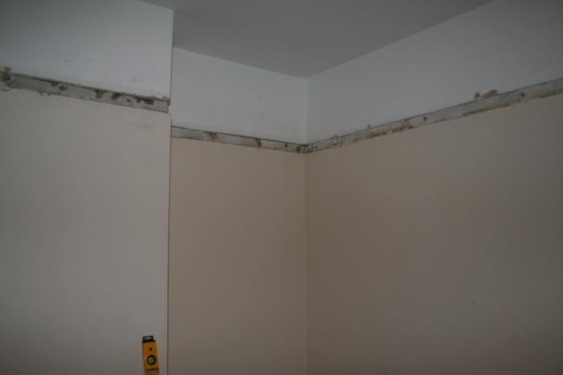

Hi All,
I'm renovating a room in my house. It had a picture rail, which I removed. But now I find the bottom section of the wall is out of alignment with the top by a few mm. I've had a plasterer come in for a quote, and he tells me in order to do a perfect job, he's going to have to apply filler to the area, and then skim the entire wall and not just the the bit in the vicinity of the problem. Is this the only way to get a perfect finish?
well it depends on whether you are getting your hands dirty,
as using a very wide filling knife/trowel you could do this yourself and feather the problem,it wont just be the 2 inches of the removed picture rail but something like 10 inches???
perfect job would be to skim the lot yes but i suspect you don't need this amount of work, i'd have the area from the bottom of the picture rail to the ceiling bonded out level and then skimmed and feathered into the existing, or easilfilled.
