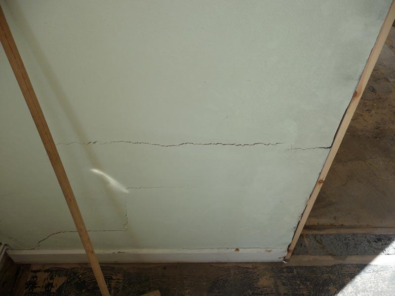

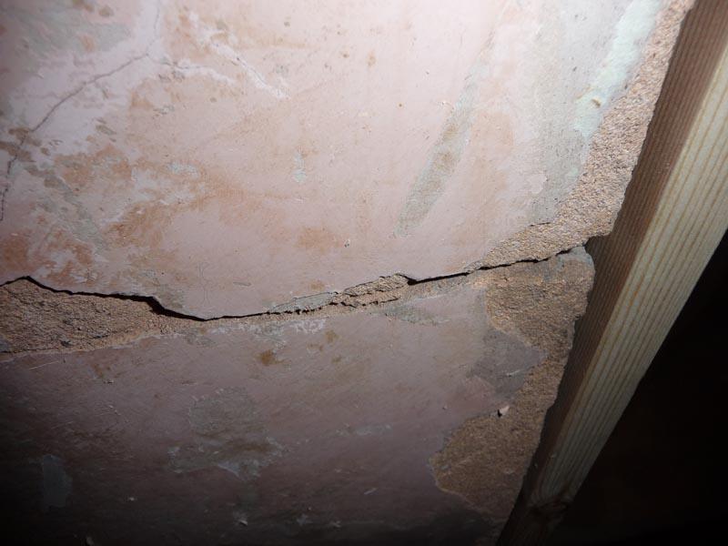

OK, another question...
As I mentioned before, I removed a wall earlier on in the project. We also had a door put in the wall opposite the demolished wall. Both of these walls were / are non-supporting (engineers report to prove it!) but were made of blockwork.
When we bought the house, the engineer had also reported on the fact that these walls had large cracks in them because the floor had collapsed not long after the house was built in the early 60's. The floor itself is level and stable, but did have signs of collapse around the edges where some of the edges had stayed at the original level. I've since removed and levelled these. There are large cracks / gaps in the remaining wall, but I don't want to demolish this.

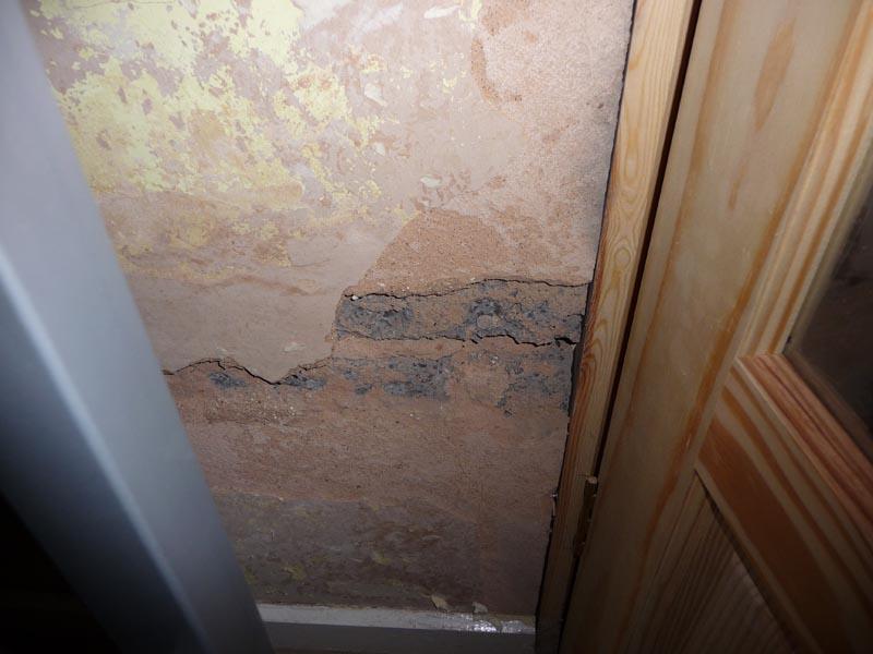

So what would I fill these gaps with? You have to realise they are quite large... In the demolished wall they'd obviously attempted to shove bits of slate in the gaps not long after the wall was built to support / hide the gaps after the floor collapse. They'd also put wire in the plaster over the worst cracks. They've not done that on the remaining wall. I don't expect any more movement bit I want to make a more permanent fix so that the wall won't move, and the cracks wont reappear.
That make any sense? Any suggestions?
rake out the cracks then pva and point in some mortar to fill the cracks flush with the blocks.
pva then bonding plaster to bring out flush with existing, then multi finish to complete.
the wall in the 3rd pic looks :eek: dodgy! you sure it doesnt need rebuilt?
or if you want to play safe you can use this kit
The first 3 pics are the same wall, just in different states of undress or positions. I think pic 3 is worse than it looks in reality thanks to the flash. Does it need rebuilt? Hmm its not the best wall in the world lets put it that way, but it is stable. My guess based on the other wall is that it has been like that for at least 20-30 years with different owners trying different bodges / quick fixes to make it look better...!
The plaster reinforcement is exactly what is under some of the existing plaster at a low level.
aha, well if its been like that for decades i dont think its going anywhere fast :p.
personally i would use the expamet 4/1 sand cement then bonding and finishing plaster.
should outlive most of us then :LOL:
