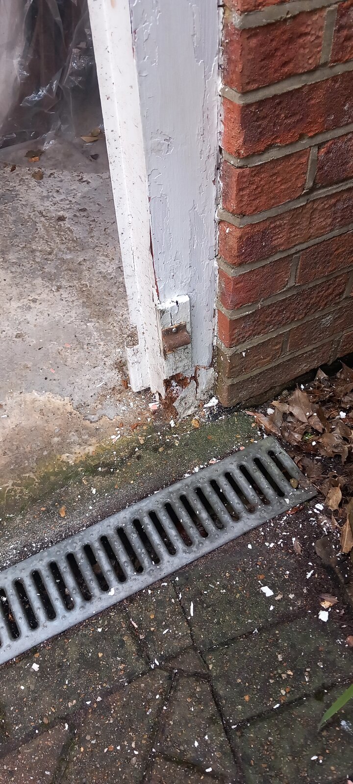

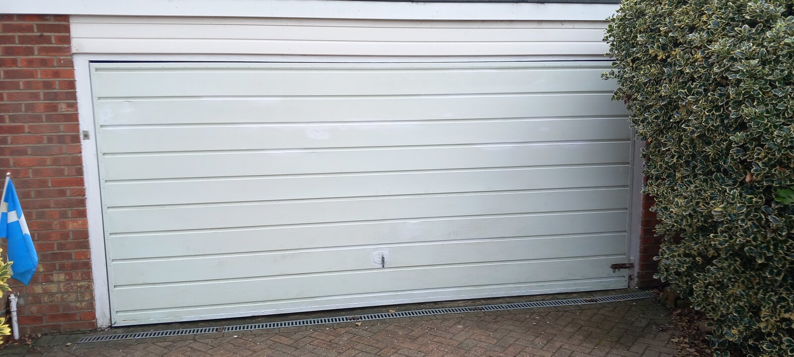

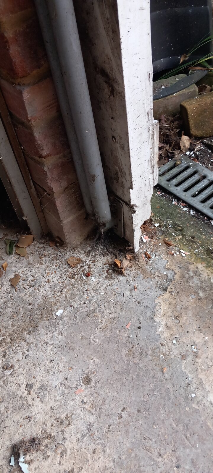

Want to cut out the bottom rotten part of the side post. Was gonna go wood or repair care or both. I noticed the back of thing supporting door is screwed into post and a screw or two into rotten part. Gonna use hand saw to cut it out. It's an electric garage door
Go for it, an angle cut is preferred to maximise the glue up area, but clamping the replacement piece next to the existing with an overlap will give you a good fit. Either way repair care and screwing/bolting the new piece will give a tidy sandable finish. Take note of where any hinges or furniture will go and avoid a join at that point.

I'm gonna need to put in 70cm. How do I cut the angle in. Is there a standard measurement for this timber? I measured 7cm x 9cm. Treated timber? I was told use framing screws used in pvc windows to attach it

If your skilled then with a hand saw, resin repair will smooth out the imperfections. Cut the angle on the new wood first and then use that to scribe against the existing bit of frame to be cut out. Leave a gap at the bottom to avoid damp.
Blup
If it were me, a DIYer, I would cut the existing post first, I think I'd find it easier to make finite adjustments to the replacement post if necessary, then just lop a smidge off the bottom for the gap.

Local joiner would cut plane a piece to size and cut the angle for scribing. Not treated wood though
