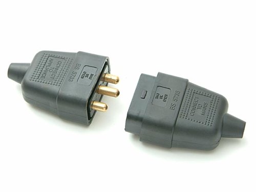

repairing lawnmover cable
Personally I don't mow my lawn in the rain and my sockets are all RCD protected so I used a rubber plug and socket like this
not strictly correct as the earth pin is not used but good enough. The lawn mower type
would be better I use it to give me a little more length.
Nothing wrong with the one you have selected except rather expensive.

Thanks. Any idea where can I find this? Our main consumer unit is protected with RCD.
Two pin or three pin.
Personally I prefer to use 3 core cable even if the mower does not need ( or MUST NOT have ) an earth connection.
With the earth conductor in the cable there is a better chance of the RCD being tripped at the moment the cable is cut and before someone picks up the damaged cable.
The socket goes on the cable from the house. The plug on the cable to the mower. Quite a few people get that wrong,

Thanks. Stupid but do I need to "seal" cable entry as I am not sure if cable connector is small enough to properly seal cable entry... Thanks
Bernardgreen's comments are interesting. I was going to ask if it was better to have a 3 core lead so the RCD has more chance of tripping
No real benefit IMO.
The (orange) cable that you have is only two core, as are all supply cables for domestic outdoor tools when they are feeding a double insulated devices (like your lawn mower).
You would have to replace the cable, as well as the connector.

It improves the chances of the RCD tripping when the cable gets mangled, rather than having to wait for current to flow through someone to earth.
xyz - how long is the cable? Might be cheaper to replace it than buy a connector. Certainly be better.
I have to say that I'm with bernard and BAS here - and I'm actually moderately surprised that two-core cables are allowed for outdoor tools. As has been said, it's surely better to increase the chances of an RCD operating immediately the cable is cut, rather than waiting until a path to true earth (maybe through a person) comes into the equation?
Having said that, I have not gone around systematically changing the leads of all my garden tools to 3-core - but if/when, for whatever reason, I replace any such cables, I do replace with 3-core.
