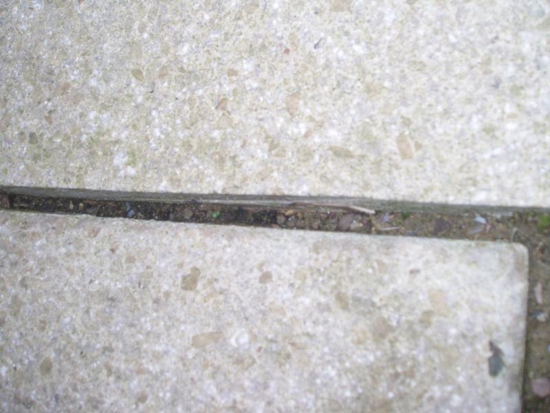

Hello,
We have lived in our house since the summer last year. At the end of the summer i jet washed the patio and noticed that the filing between the slabs (not sure if it cement or lime mixture) The filling was eroded away / missing in places.
I have inlcuded some photos, one shows an area with all the filling between the slabs in place correctly:
The others show where it is missing. In some places, the filling seems to have gone right away to nearly the base of the slab:
Can anyone tell me what i have to fill these gaps between the slabs with please?
Ps. the slabs look to be laid on a proper bedding with sand etc, it is just the gaps that i need to repair / fill.
Thank you!
Andrew

basically rake it out, use a damp mix of 1:3 or 1:4 of cement and building sand. ork it into the joints with a trowel or piece of feather edge. Then strike it off with whatever finish you want eg bucket handle. Leave it to go off then sweep off any excess with a dry soft brush.
Dont use ready mix and make sure you do it on a dry day or youll stain the slabs. If the slabs arent bedded securely then the pointing will break out again over time.
Thermo, if you dont use ready mix dont you have to buy a bag of sand & cement, that you hardly use.
bag of sand £2.00. Bag of cement £4.00 Total £6.00 Job done once and properly
bag of ready mix £3.50 falls apart and looks ****e. How much do you spend again in time effort and materials putting it right?
