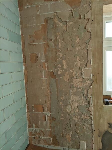

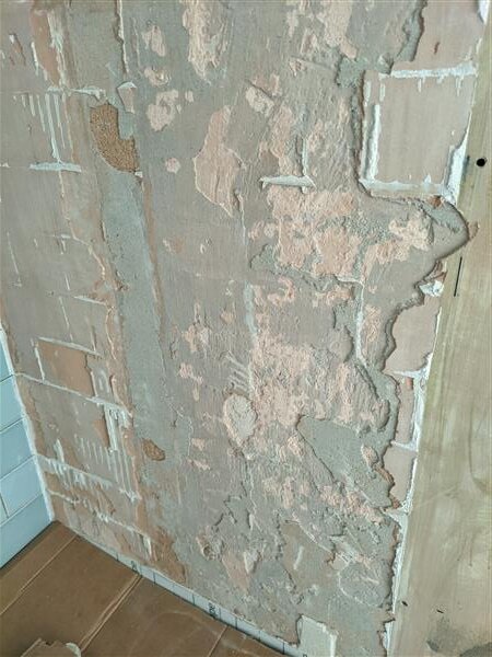

Hi all,
knocked a load of tiles off a plastered wall and now want to retile.
The tiles took off the plaster skim and is down to various layers underneath.
My current plan is to knock off any remaining loose/weak plaster then use 'thistle one coat' to build this area back out flat and level to the untiled bit of wall next to it, then tile over top. As I understand it the one coat will be a suitable substrate to tile on.
My question is - how to prepare the surface for the one coat plaster? I mean PVA - what dilution, how many coats etc. Do I put one on, leave it to dry then another just before plastering or something like that?
TIA.
