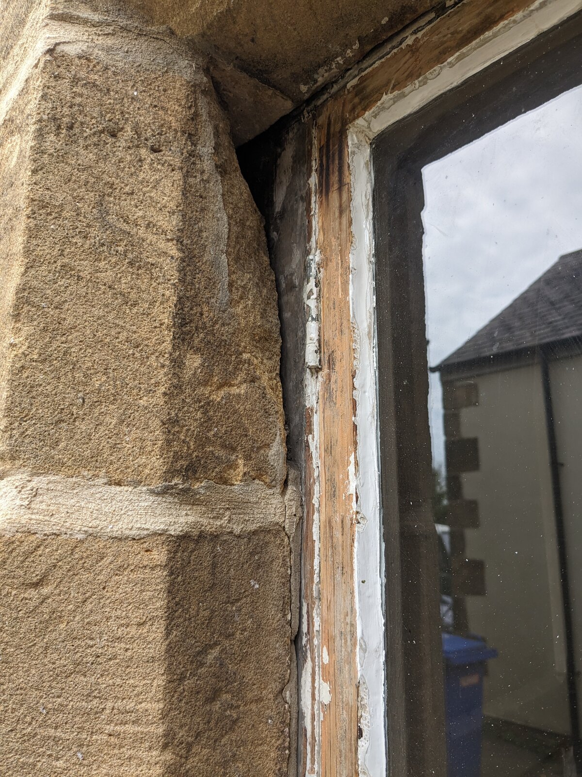

Hello! I'm in the process of stripping and repairing a window on our Victorian house. I've taken off the silicone sealant btween the wood and the stone and cleaned out the joint. A
a big chunk of stone has come away at the top corner and I'm wondering the best way to fix it back in again. I was planning to repaint the window with linseed oil paint and then seal the wood to the stone with trowelling mastic from MKM.
A 2 part epoxy resin glue should hold that in place. Don't glue it to the window though.
