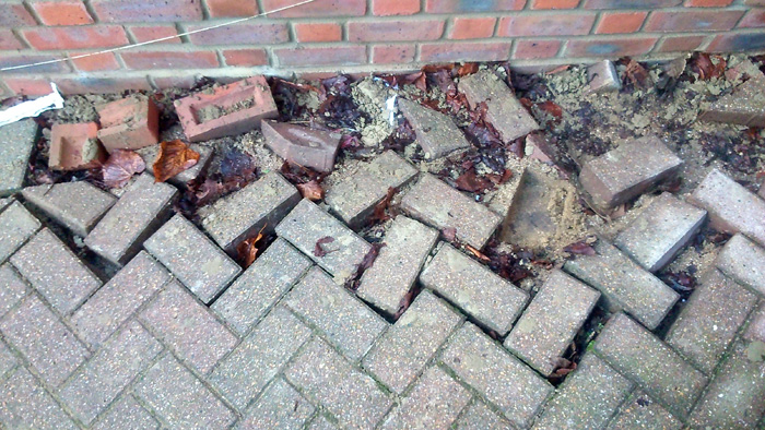

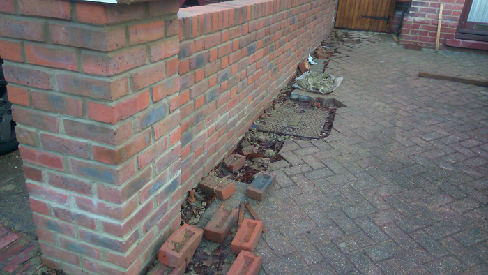

Have just built a front garden wall and the block paving needs repairing.
It will have mainly foot traffic in the area, but there may be times when a vehicle needs to stand there.

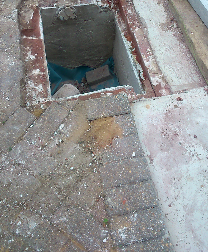

It had previously sunk a bit by thge old wall and drain.
Is it enough to level the existing MOT, put extra where needed, tamp down, and add the sand bed?
Or should I relay a whole new 100mm MOT base, then sand?
The rest of the drive is fairly even, so I don't want to have to do more than I need to, unless it would be better to re-lay.

Most likely settlement from the foundation excavation. Tamp what is there down well, add sand to build up the levels and then lay the paving.

The blocks moved because we removed the old wall against which they butted up to, and the new wall took a while to build. Walking on them caused the slippage

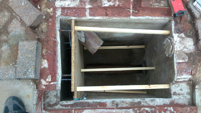

They were all in place beforehand, however there was existing sinkage in that area for which I suspect the main drain was to blame. The sides of the drain access were a bit suspect, and we shored it up before building the wall.
Same reply as above.
Plus I reinforced the bulging wall of the drain and put a concrete lintel into the cut slot at the bottom of this picture, as the original wall extended over that part of the drain.

Thus going on that premise (we have had no further blockages since said works), I am just looking for a way to put in a reasonable base.
If it sinks again, then no doubt I will be looking at an expensive digging up option.
I'd clean the leaves out and bed them back on some grit sand. I bet you could a manhole lid with blocks in it too.
