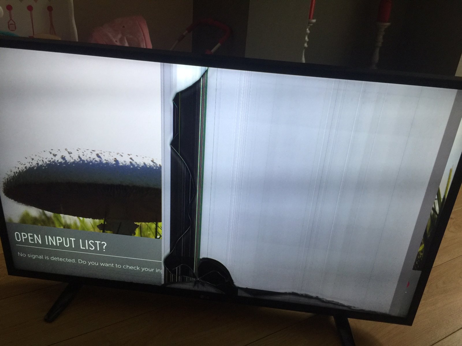

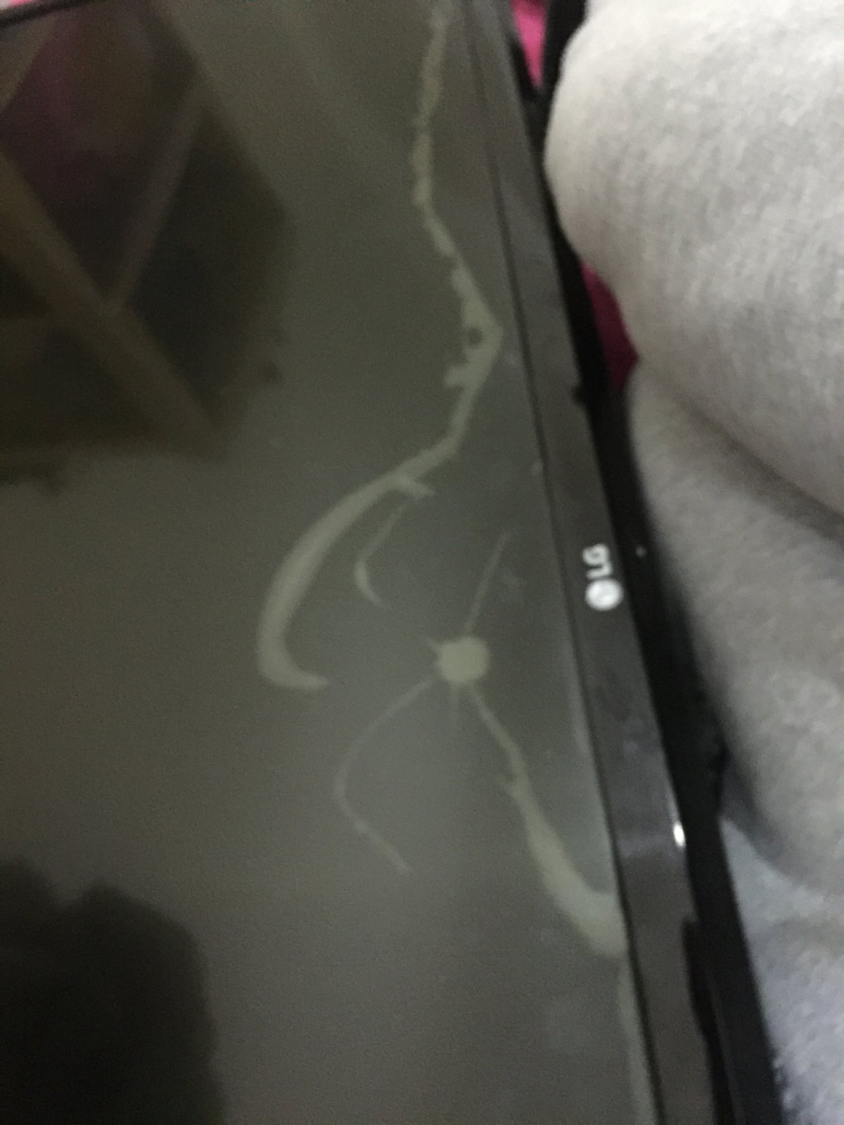

Hello I’ve got a TV which my child decided to throw a toy at it and completely smashed the screen. Half of the screen is now lines with a crack on the front of the panel. Being 1 year old is it repairable and how would I go around. The TV is LG 43 smart LED one.
Thanks.
its done. its claim or replace unless you can find a really cheap broken one with good panel on ebay
Thought so been looking for parts which are pretty much non existent and only other ones I can find at a reasonable price have a broken screen. Seems like be getting a new TV then.
Yeah sadly that's the case when the panel goes. That said open it up and take out all the little boards and wiring looms and eBay them. Do a bit of research so you know what you are listing as there are a few different ones such as tcon, logic which has other names and pay boards. You should get a few quid. Even the case stand and remote people lose and break so list the lot.
