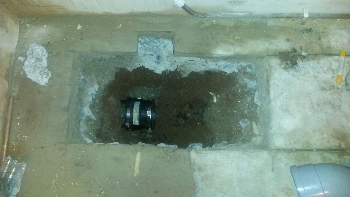

Moving WC/waste in bathroom.
We’ve unearthed and cut back the soil pipe as required. In doing so we’ve removed the DPM back to the edge of our trench (about 30 x 60cm). I’m concerned we should make good the DPM. I've considered removing more floor to expose good DPM so we can patch it somehow. But don't think we can without damaging the DPM we're trying to expose.
Is there any other way I can make good the DPM? Does it really matter? :cautious:
I imagine this is a common scenario. Maybe I’m googling the wrong words but I can’t find an answer anywhere.
The bathroom’s about 1.6 x 3.3m in a 1970-built extension. When finished, about half the width we've excavated will be tiled over - other half (to wall at top of photo) will be under boxed pipe work etc.
Grateful for any advice.

Why have you excavated? Was there a leak or are you repositioning the WC?
Does the soil pipe go on from the fitting thru the right hand side of the hole, or will it rise up on a ninety bend?
When i understand what you are doing i'll attempt to advise you.

Thanks for the prompt attention ree. We're moving the WC.
We've already cut out a section of the original soil pipe - the remainder to the right is now redundant, the pipe to the left in the photo (with the rubber connector attached in the photo) will be connected to rise 90 to the floor as you suggest, though we're using three separate connectors to stagger the rise so it comes up closer to the back the wall. The 'notch' in the trench is where the waste will come up to the floor. We need to do this to accommodate the new WC btw and this approach (i.e. staggered connectors) was best advice from the plumbing shop.

As I see it the big problem will be that your new pan will be sitting one half on the original concrete and a hallf on your repaired (made up) concrete. Sealing a patch of DPM around its edge to the old is easy, just use silicone goo. The difficulty is getting the underneath concrete to have a flat surface at exactly the right level. If the concrete in-fill is low, after patching the DPM, putting the screed on it will cause the centre of the DPM to drop and pull away at your new seal around its edge.

woody, Frank - I have no DPM protruding in some places so guess I'll just have to carefully break away more concrete and be careful not to damage it (DPM) further. Good point re. weight of screed of that. Maybe I can weigh the patch down with bricks to emulate screed load best I can before sealing(?)
The question was about how to repair the floor!
put the pipe in to correct position - concrete to level with existing concrete- 2 coats of synthaprufe, including up the cut screed - leave to dry - make good the screed.
I like your weight idea. I think it could be improved if the whole surface of the DPM was covered in sand first, then loaded with as much weight as you can find. the sand will help to spread the weight over the whole surface. After a day the weight and sand can then be removed and the seal inspected. use a vacuum cleaner if required to remove last traces of sand if required.
Because of your rubber joiner, the earth and the concrete can not be thumped down or the rubber bit will collapse. so just fill the hole with sand over the depth of the pipe and tamp it gently down. I think I would try and bond the new concrete to the sides of the old concrete. One very good way, but difficult, would be to drill pairs of holes opposite each other on both "walls" of the old concrete, say 6mm diameter, 20mm deep. Get some 6mm rebar and cut it the width of the big hole plus two times 20mm. Bend it into a slight curve and try and get both ends into opposite holes. Then place a piece of wood under it get the top of the curve on top and clamp it down to the wood. With some luck this will drive the end of the rebar further into the holes. Repeat every 2" (!!). It would be good to have some cross wire too. The whole procedure is to discourage your new concrete plug from sliding down the hole. An alternative approach could be to cut a series of horizontal groove in their walls about 1/4" apart and 1/2" deep, use a chisel to knock the saw cuts into 1/2" wide grooves and use these to support the ends of the rebar.

Cut 200mm polythene skirts and lap them under the slab and over the existing DPM. Then fold them down after infilling the hole, and lay another piece of polythene over the skirts and tape the lap.

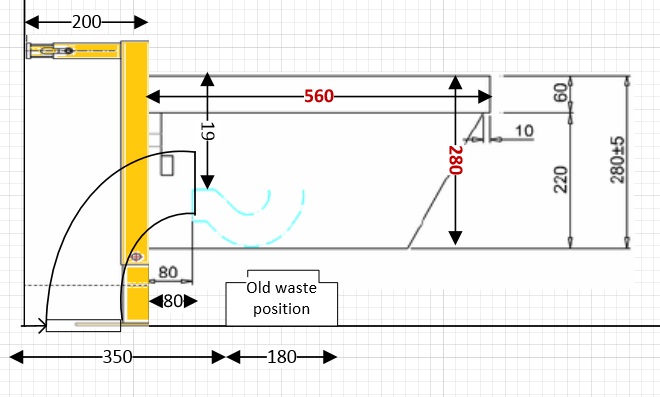

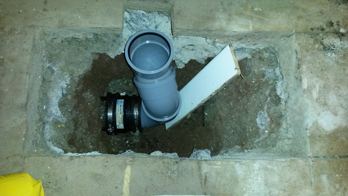

ree - I'm attaching another photo to show (roughly) how we come up and move back. Please note I've just cobbled together quickly to demo - final version will come up where we need. But the flexi connector was for pan to floor. Have one plumber friend who says flexi connectors are nasty for WCs in general (stuff gets stuck) and another mate who says that's not a problem! Tips re tightening the jubilee clips and blocking old pipe useful/noted.
WC: http://tinyurl.com/hvaa4k9
General point - I'd planned to back-fill with pea gravel (rather than sand or soil), topping with concrete and screed. Not sure if pea gravel's easier or not to tamp(?)
In the photos you can just about see some concrete in the trench bottom (top left). This seems to be the wall foundation. If this extends under the connector I could maybe whack some mortar under the waste/connector to provide support (once in place and tightened obviously). Can't inspect atm.
Another photo and WC plan attached.
