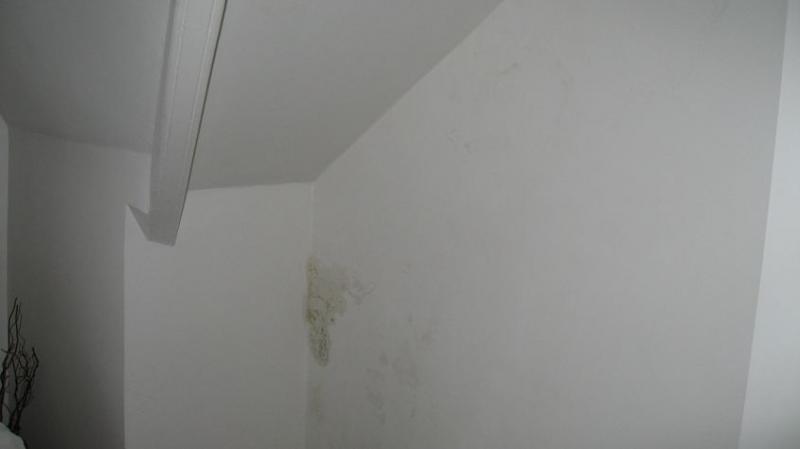

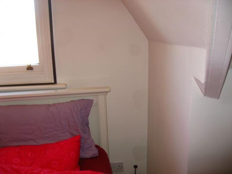

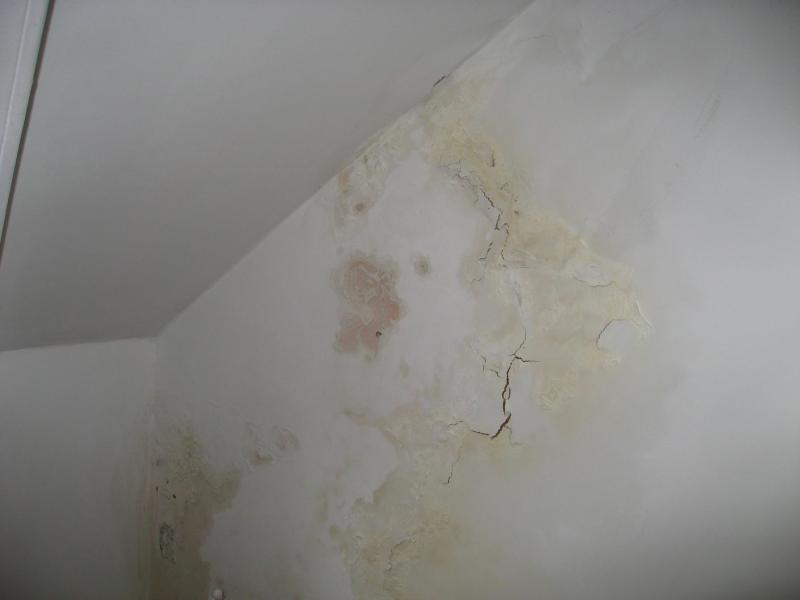

I have had damp coming through the wall in the bedroom under this parapet for several years.
1 years ago, I paid someone £300 to grind out the cracks and seal over. It helped for a while but pretty bad got worse again.
Over the winter it just went crazy and damp and mould spread all over the wall.
Last month I paid someone £600 to grind out the cracks, take off the top of the parapet, rerender, and reseal.
But after last weeks rain, it seems new dampness is coming in - says the lady in that room.
I am almost freaking out, I just don't know what to do. What am I supposed to do ? I am just throwing money out of the window.
Anyway, I will get that roofer back to have a look.
What should I ask him to do ? Put a whole new roof on ? It seems it is impossible to tell where the water is coming from.
I feel in a real mess - I have no idea what to do.
(this picture is before the last months work)
(this picture is what the interior looks like - I am supposed to be renting out this room)

Just looking again at the photos and dates it is certain that the water is still coming through.

The roofer came back today and had another look at it. He said he couldn't tell for sure where the leak was.
He said that at the bottom of the valley the tiles do not come all the way down over the lead, and that the bottom most tiles have about 1.5" overlap only and that possibly this is the way the water is getting in. But he wasn't sure.
Another possibility was that the fibreglass channel in the valley and lead interface was not good because the lead was just sitting on it, although there is a W shaped border to the channel.
I agreed to ask several other roofers to look at it and get their view.
And another option is to strip the roof down which would take a number of days.
And the original builder said he would fix it for free if it was quick, if not then we would have to negotiate more money.
Not sure what to do. I paid £600 and nothing has changed basically. I am trying to be practical.
