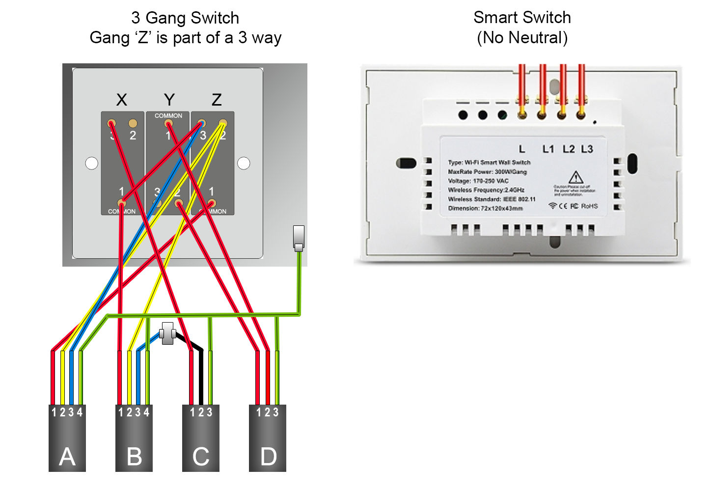

Hi all,
I recently swapped my living room light switch which was a 1-gang basic light switch, and replaced it with a 1-gang smart switch. The wiring behind my light switch had no neutral wire, so I made sure I purchased the "no neutral" version of the smart switch.
Now I'm moving onto my kitchen light switch which is a 3-gang switch, but 1 of the switches is a part of a 3-way setup. I didn't expect the wiring to look so complicated (especially if there is supposedly no neutral wire). I was wrong.
I took the liberty to draw my current wiring in hope that anyone here can provide some guidance. I've taken the time to colour code and label the cables and connections so that I can avoid any confusion or misunderstanding. And hopefully any help provided can be easily translated because of this labelling.
The image also shows what the smart switch looks like, simply comprising of a 'L1', 'L2' and 'L3', and a 'L'.
Thanks for any help in advance.
In the main smart switches work as master/slave, and all switches in the two way system need changing. With the make I have only 2 gang available.
Thanks for responding, but I cant work out if you're telling or asking me something? Are you saying that in order to get this working I need to change the other 2 switches that make up the 3-way, too?
A standard 2 way switch has com, S1 and S2 a wifi has sensing (S) line in, and line out, still three wires, but completely different way in which they work, so both switches need changing for them to work. an example here.
