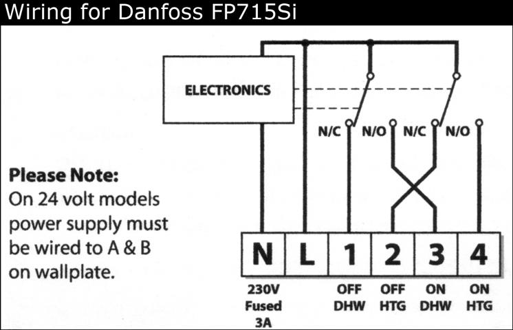

I have been browsing this site and noticed another post where someone replaced a Danfoss Randall 3022 with a Danfoss Randall FP715, the wiring is confusing me so could someone help me out with it?
Here are the two wiring diagrams for the FP715 and 3022 respectively:
The Valve Actuator code is: BGMVSP-2
tia
What other controls do you have such as 2 port motorised valves or 3 port valves 3 or 5 wire and what boiler.
And what terminals are used on your 3022
