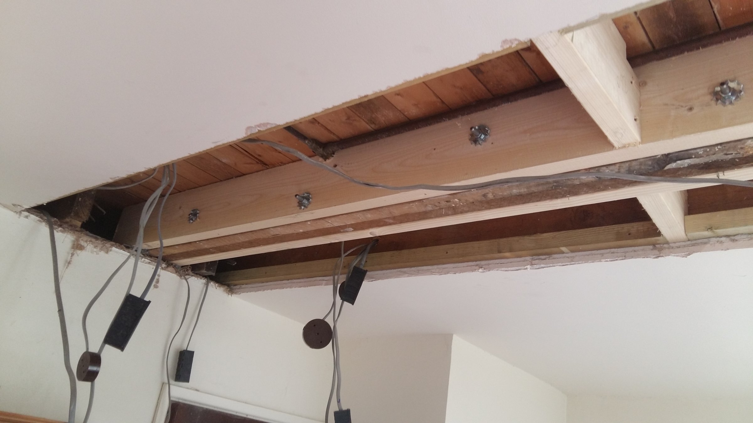

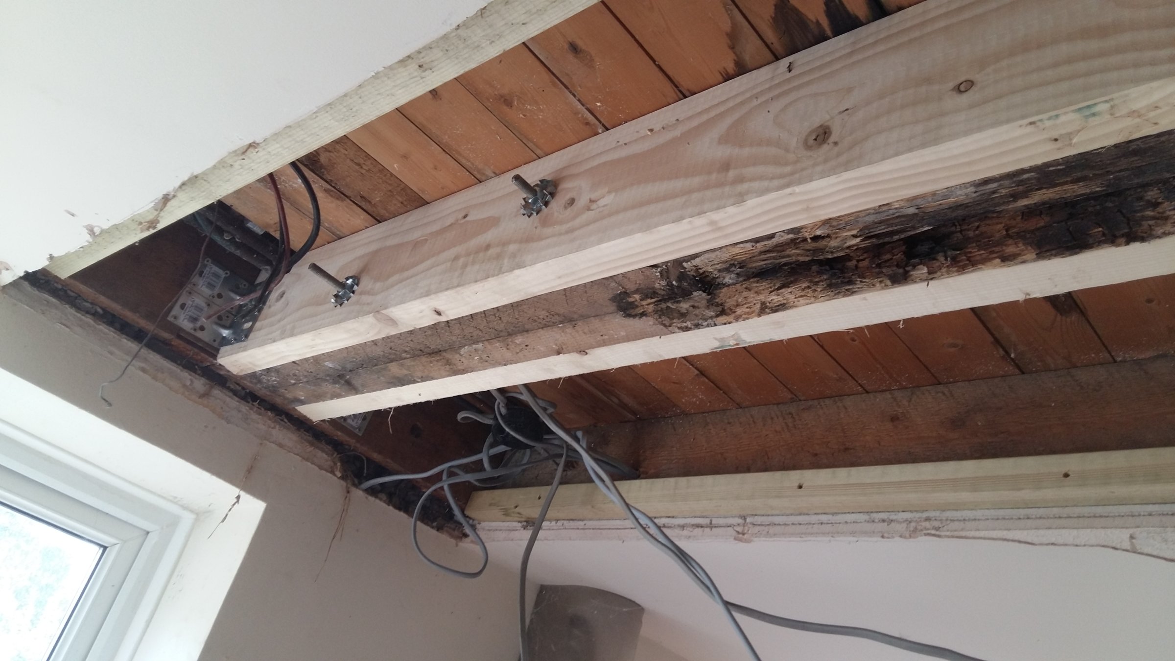

We were asked to do a job under insurance claim supervision., which involved a pair of supporting water damaged joists. The assessor suggested removing the bathroom and the partition wall sat upon it (separating the bathroom from a bedroom) and replace the double joists with new ones.
I said I would do the lot from below. Leave the exiting joists in place, sister up a new pair each side and bolt right through the lot.
Much more fun from below.......

Many thanks for this, most helpful. The idea of sandwiching the joist is interesting too... Assuming the other end is sound... But with it being the end joist parallel to the exterior wall there's only a 6-9" gap. My guy had thought about shortening the existing one and splicing a new length with metal plates, but couldn't see how to get access to the far side, is there a clever way?
Assuming I treat the wood, is there any harm leaving it in place if this makes things easier?
You can do it from below, but you can guarantee to asses the problem and damage completely. If there's no sign of water damage, then it may well be dry rot now, and that means spraying everything for up to a metre around the damage including the wall. Best to cut back the joist till you get to clean wood rather than just leave it in place. If the joist is by the wall, access is going to be restricted, but the loading isn't so great, so just 1 new joist should be sufficient, overlapping the old one by at least a meter and a half, and using 3 bolts.
