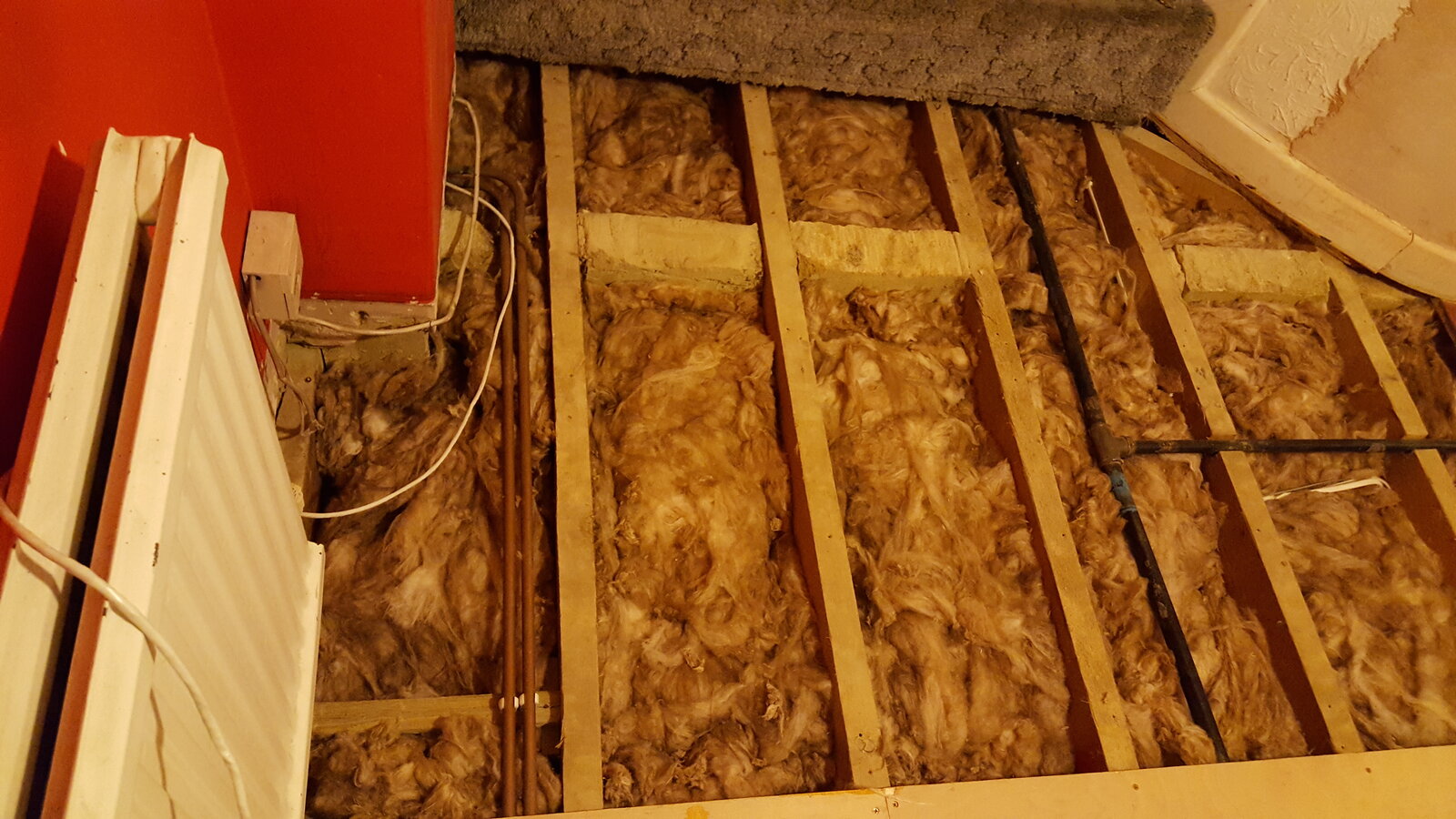

most of the cold from a wooden floor is draughts, not conduction or convection, and unless your boards are rather gappy, a lot of them come up the gap under the floorboards. you will see black stains on the wall and carpet edges where dirt blows up.
You can stuff mineral wool (loft) insulation between the joists, taking care not to obstruct airflow through the airbricks (clean them out). It is very inexpensive. Does not need to be cut precisely as it will stuff into irregular gaps. Even doing just the edges of the room will make a worthwhile improvement.
If you are taking up the boards or have access underneath, you can pack between all the joists. Clear up all rubbish from the void, and consider leaving a trap for access, well away from the door and traffic paths so it will not squeak much.
Ventilation of the void will also evaporate and blow away some damp out of the walls.
It is worth doing if you are getting under the floor for some other reason, such as plumbing and wiring, or throwing chipboard in the skip. people usually staple garden netting to the joists to prevent the wool flopping out of place.
Much less effort and expense than taking up the floor to lay concrete.
