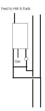

There's actually 3 water pipes coming off the boiler and a gas pipe.
Boiler bottom right pipe enters second pic top far left, and furthest right of the boiler goes to the top of the red pump in the second one.
The two pipes to the far right in the first pic are the same as the 1 in the second on the far right, the second is behind that wooden batton.

It would have been better to provide one picture showing the complete wall! Does the horizontal pipe at the bottom of picture 2 change direction behind the piece of wood and become the right hand pipe in the first picture?
Yes. It connects with a T peice. Those 2 pipes go down through the floorboards too.

Is this what the pipework looks like?

Yes, your diagram is spot on!
