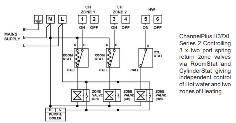

They are different devices and the wiring is different.
H37XL is a 3 channel programmer which as you can see below requires separate wired "room stats" and "cyl stat"

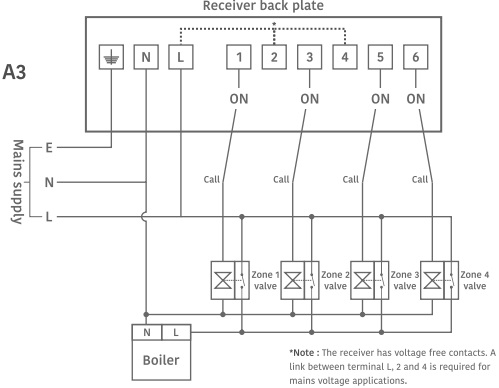

H3747 Is a 4 channel smart thermostat that communicates wirelessly with PTD's (Programmable Thermostat Display) There are no wired room thermostats shown on the diagram below the wiring goes directly to the zone valves.
To use the H3747 to replace the H37XL your system will need rewiring to decommission the old wired thermostats which will then be replaced with wireless PDT's. The old wired thermostats can't just be removed they need to be electrically bridged to complete the circuit.
So the question is what has happened to the old wired room thermostats and their wiring? If they have been left wired in as they originally were, you should find that turning them up to their maximum setting will allow the PTD's to control the heating. If they have been removed, then the wiring should have been modified to facilitate their removal.

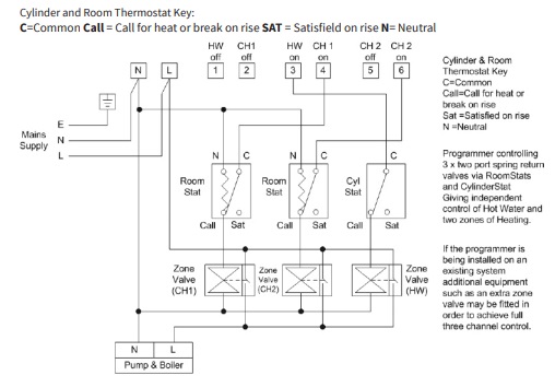

If the H37XL is faulty and you can't find a new one, as they are no longer manufactured, then another 3 channel programmer that requires wired room thermostats can be installed [i.e. not a programmable thermostat] The Sangamo Choice for example. The wiring terminals on the backplate are slightly different so some of the wires will have to be moved to different terminals, but that's all.

I can't give it a review I'm afraid as I've never used one, but interestingly the wiring diagrams look remarkably similar in style to the Horstmann programmers. :unsure: The terminals are in a different order, so some minor wiring adjustment would be required
Sangamo Choice PR3n Programmer.
Is the wiring as simple as moving the wires from 1,3 and 5 on the horstman to 3,4 and 6 on the sangamo ?
Yep, that's it.
CH1 on H37XL 1 = PR3n 4
CH2 on H37XL 3 = PR3n 6
HW. on H37XL 5 = PR3n 3
Assuming of course that your old wired thermostats are still connected as they were originally.
