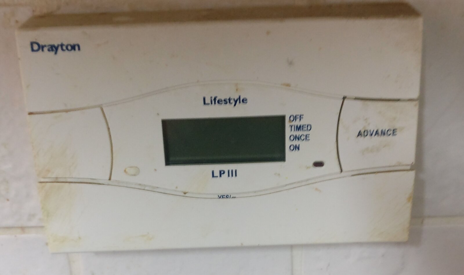

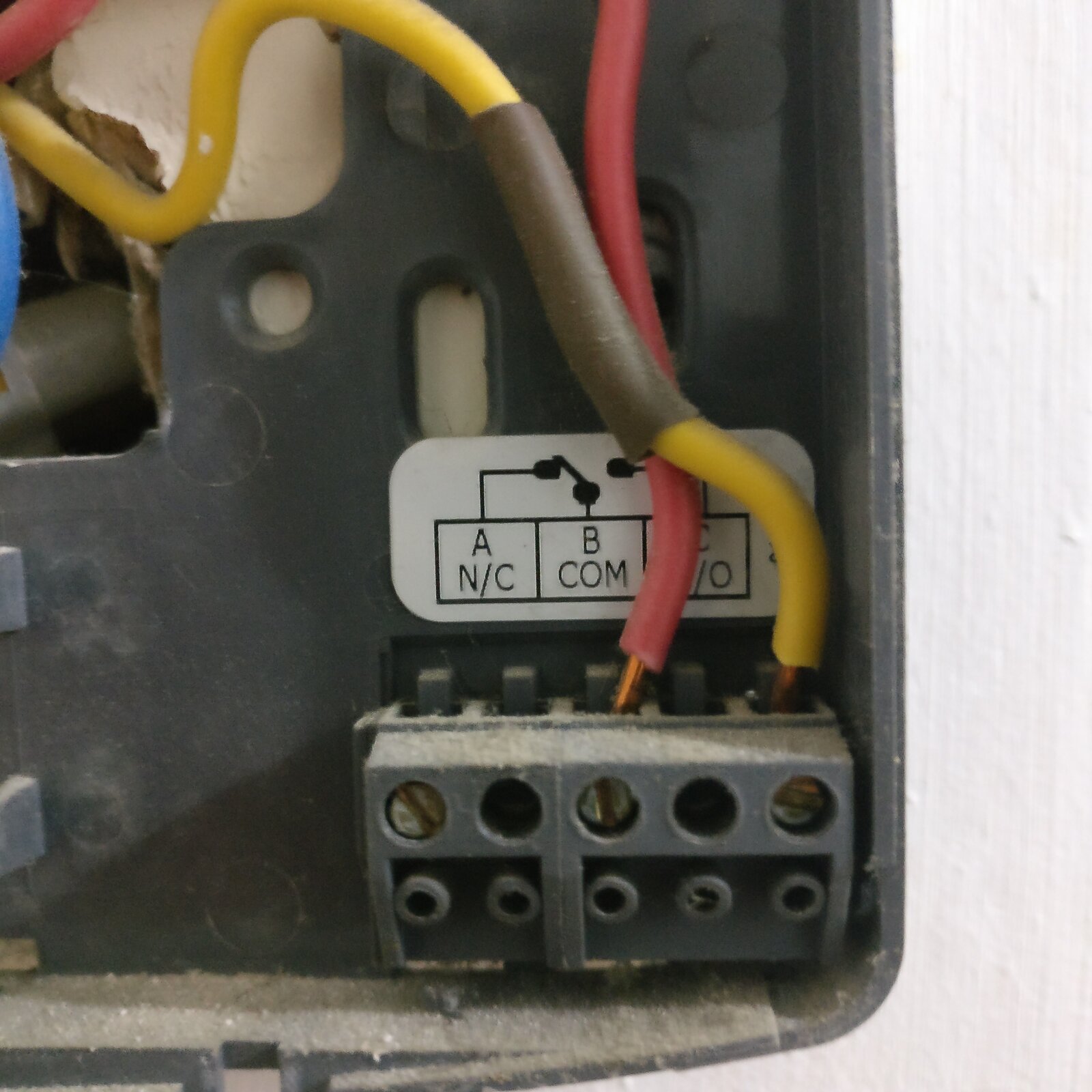

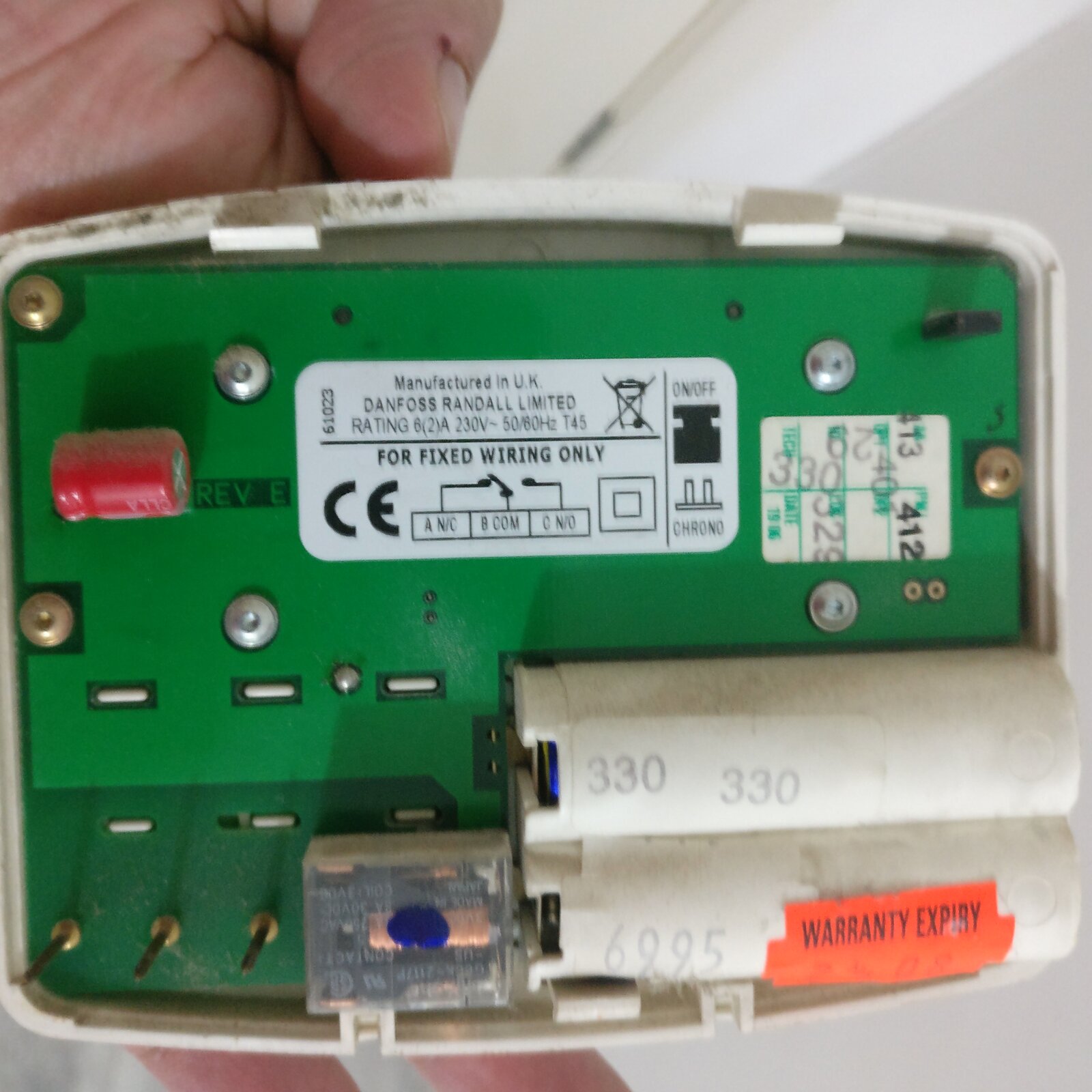

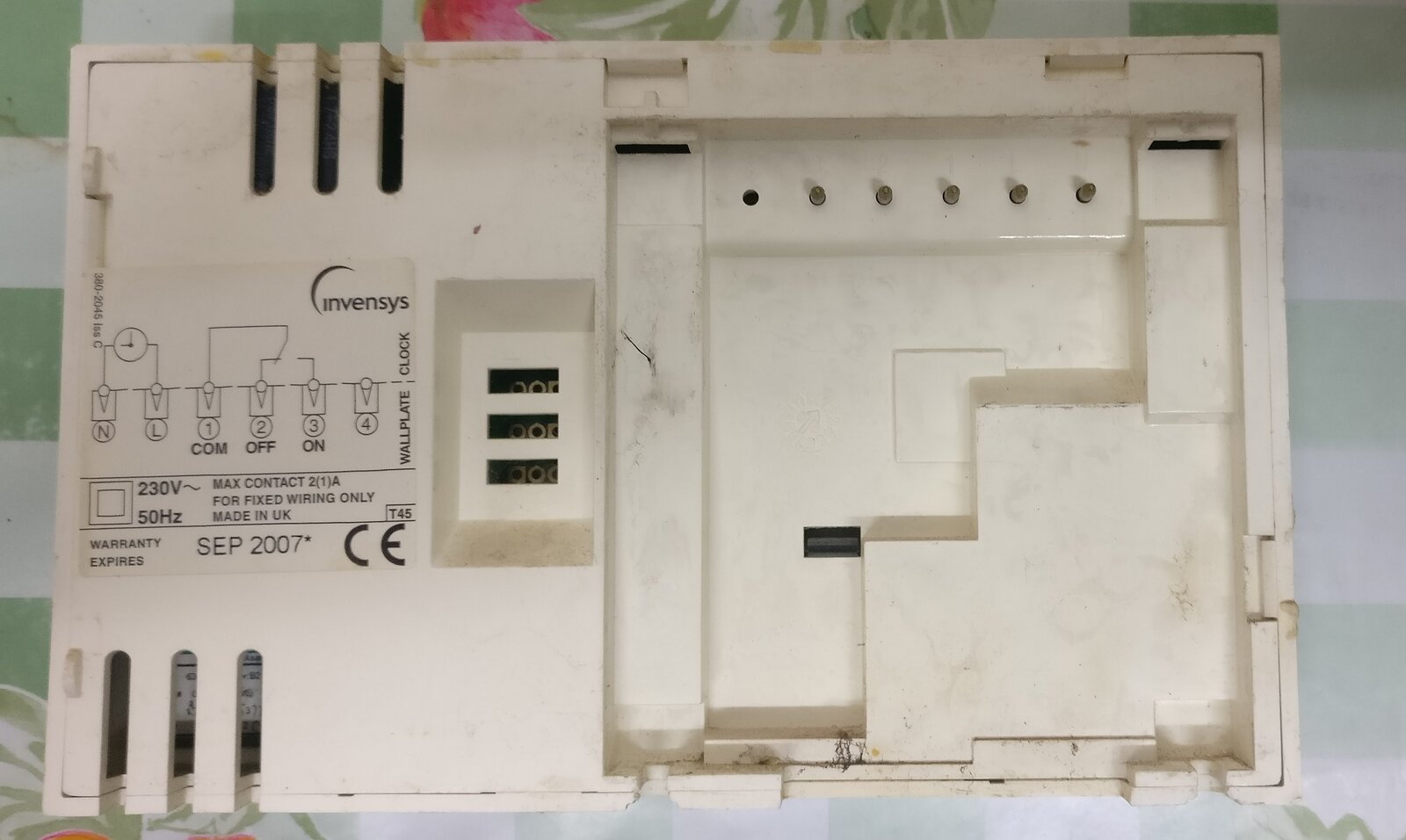

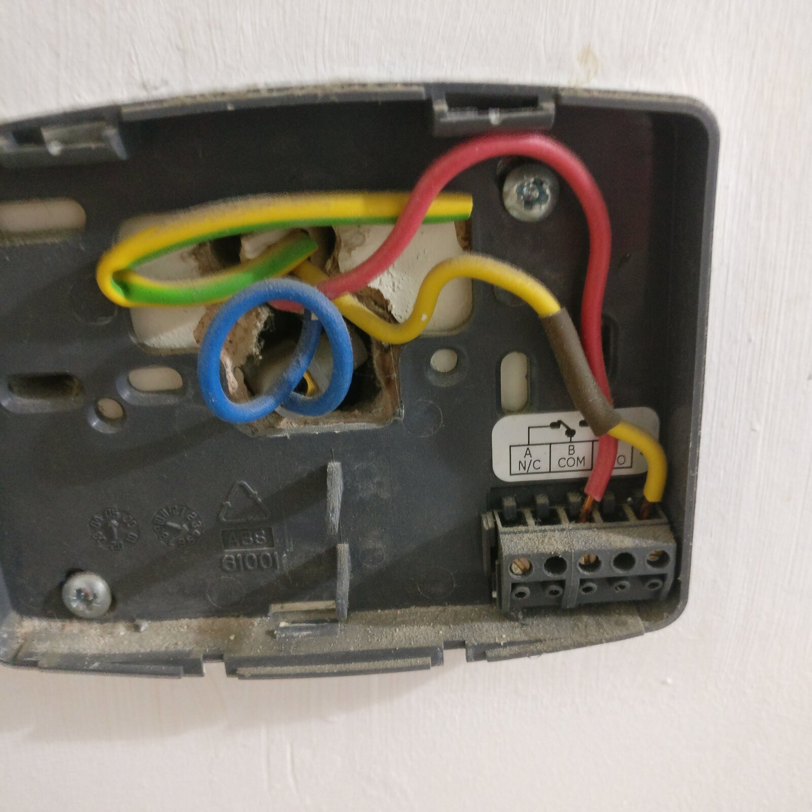

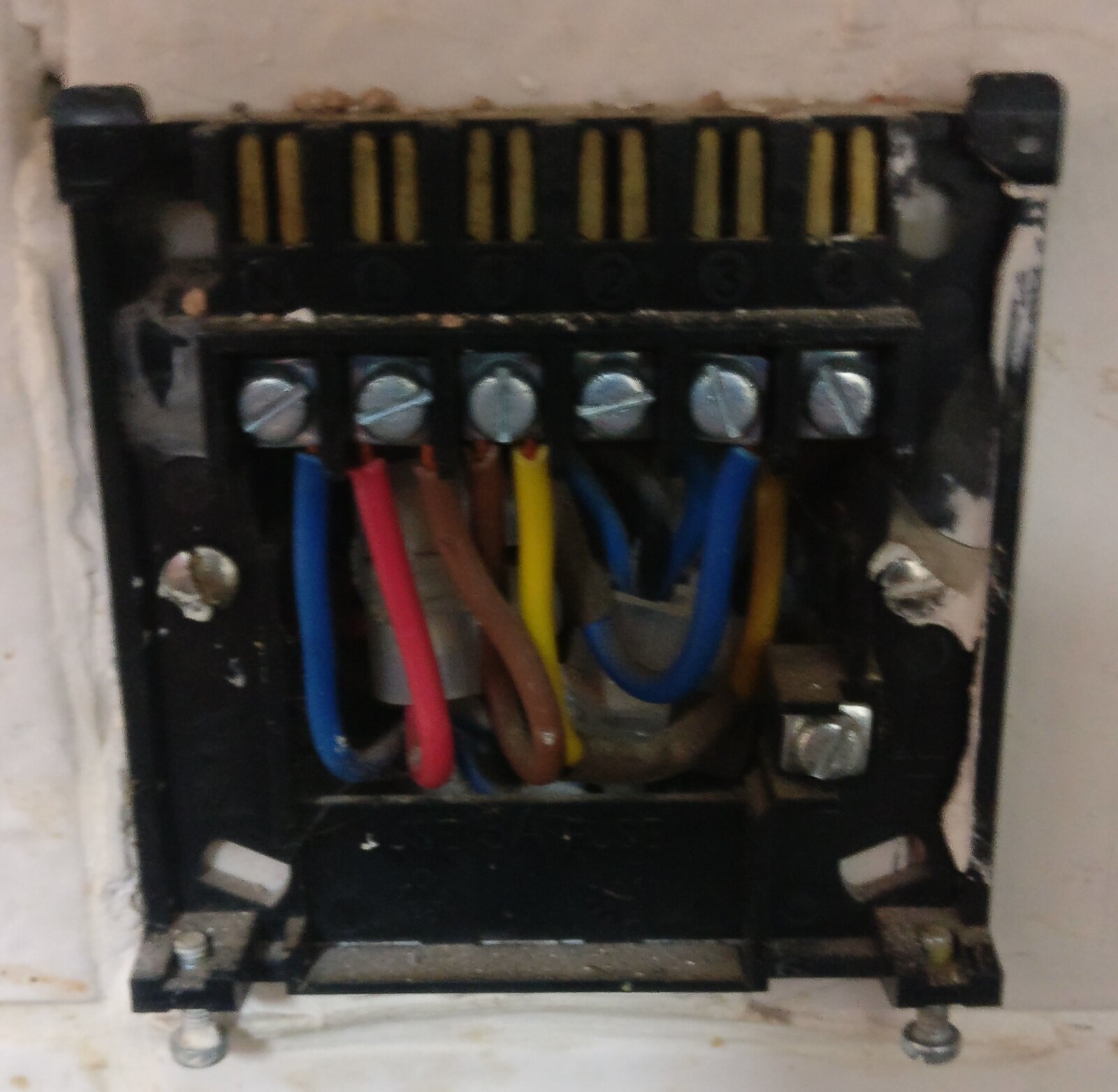

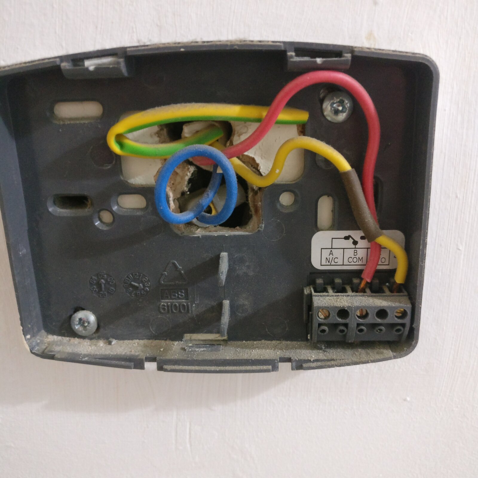

Hi,
My Setup
  • ideal combi boiler
  • Drayton Lifestyle LP111 (Heat water)
  • Danfoss TP5000 thermostat (Control Central Heating)
I would like to replace above system with smart.
Which device I need to replace Drayton Lifestyle LP111 with Smart and Danfoss TP5000 thermostat with Smart

Your Drayton is a time clock for the heating, nothing to do with hot water as you have a Combi boiler, this just sends on/off to thermostat, which is a thermal switch. Replace with your choice, but be aware that opening some boilers are a no-no for diy’ers.
And what do you mean by “smart”

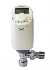

You beat me to it. I fitted smart thermostats to mothers house IMGP8035.jpg they connect to a hub which in turn connects to router and internet, it allows the temperature to be set to change at set times, but the much simpler thermostat EQ3-Straight-213x300.jpg also allows that, and the cheaper one also has a door open detect so it turns off the heating while I unload shopping, but it does not have the IFTTT (If this then that) options which the first has so can't be set to geofence.

You only show wall thermostat, in the main the wall thermostat is designed to stop a modern boiler cycling as warm weather arrives, they are put in a room normally kept cool (so they can detect warm weather earlier) on ground floor (as heat raises) where there is no alternative heating including sun through windows, and no outside doors. Don't know your house, but in my house no such room.
So we have to compromise, for example in the hall, but since hall does have outside door, we need to also have a TRV to allow fast recovery when door opened but not getting too hot so it closes down system, the relationship between the wall thermostat and the TRV can be simply using same program of temperature setting, but far easier to set up if they are wifi linked.

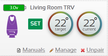

So a wall thermostat like this EVO-home1.jpg Evohome example allows you to set what the rooms do from either the wall thermostat or likely a computer or smart phone, but some systems only allow you to set with the computer or smart phone, this one IMGP8035.jpg is an example, this looks good on the PC TRV_report.jpg but you can't set up without a PC or smart phone, where as this one EQ3-Straight-213x300.jpg can use bluetooth but also can be set manually, plus I only paid £15 for them each, and they require no wiring you simply unscrew the original and replace with the eQ-3, the terrier i30 terrier-i30.jpg is the same idea.

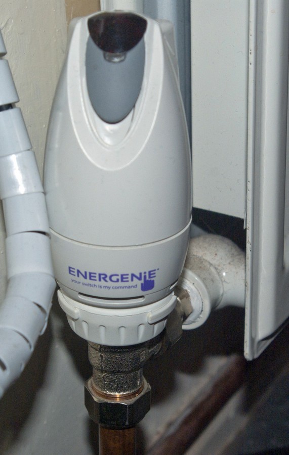

I actually fitted a Nest Gen 3 to my house, mainly as only two wires to boiler, and with two wires it could charge it and send information for domestic hot water and central heating with just two wires, Hot water boost.jpg it was claimed it worked with the TRV's I already had (Energenie) that was incorrect, it does not connect to any TRV and although may be great with hot air central heating or open plan house, it is not really much good with British system.

Ok. You have answered your own question. Either of those boxes of tricks can switch your heating on and off.
You only need a single channel device, to replace the LP111 and control the heating.
My question is that at the moment what I have can it be replace with smart system without any new wiring or modification to current system.

Hive only turns on/off, it will not work with OpenTherm.
Nest will not work with wifi links to TRV's.
Drayton Wiser will work with OpenTherm (with an add on module) and with TRV's
Honeywell Evo home also same as Drayton Wiser but the wall mounted bit allows setting the TRV's
EPH does not work with TRV's but does work with motorised valves and OpenTherm you set thermostats as master slave.
Tado not good at saying what they do, some versions do have OpenTherm and do work with TRV's
MiHome Energenie does work with TRV's but seems the wrong way around, wall thermostat tells the TRV what to do.
moes thermostat about the cheapest, many versions, think Zigbee, not really looked into them.
They can all replace the thermostat you have, and all have plus and minus features, you need to work out which you want, there is no best or worst, just different. Be aware some need a special hub, personally I would not use Nest however their Nest e is the only one where the base is battery powered, careful with moes as many versions some designed really for underfloor heating and the ebus used seems to be a commercial one so in UK simply on/off.
