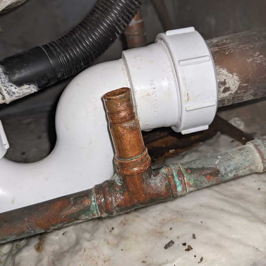

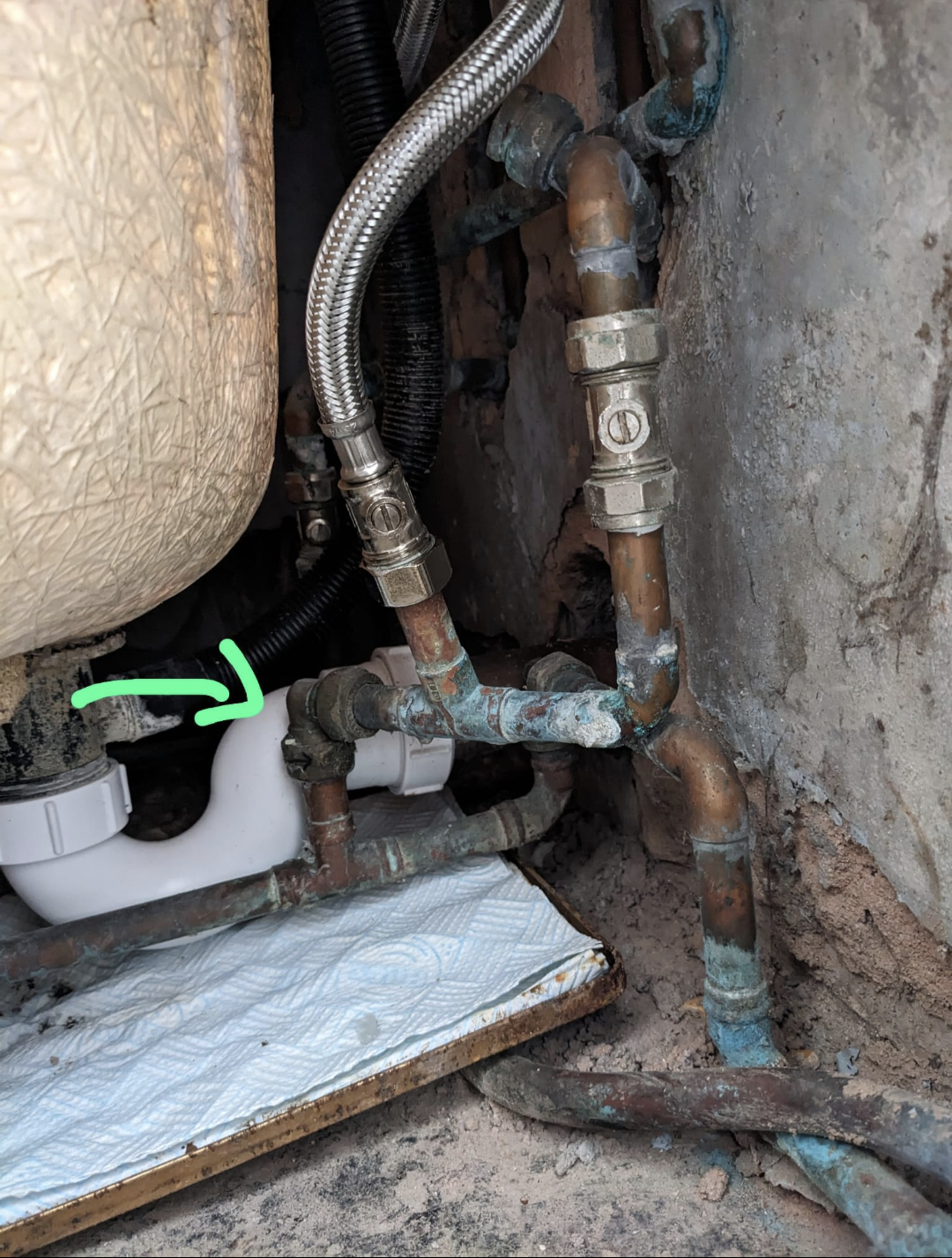

Hi. How do I replace this leaking elbow joint when the connecting pipes have no movement flexibility to go up, down, back and forth?
The challenge is, once the nuts are undone the elbow cannot be pulled back or lifted up because the connecting pipework has no movement. Any suggestions?
Thank you @HERTS P&D and @thomp1983. There was wiggle room! After wrestling the olive off, the pipe is largely squashed, likely causing the leak. Is this pipe salvageable or no good now?
You can "try" to remake it with ptfe wrapped around the upstream side of the new olive.
