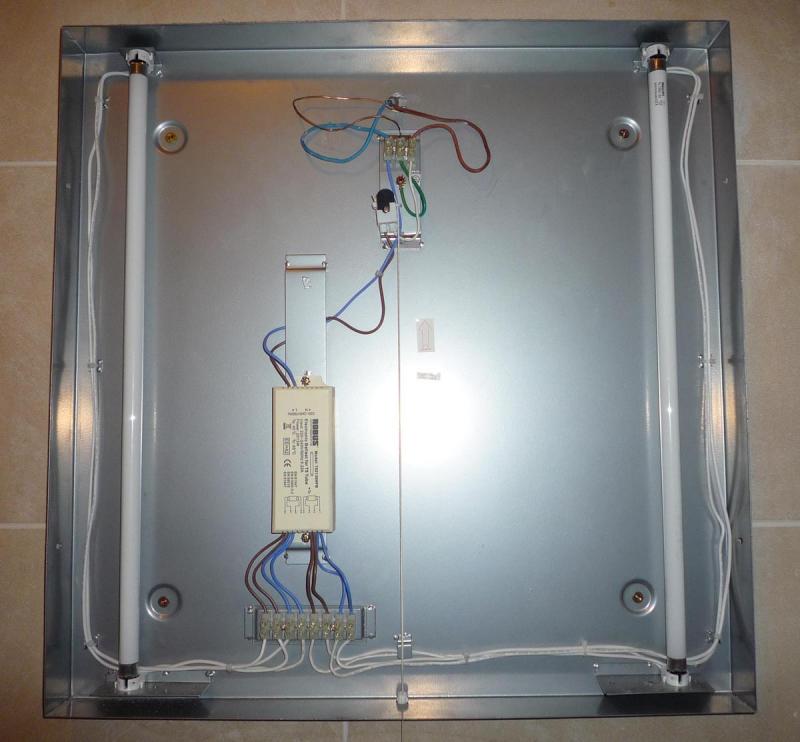

I need to replace the Electronic Ballast in the light fitting shown below as having already replaced the T5 tubes the light is still not working so I assume it's the Ballast.
I bought the Ballast below to replace it with

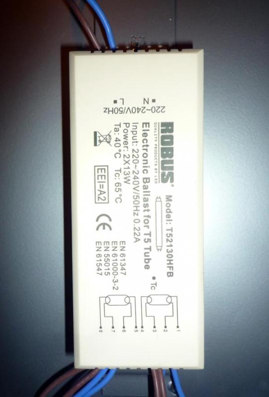

Specs for existing 'Robus' Ballast are:
Input: 220~240V/50Hz 0.22A
Power: 2 x 13W

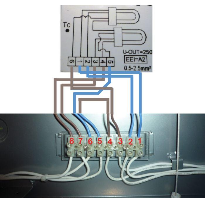

The problem is that the new Ballast has only 6 output wire points (numbered 6,1,2,3,4,5) where as the existing Ballast has 8 (numbered 1,2,3,4,5,6,7,8 )
Also I note the new Ballast has max 0.12A and the existing has 0.22A.
Will this work and if so how would I align the wires?

The wiring diagram is on the ballast unit, the only difference is that one of the wires connects between the two lamps as opposed to returning back to the ballast unit.
To link the two wires you can either join them in terminal block or you may be able to extract the wire from one of the lamp holders and wire the link directly between the two.
Using numbers on ballast old to new in following order.
1 = 1
2 = 2
3 = 6
4 and 5 connect together not to ballast
6 = 5
7 = 3
8 = 4
Note numbers are not in order.

Like the guy who started this thread I need to replace a ballast but can only find them with 6 out as appose to the 8 on my current. Can you please tell me the right way to rewire it please?

Wire it as per your original, but connect 7 and 8, to 1 and 2. So you should have two wires at terminal one, and two wires at terminal 2.
Note you'll need to use some connector block as you won't fit 2 wires into the ballast terminals.

I have never wired a ballast before, until about 3 weeks ago I didn't even know what one was. I genuinely find the diagrams confusing and I've got 8 wires that need to fit into 6 holes so I thought I'd be best to ask than risking it and damaging anything.
Not quite sure why I've felt the need to explain myself but there you go!
So it'll be
1,7 = 1
2,8 = 2?
Thanks for your help. :)
