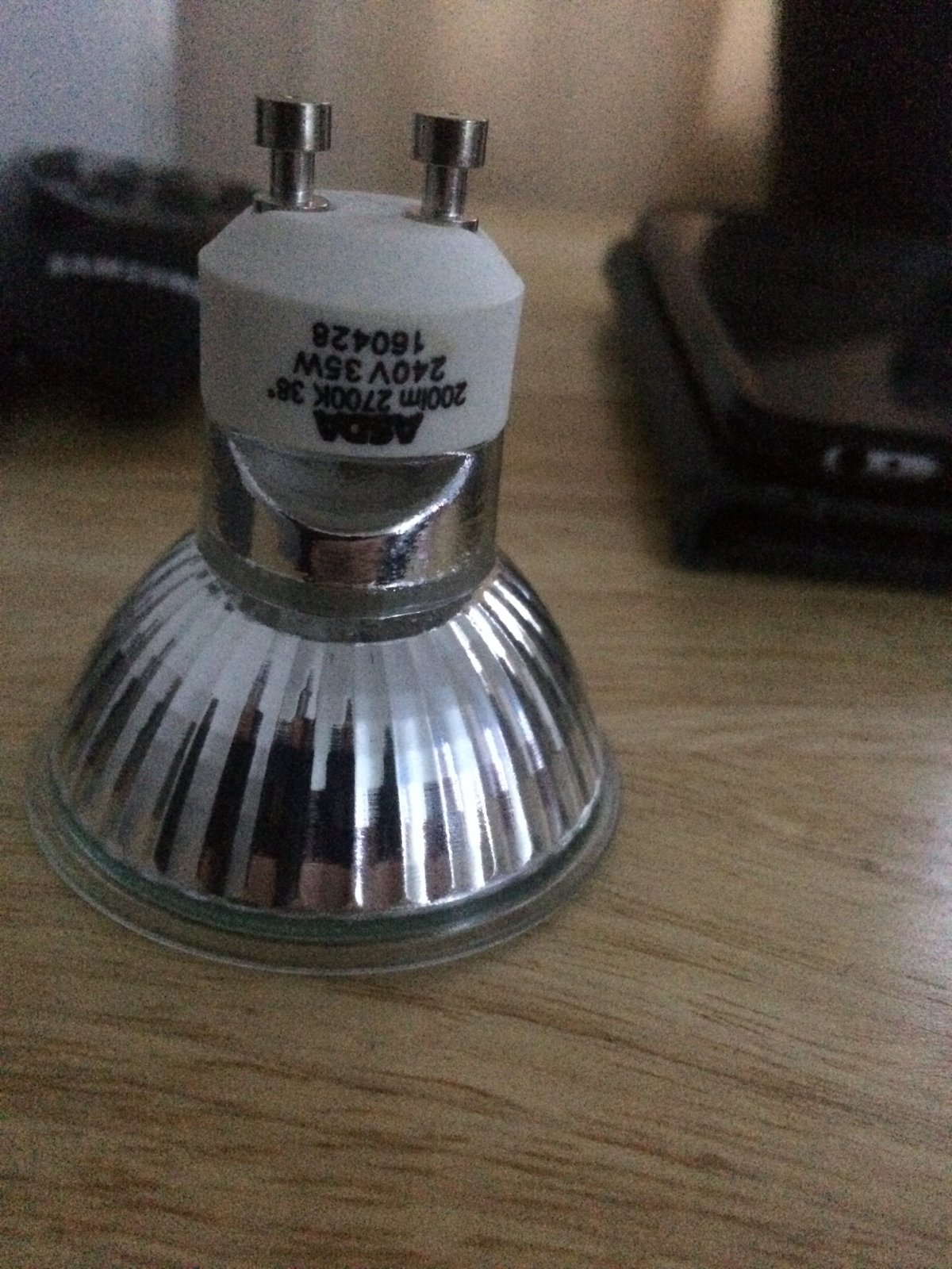

We currently have 10 Halogen spotlights in our living room. These are operated by a double dimmer switch, one switch operating 4 lights and one 6.
The dimmer for the 6 lights has stopped working and getting fed up with the frequency of bulb changing bulbs so we want to switch over to dimmable LEDs.
Would we need a specific type of double switch for these? Current one isn't working so would need changed regardless.
Can anyone recommend bulbs and switch for this?

Are they 12v lamps, or 230volts?
The easiest method is to use 230volts LED Lamps. So, if your existing lights are 12v, there will be “transformers” that will need to be removed, and you’ll need different lamp holders.
the existing 12v transformers are not designed to work with 12v LED lamps.
The lamps in your link are mains lamps with GU10 bases.
If you have a 12v system, the trannys will need to come out and the vases will need to be changed.

IMG_4248.JPG This is one of the current non working bulbs I need to replace.
I had 4 of these in a room upstairs which I swapped for LEDs and they seem to work fine. Although they aren't dimmable which is what I require in living room.
View attachment 179527 This is one of the current non working bulbs I need to replace.
As you can see, they are labeled 240 V and have GU10 Bases.
The ones in your link are dimmable replacements for these lamps,.

your current ones say 35w and your choice of led replacement implys that it is a 50w replacement so they may be too bright, but if you are fitting a dimmer not a problem
With your replacement dimmer switch just make sure it will switch an LED load as the LEDs draw a fairly modest amount of current (tiny) and most times with dimmer switches the emphasis used to be on how large a load they could switch eg. 250-400 watts, you're going to be switching probably a tenth of that.
Colour wise 2700K at 4 to 5 watts with a GU10 LED will be between the 35 and 50 watt 230v halogen equivalent, I tend to go with 4000K if I can get them for a bit of "Shock and Awe", one further thought and the LEDs don't get warmer looking as they're dimmed, unlike a tungsten halogen where they seem to descend into an orange gloom the LED seems to maintain it's colour and just wash out.
Thanks for all your help. Got 10 dimmable warm light LEDs from screwfix for £20 and a new Varilight double dimmer switch.
After a bit of faffing with programming the dimmer so it went down further all seems well!
