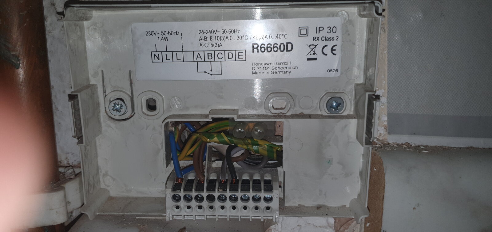

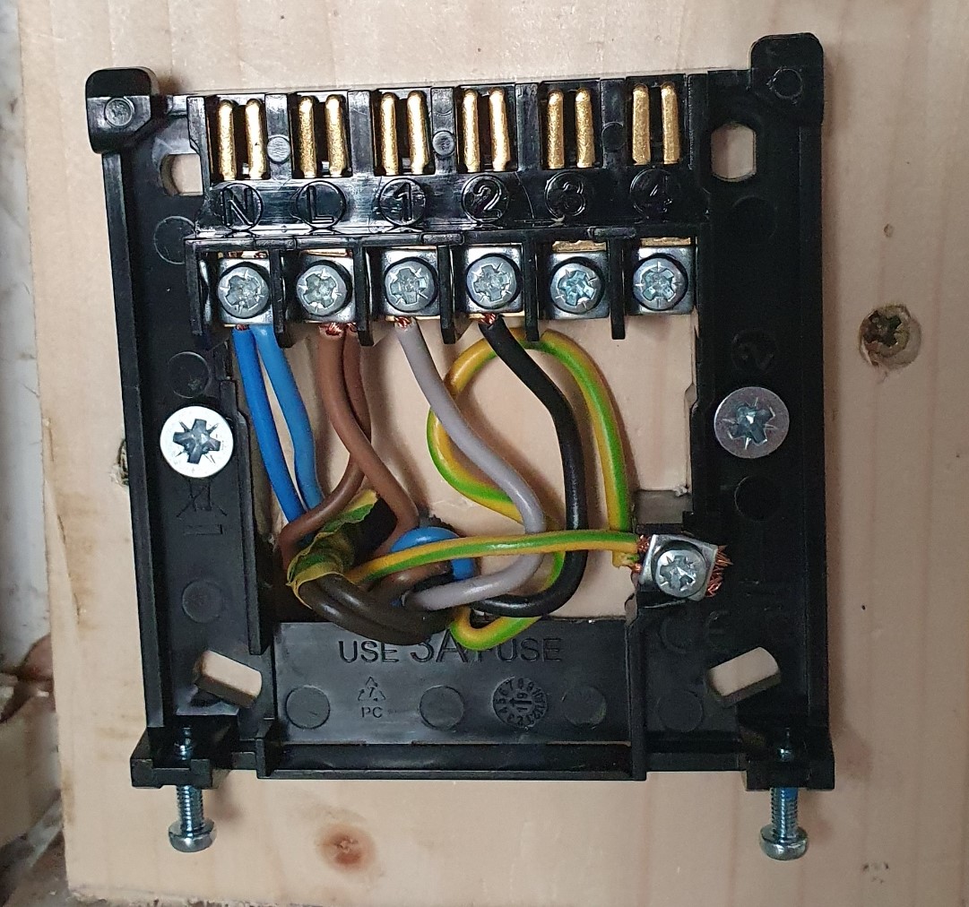

Hello, this has probably been asked a thousand times already, would appreciate a few pointers or corrections before I go ahead as I'm a little nervous although confident in the set-up.
I currently have a combi-boiler wired to a Honeywell R6660d Relay Box (thingy?!). There's a wireless Honeywell CM927 thermostat that allows me to control central heating and the programming schedule. There is no hot water cylinder as such, just hot-water on demand.
I'm replacing this with Drayton Wiser Multizone kit-1 (single-channel), product manual states it is for combi-boilers.
Is the following wiring method correct for transferring to the drayton HUB.
Honeywell ---------------- Drayton
N (two blue wires) --------> N
L1 blank
L2 (two brown wires) -----> L
A (grey wire) ---------------> 1 (COM)
B (black wire) ---------------> 2
C,D,E (blank)
