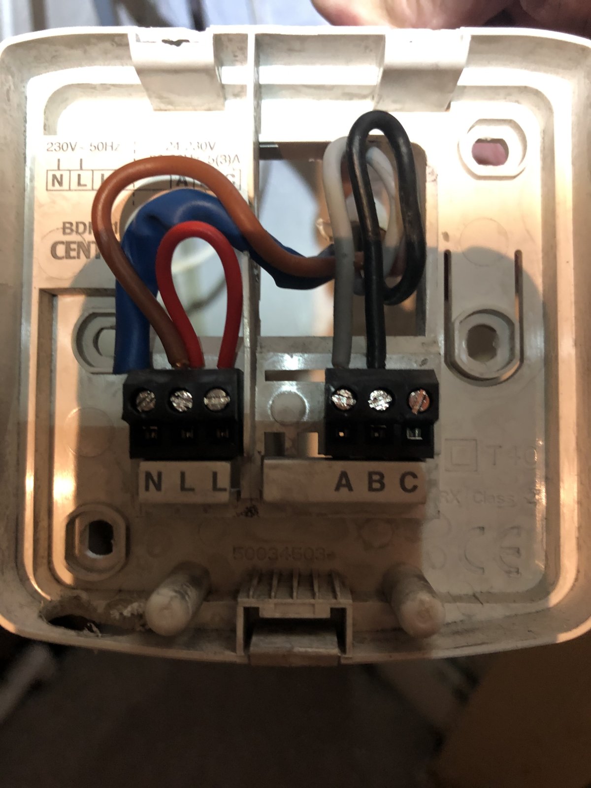

Please can someone put me right with this.
Trying to replace a Honeywell remote thermostat for a Hive single channel unit, what I don’t get is why is there a Live loop from Live 1 to Live 2 as described in the photo, would really appreciate if someone could explain to me where the wires in the photo go on the Hive unit.
Thanks in anticipation
I seen no reason for the loop, you don't say what the old thermostat is, but I would guess the two L terminals are so you don't need to loop, it would seem who ever wired it up has not read the instructions however to be fair neither have I.

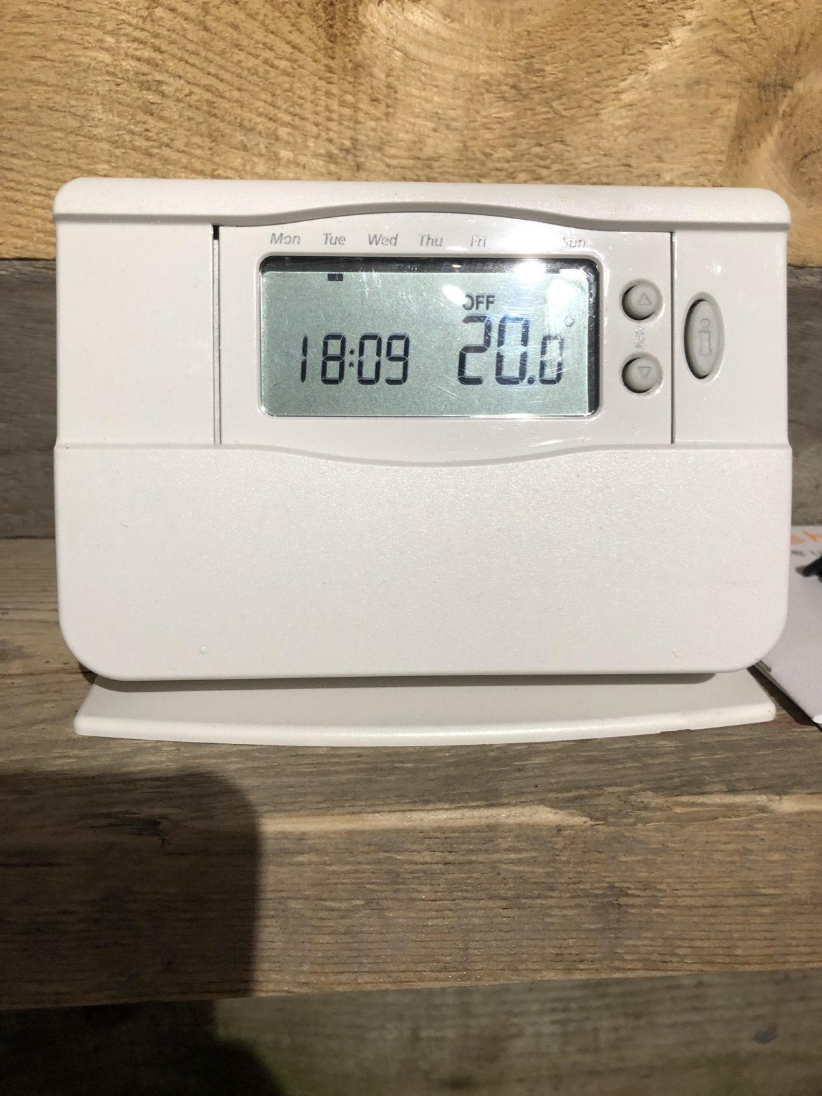

It’s a Honeywell although it actually says it’s a Builder Centre unit.
Are you able to confirm where all wires go from the old unit to the new Hive unit.

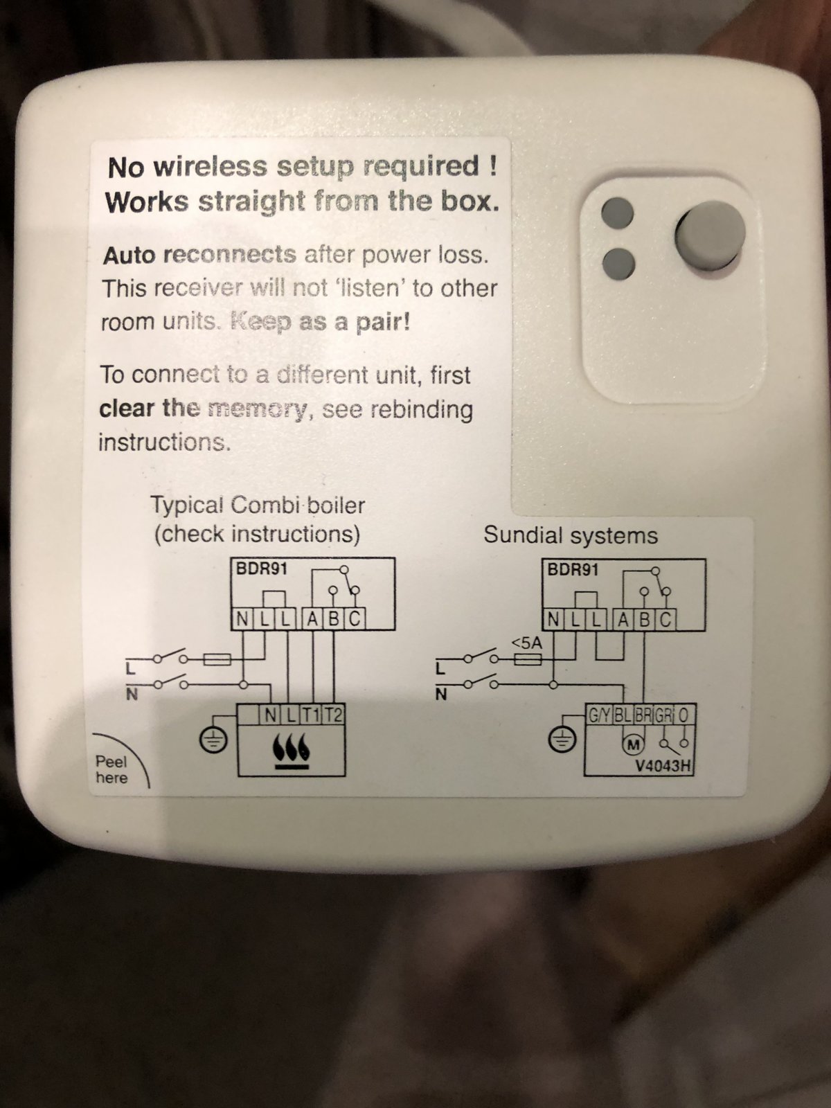

The picture showing sundial system confirms what I thought, the 2 L's are internally linked and is there for when you need to link line to the contacts, but you don't need to do that, so L to L and N to N and A = 1, B = 3, C = 2.
Hi, noticed later after you sent me the last thread that I don’t have a wire in C which would go to to 2 (Heating off) sorry if I’m being dim lol

Thanks for all your help everything is working a treat here now and I can go home to the island knowing he’ll be warm and snug in his new home.
