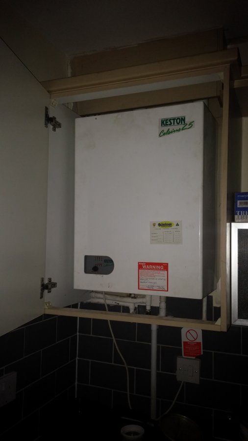

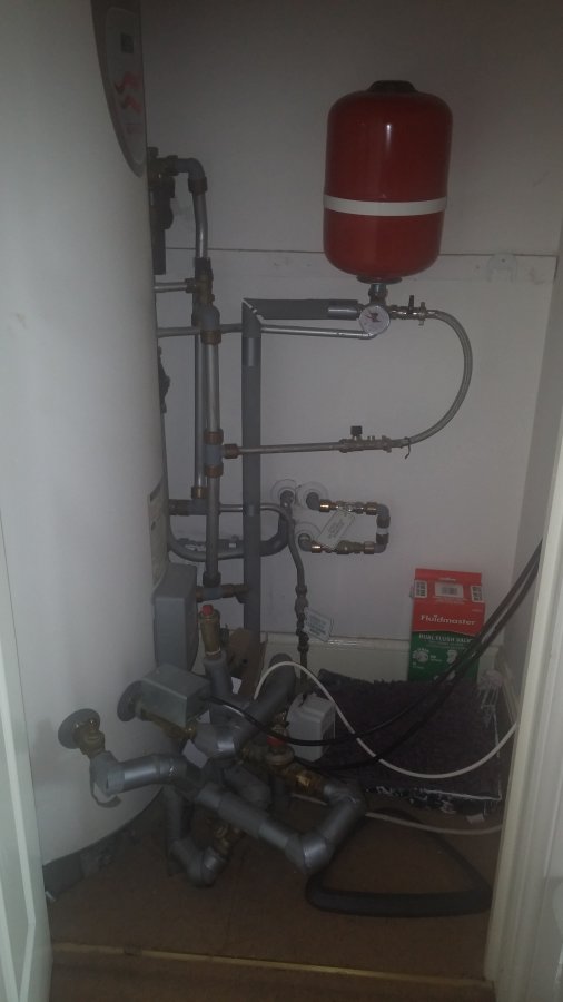

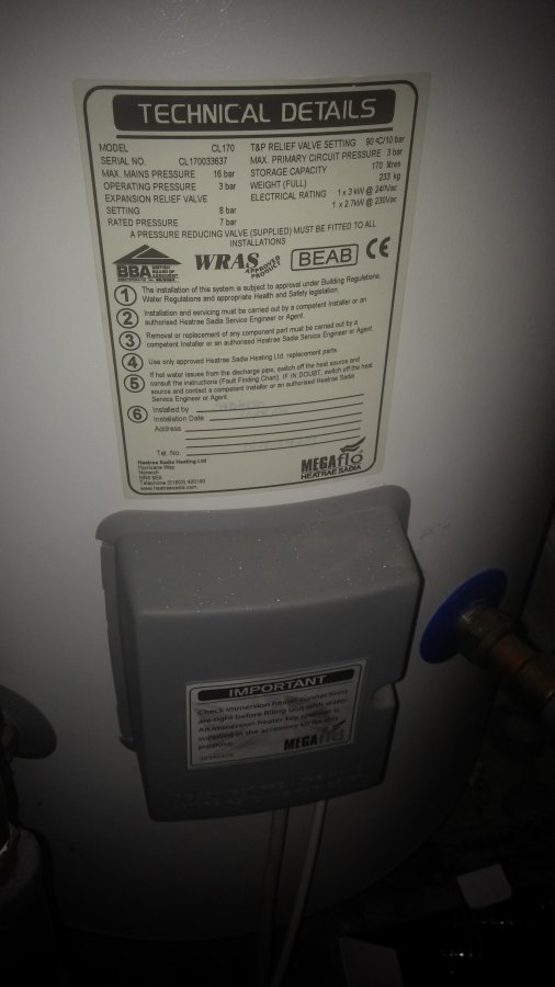

Our boiler has packed up, insurance cant repair as beyond eco repair (its a 12 yr old keston c25) any recommendations of good efficiency boilers my current setup includes an tank (un-vented? ) on first floor. What are best options to replace my boiler which can give me good fuel efficiency.
I will also like to reclaim the space where immersion tank is installed is that right thing to do, what factors do i need to consider before deciding? I have attached some pictures of current boiler setup

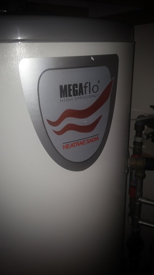

you would be ill advised to do away with your Mega flow, I would keep it and just replace the Keston, congratulations on getting one that lasted so long, they are absolute shoite dont get another, there are many decent replacements
Personally I'd keep the Megaflo, trying to change to a combi will reduce your heating efficiency and your hot water flow rate.
I'd replace with an Intergas HRE SB24, add an OpenTherm control for the heating (OT controls are more efficient than "standard" ones) and a cylinder sensor setup for the cylinder, which would give you ultra-fast reheat times on the cylinder combined with the highest efficiency heating system. 7 year warranty on the boiler, 10 year warranty on the heat exchanger although it's worth noting that the heat exchanger has been in service in these boilers for 20 years now and has never had a failure. You could also look at the ECO RF 30, which is technically a combi but will happily run as a system boiler and has a 10-year warranty on everything, plus an on-board RF chip which does all sorts of fancy things ;)

EDIT if your Keston is using their twin-flue system, you're going to need to change that whatever boiler you go for
yes thanks I missed that. My current Flue goes from kitchen into Ceiling via Living room and then out into Garden, Will I have to keep the same Flue route or reposition the boiler {which i prefer not to do }?
regards
Honeywell do good controls, and Intergas are soon releasing their own control too which will have a phone app with it. You could have a stat you can move around but they're best left in one place IMHO
The cylinder sensor would go into your Megaflo cylinder to sense the temperature and tell the boiler whether it needs heating up or not. Not essential, but can be handy
Without being able to see your house, I can't advise on the best flue route, but in theory you should be able to follow the route of the existing flue. Having said that, new regulations require every joint to be inspectable, so if you take it through the ceiling you'll need 300×300mm inspection hatches cutting into the ceiling so the flue can be inspected

Keep the Megaflow!
Tony
well, i am keeping the megaflow tank.
