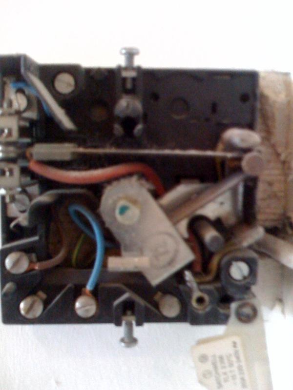

I have included a picture of my old thermostat, which appear to be wired differently but in a straight forward way
Terminal 1 has a brown (live connection)
Terminal 2 is either used or appears to have earth
Terminal 3 has a neutral connection.

Okay, so where we are at the moment is that the current satchwell tlx 2356 device looks like it has a live coming in to terminal 1 (brown wire), earth or nothing on terminal 2, a neutral on terminal 3 (blue wire), and I am not sure of what the other wiring is, and this is what I need to figure out. I put a multimeter on terminal 1 & 3, and get a circuit from these two.
Given the picture I have posted, the wiring diagram for the satchwell tlx 2356, and the wiring diagram for the new siemens rf device, can anyone help me decipher which wires in my picture, should now be connected where on the siemens device.
I would imagine for starters, terminal 1 (brown wire) on the satchwell, would go to the live terminal on the siemens, likewise terminal 3 (blue wire) on the satchwell , would go to the neutral on the siemens, but can anyone help with the other wires in the picture and which terminals on the siemens they should be connected to?

the blue is probably a switchlive, not a neutral. I don't know your stats config off the top of my head but it wouldn't work at all with just a L and N, so with two active connections they have to be L and sw L. Don't put too much trust in the colours, plumbers often use the earth as a live conductor, and believe phase sleeving is for poofters.

So from my pics, what would be your guess for connecting up the siemens, from the wires you can see in the pics... as you will have worked out by now, my level of knowledge will need an "blue wire to LX, brown wire to Neutral etc etc type explanation ;)
thanks
going by your stat's current connections, blue is live and brown is switchlive
or they could be connected the wrong way round.
there's no neutral there, and I think that model requires one.
I think you need a little investigative work to determine whats what, there's no simple "put this wire there" answer, unfortunately.
given your new one is a wireless, the receiver will be connected straight into the wiring center, so you won't use the old stat cable.
