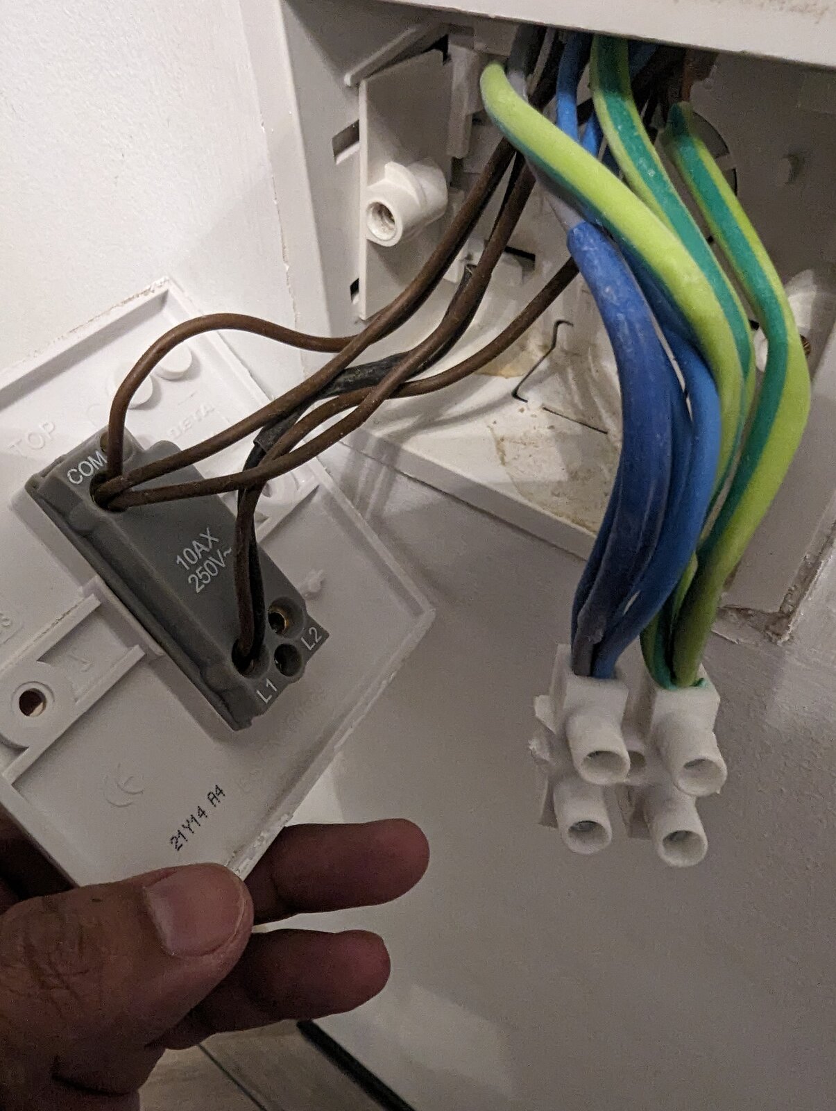

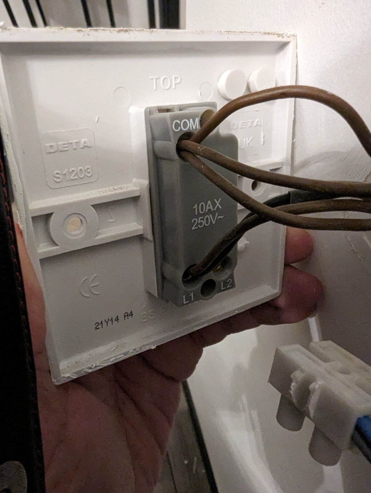

Hi all. I'm looking to replace a normal light switch with a pir switch on my downstairs WC, which also has an extractor fan that comes on with the light.
This is the switch I found and attached are the pictures of the current install.
Can it be done?

Yes it can be done.
3 brown in COM are permanent line
Brown and black in L1 are switched line
The blue wires in the separate connector are neutral.

@ericmark the problem I'm trying to solve is that the light is constantly left on. Any other suggestions?
It might be possible to separate the L`s and the N`s for the extractor and for the light.
Therefore you could have a PIR switch for the light only and a manual switch for the fan only
I have one in my downstairs wc. For exactly the same reason (light always being left on)
I just need to wave my hand if I sit too long!
Hint. For small room
Set PIR time for 10mins. Set fan timer to minimum.

What's your view on installing ceiling mounted pir between the switch and light (instead of the pir switch)?
It depends on the wiring. Looking at the switch, you may not have all the connections that you need at the light. You’ll need a perm live, switched live and neutral. The fan will have those connections but you may need to do some configuration of cables.
Sounds like I'd have to get someone in to do that. I'm thinking I'll try the switch you've suggested first.
