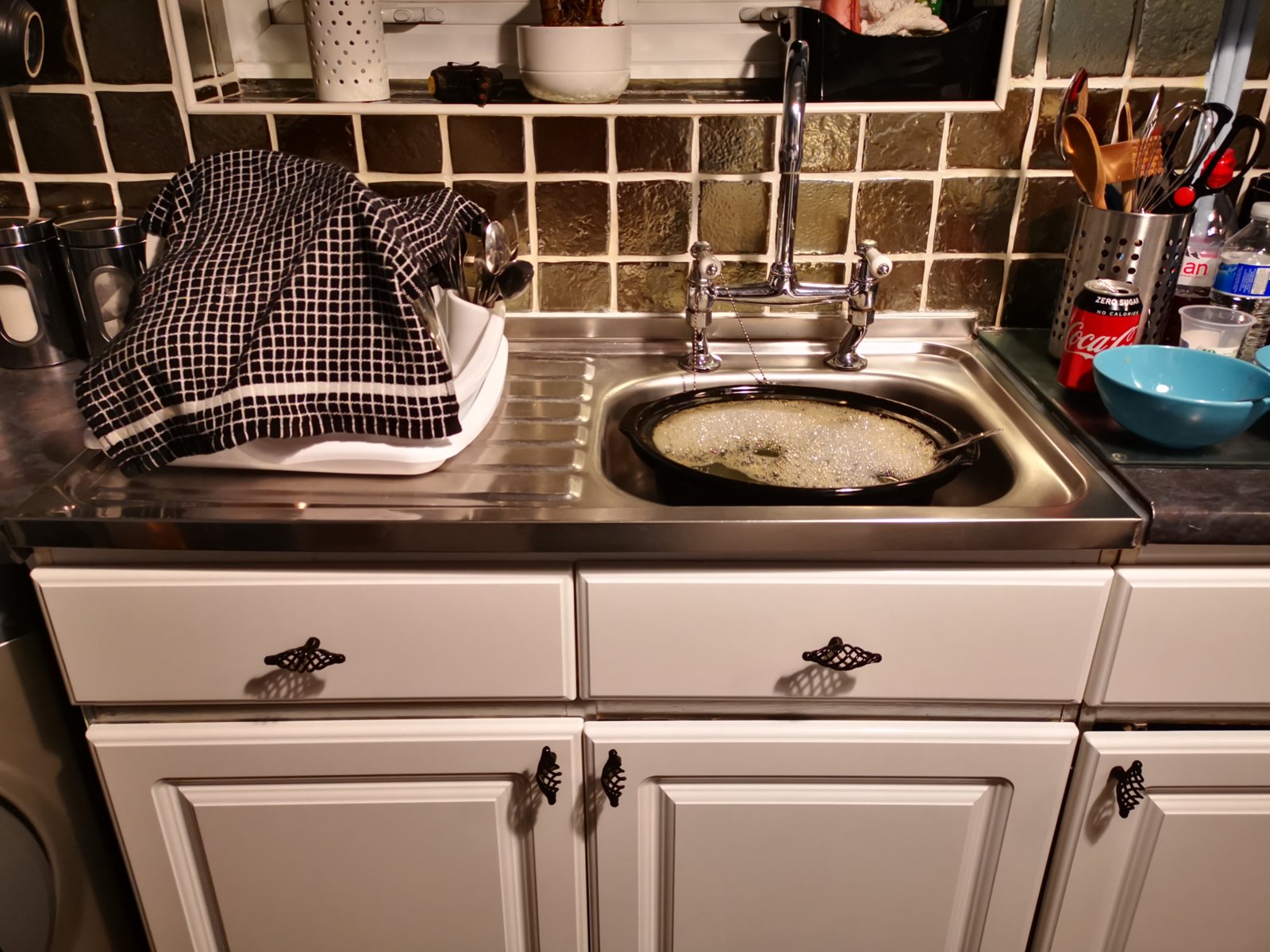

Any idea what would be the best way to replace the old sink with a new modern black sink?
https://www.plumbworld.co.uk/regino...-15-bowl-sink-with-drainer-inset-6211-1253618

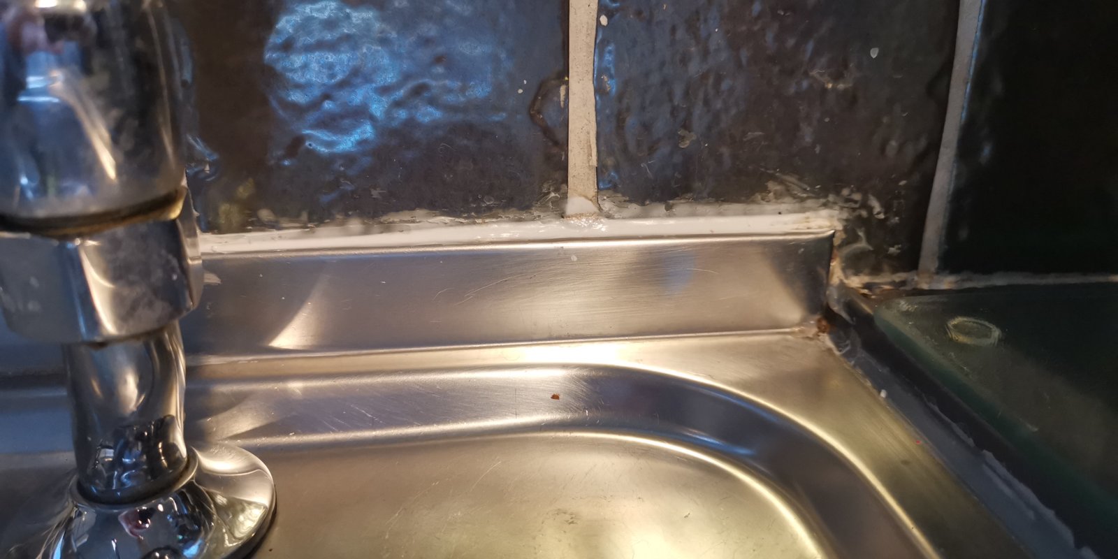

At the moment the old sink is just siliconed on at the sides and back and it looks like its just sitting on top of the kitchen units.
Could we just sit the new sink on top of the units how the old one is? Its my grandma's house and the sinks been in 30 years

It is a sit on sink a black one is bound to be one that has to be cut into a worktop. So you'd have to get a section of worktop then cut 90% of it away for the sink to sit in .

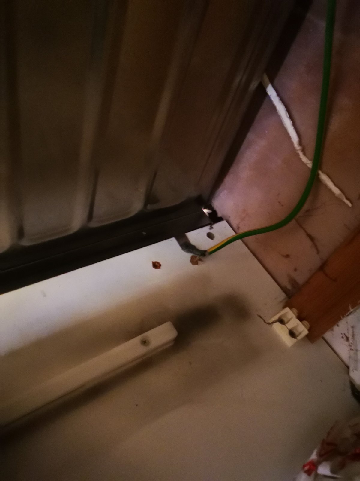

Really depends on what is under the sink, what can you see from inside the cupboard looking up, also a chance that any wood under the sink could be rotten of course so guess you will find out when the sink is removed.
Sometimes the sheds that have a cutting service have off cuts going cheap.
Yeah it looks like it sits on sink
The wood looks good still underneath the sink is just sat on top of the kitchen cabinets the back seems to be siliconed onto the wall, could we not just attach a batton onto the back wall?

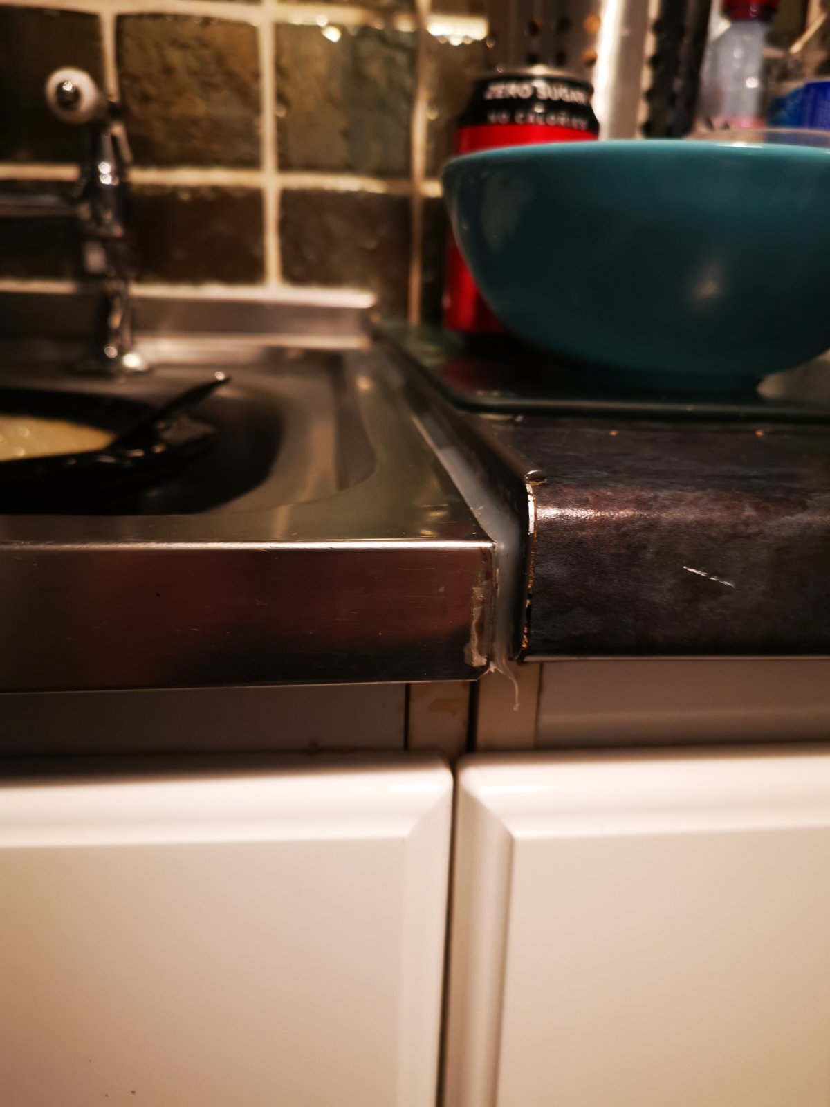

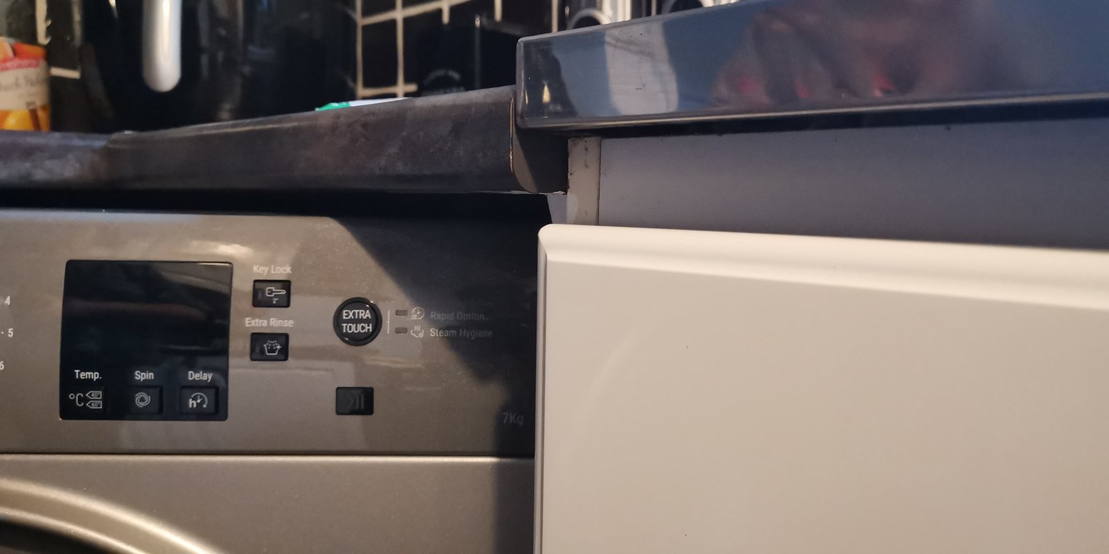

Other problem if we bought a new piece of worktop is that it isn't level. The cabinets that have been there 30 years are 470mm depth when the standard size is 570mm

Are the worktops at different heights either side of the sink, it looks that way from the pics?
Yep it's a nightmare can't rip them out as standard size units are 57cm depth which would take up to much space.
Only thing I can thing of is trimming down the tops of the cupboard units so there level both sides then getting a new worktop but I'm worried as soon as I started to trim the mdf they'd fall apart

Re the top being higher on the cupboard next to the sink, I'd guess there is only 15mm ply under the sink so an off cut of worktop under the sink might level it all up.

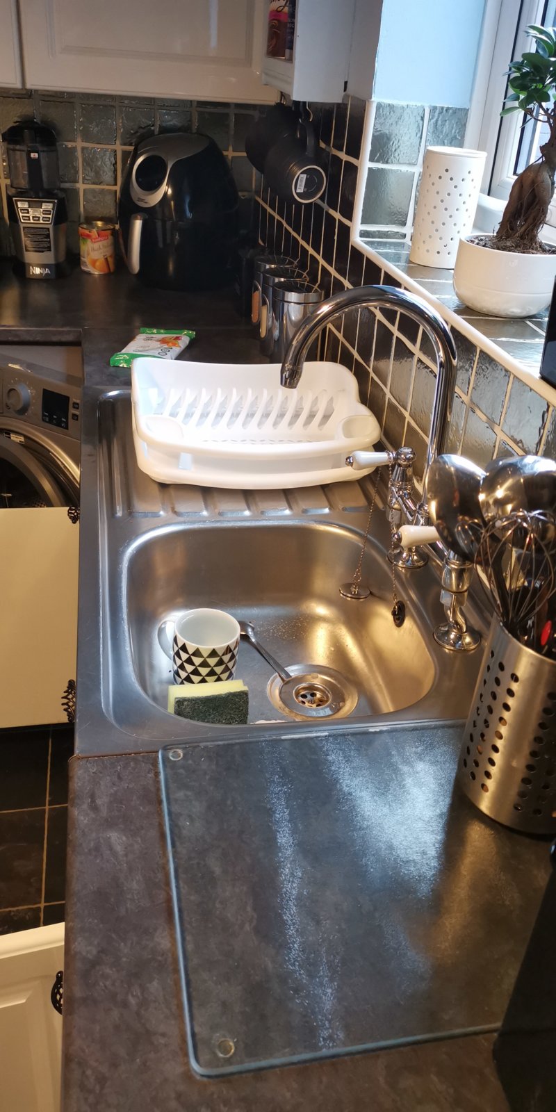

You'll need to try and find a narrow sink as well. The one you linked to is 500mm wide.
Yep it's just the one that's in now is 500mm.
Its looking like the only way is to replace the worktop and cut the cupboards down then we wouldn't be limited to a 100mm wide sink
Found my 460mm wide sink in Homeserve. Not black though as they look grubby very quickly.
